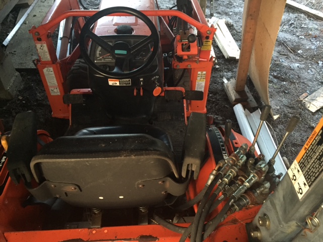

My B2710 has a 3-spool rear hydraulics valve. I would like to use the middle valve to run a grapple-like device. Hows the ergonomics of using a right hand to operate a grapple by rear hydraulics?

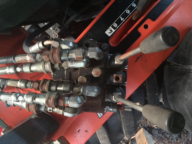

My B2710 has a 3-spool rear hydraulics valve. I would like to use the middle valve to run a grapple-like device. Hows the ergonomics of using a rear right hand to operate a grapple?

Its not ideal compared to a switch on the fel control but there are lots of folks that do it. I've got a 4 spool with one just waiting for me to plumb it to the front.

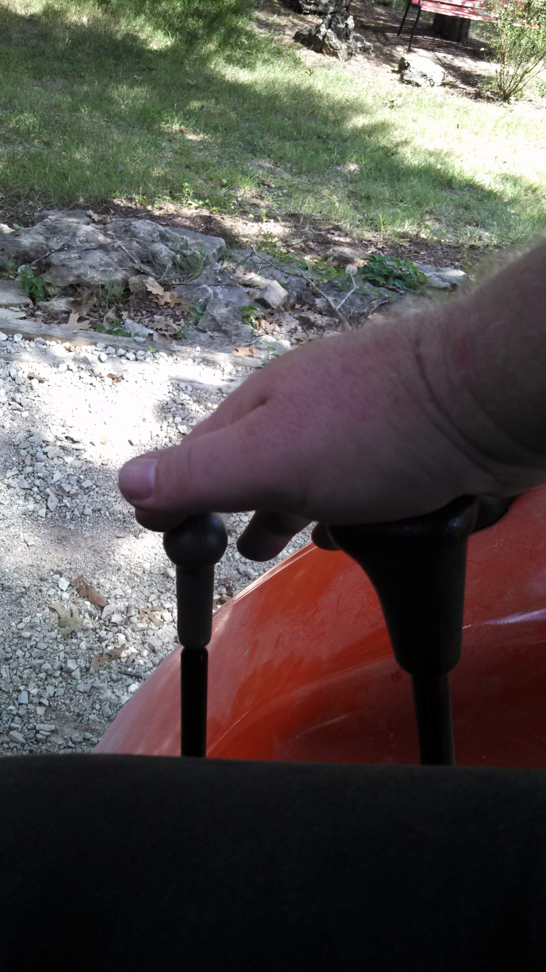

Sodo, in my opinion where your hand needs to be on the FEL control and then reaching back to operate the spool for lid control, is gonna suck. It will really slow down your operation. That is just the best way I know how to put it. I am a proponent of using rear remotes to save money on grapple installs, and that is what I use, but I can keep my palm on the joystick and operate the lid with my fingers of my right hand. I am not saying you can't do it, because you can, but it will not be a joyous operation. In my opinion.in use.jpg

Thanks james, I'm inclined to do it just to get going, and then add forward controls later if it becomes non-joyous. Most of what I need is to be able to drive into a pile of brush clamp down on it and go to the burn pile without losing half of my load.

Well, you will certainly be able to do that, just not as fast as you may like. But if you are in no gigantic hurry, then of course it will work.
