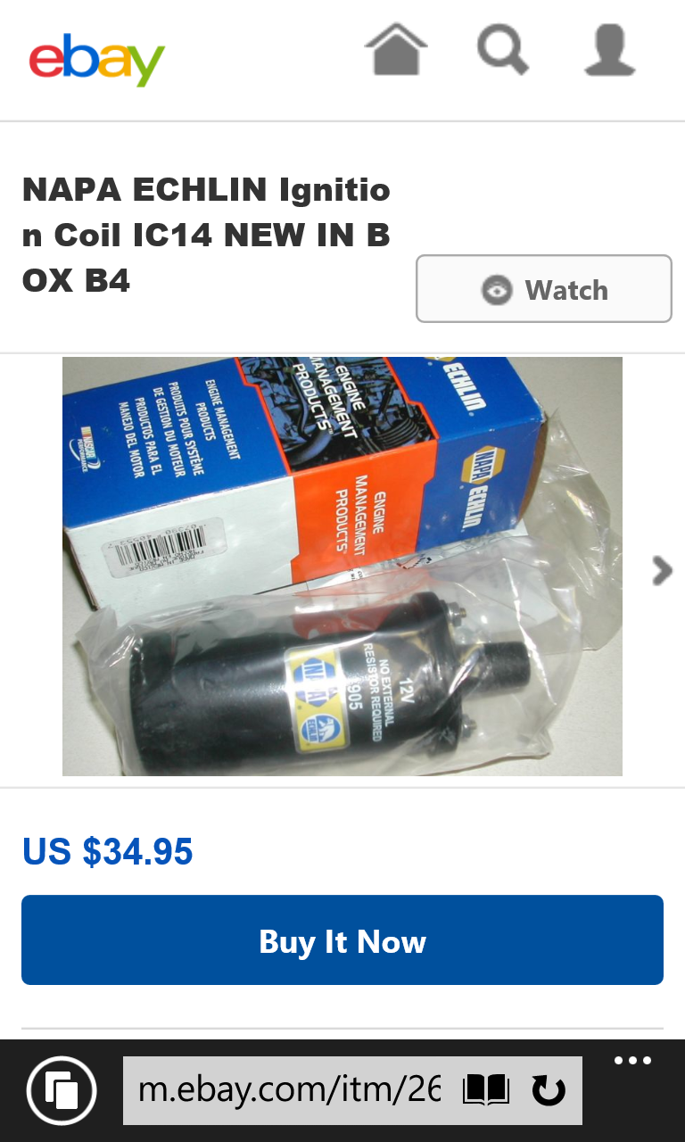

   / using up ignition points on 8N #36
Sorry, your answer is 100% incorrect, and is bad info.
Ic14sb coil run with no resistor on 12v.
Go back to school...
There are no starter bypass relay on N!!
Please don't offer advice if you have 0 knowledge of the application! :(
You know what's hilarious. I can't find specs in this magical coil because a Google search only pulls up your eight million posts on the same subject.

   / using up ignition points on 8N #39
I am responding only so I can continue to see the discussion......
:D
   / using up ignition points on 8N #40
wp_ss_20160216_0001.pngFor the " show me " people, here is a good pic of the coil from eBay.
Clearly states no resistor required.
Also, for those that haven't figured it out, ic 14 costs more, the 'sb' line is the economy line.. No yellow paint...
