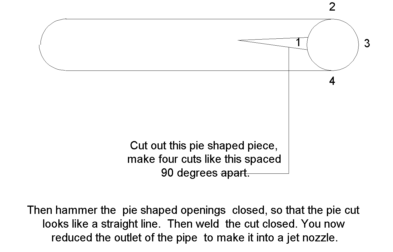

"I'm conceptually challanged on this - any chance you could draw a picture? "
I hope that the attachment works!

I forgot that on my little place in Panama ,the locals used a water pump to jet in my post for the dock/rancho /forums/images/graemlins/blush.gif I actually poured a 8' x 6"x6" steel rebar reinforced concrete posts in a wood form on dry land .I also had a tee about 2' up from the bottom . It looked like a giant concrete cross . After it cured in about 7 days ,the guys, (4 of them )set it in place in the water and using a water pump hooked up in reverse , just started working the post down into place .As the water jet blast blew the sand and muck out of the way the post went right down from its own weight . The tee acted as side stability and made the whole thing very stable .I think they had reduced the jet hose down to about 3/4 " piece of steel pipe about 10' long . I have had over 3000 pounds of cement stored on the rancho and it never settled or moved a bit !

Don't use a water jet to set your piles if you have cold winters with ice formation on the water! I know some folks in the business and some do just that. It's not necessarily a problem with bulkhead piles because you obviously don't have ice on the land side. For a piling in open water where ice can form all around the pile, you may have a problem if the water level rises or falls when the ice is heavy. The ice will grip the pile and gradually jack it out of the bottom. Depending on how thick the ice is and the friction on the pile you'll see piles in the same vicinity get jacked up different amounts.
If you're in an area where you get thick ice in the winter with fluctuating water levels always drive the piles. You get better bearing capacity on the piles and more friction to resist uplift forces. I've seen docks on the Jersey shore which were really messed up after a hard winter. Those were the ones where the builder used a high pressure pump and a long pipe to jet them in. Typically the builder uses an excavator to move the pile into place while a laborer runs the jet. the operator will tap the pile a few times after it has settled as far as it can from the jetting.
The ones that didn't come out were driven in by a pile driver.
As for a pump to use if you live in a milder climate, the volume of discharge is not what's important. You need more pressure than a so-called trash pump will produce. I'd look at 2" fire pumps. You want something that will throw water quite a distance. You may be able to rent one.
