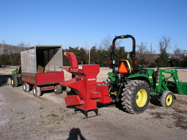

It is a bear. I try to avoid it whenever possible. I went with the wagon style because I thought I might occasionally be filling the wagon with the tractor I was pulling it with. If I had it to do over, I think I would get the tandem axle model and a nice jack for the tongue.
Mine has received a semi-permanent modification. I use it to catch the chips from my chipper. I put a solid front and top and window screen sides on it. My little 455 can dump it at about 75% capacity -- which is more work than I care to do at one time anymore. The day I chipped that much, I could hardly move for a week.
As I was designing and building the sides, I had intentions of being able to remove the screen rig from the trailer. I could do it, but it wouldn't be as easy or quick as I wanted it to be. Is that reason enough to get another one? ;)
