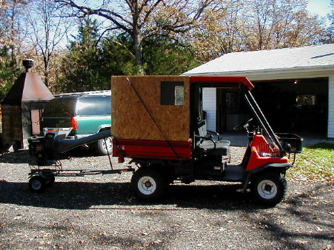

The last thing we did with my brother's Mule was make a miniature Asplundh rig with it as shown in the attachment. /forums/images/graemlins/laugh.gif
