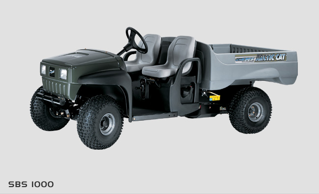

Arctic cat also makes one
Engine Displacement/Type
480cc, Air-Cooled, 4-Stroke Twin
Lubrication:
Full Pressure
Starting System:
Key Start, electric
Drivetrain:
Constant Variable Automatic Transmission
Speed:
0 - 16 mph (0-26 km/h)
Brakes:
Mechanical Rear Drum with Metallic Pads
Suspension Travel:
Front: 5 in. (12.7cm)
Rear: 26 in. (66cm) Rotational Travel
Tires:
22.5 in. (57.2 cm)
Box Volume:
14.75 cu. ft. (.43 m3)
Bed Capacity*:
1,000 lbs. (454 kg)
Total Load Capacity*:
1,400 lbs. (635 kg)
Towing Capacity*:
800 lbs. (363 kg)
Overall Length:
115 in. (292 cm)
Turning Radius:
9 ft. (2.74 m)
Overall Width:
59 in. (150 cm)
Wheelbase:
79 in. (201 cm)
Ground Clearance:
5 in. (12.7 cm) Rear, 9 in. (22.9 cm) Under Footwell
Fuel Capacity:
7 gallons (26.5 litres)
Weight:
1,000 lbs. (454 kg)
Standard Features:
Headlights, DC Outlet, Fuel Gauge, Temperature Warning Light, Hour Meter, Parking Brake, Cup Holder, Cell Phone Holder, Glove Box, Underseat Storage
