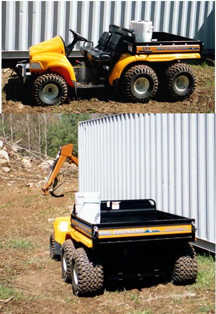

I took a look at most of the comparable 4x6's before deciding on the Cub Cadet Big Country. It is 20 HP V twin Honda powered. Has 6 wheel independent suspension and an 1100 # payload with electric lift. There is a differential lock lever. I have pulled a 3000# boat up a hill with no problems. You can learn more about it at http://www.cubcadet.com.I use mine to move materials/ tools around plus joy ride. The ride is very quiet and smooth, and I have yet to get it stuck, even in the swamp.Andy
