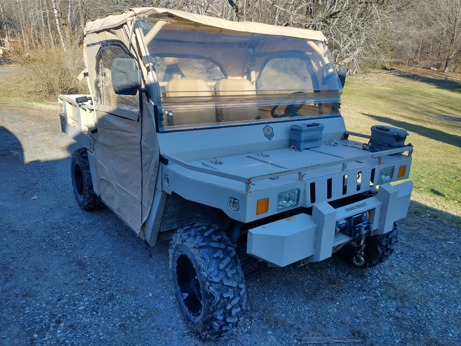

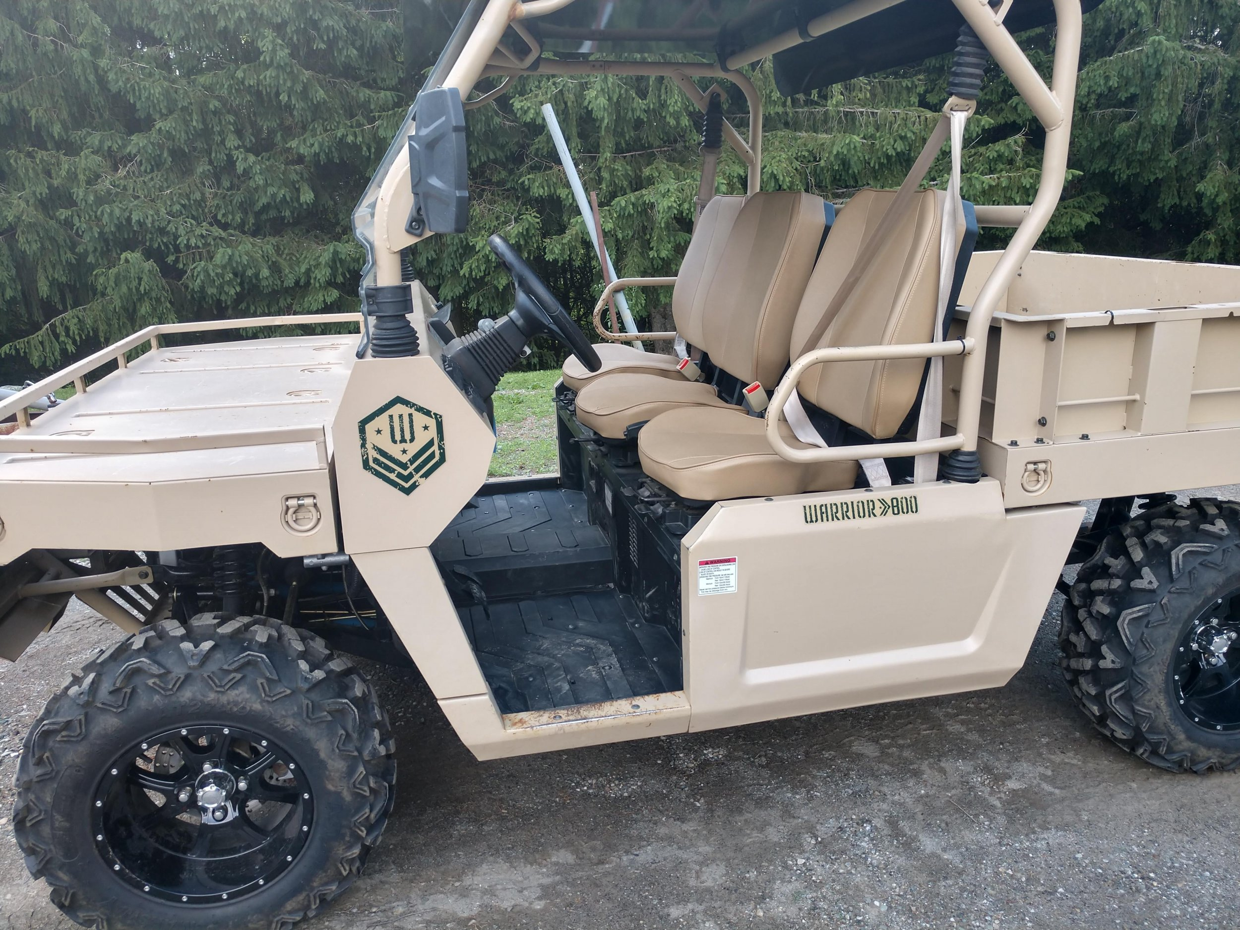

My UTV,
with the soft cab on her,
inside the cab,

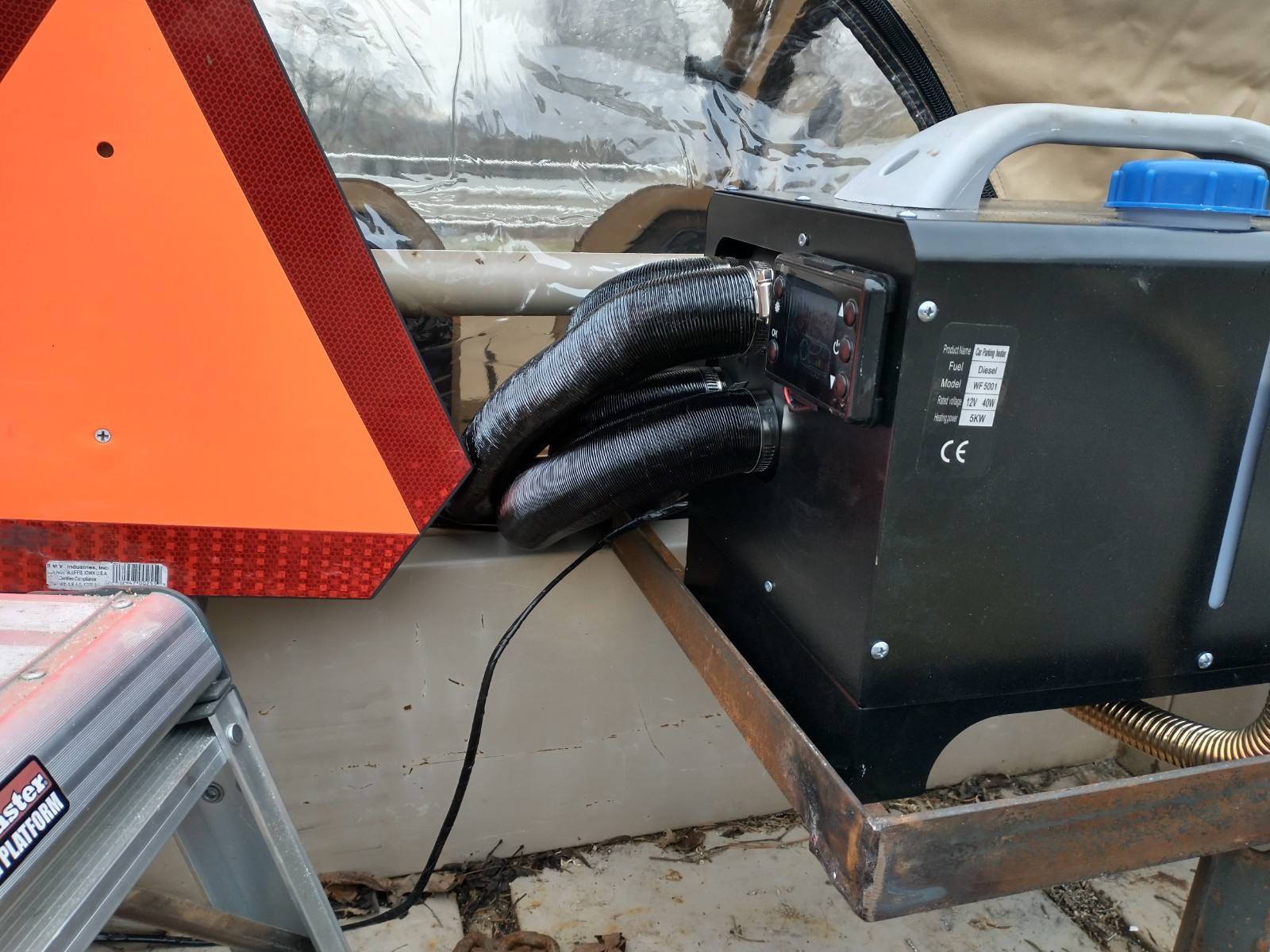

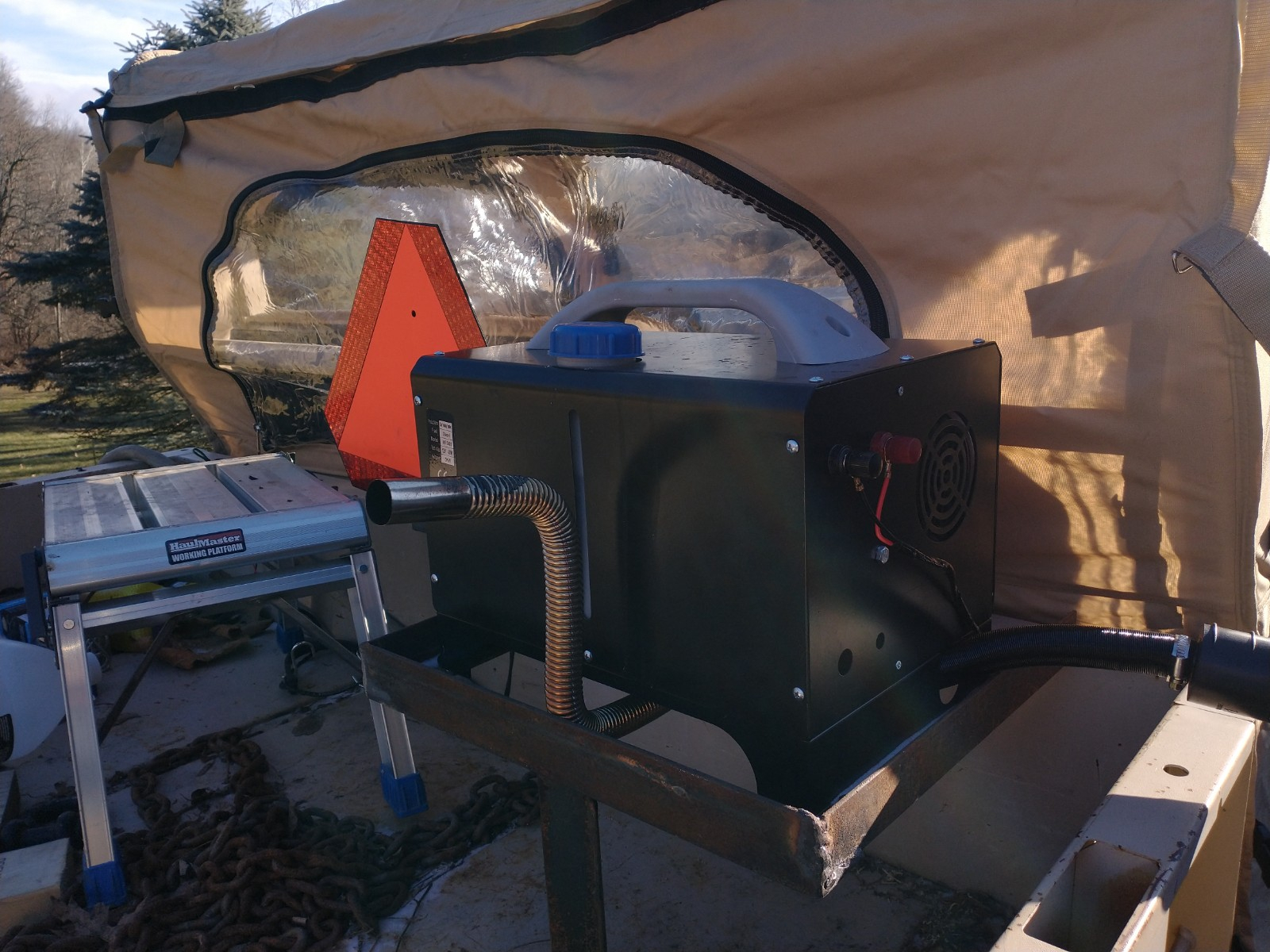

The heater, from outside,
the outside ducts bring the heated air in,

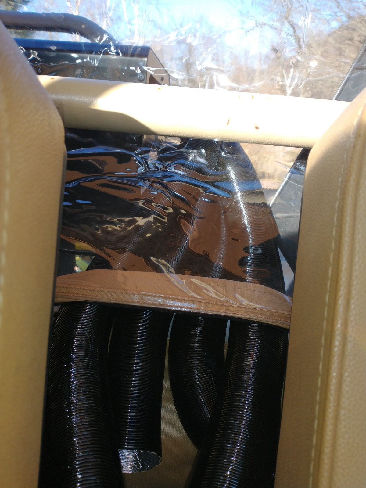

and the ducts in the cab, I have longer ducts ordered to get better heat distribution, they just reach inside now between the middle and passenger seats,

The only issue I see for your application is the enclosures of these things are made out of super cheap lightweight materials. I don't see it lasting very long on the back of a UTV bouncing down bumpy, dusty, muddy roads. Is there any dry storage areas on that machine? IF so I would install it there without the cheap enclosure. Just my opinion, I hope I am wrong and it works well for you.
   / UTV heater
I'm wondering how well it will hold up also. It is well secured, so I guess it's a wait and see issue.
No good dry storage areas to mount it in. It will not see much dust in the winter up here, it will be interesting to see
how it holds up in snow and freezing rain.
It can easily be removed with two bolts and an electrical disconnect for summer time as will the enclosure.
