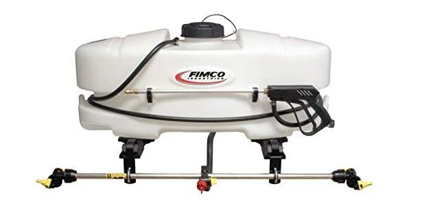

I'm not one to re-invent the wheel so I'd like to ask your recommendations on a brand of sprayer for my Kubota RTX-1140 side by side. I will be doing food plots for wildlife management...probably less than 1/2 acre per plot...I'm believing that a 25 gallon spray rig will be sufficient to do 3-4 food plots. I've looked at various brands and want to make the best decision for a $3-400 purchase. I've looked at boom and boomless and am leaning toward the boomless but I'm not bound on that as I have no experience with either.
I've researched FIMCO; Ironworks: North Star; all those that come up on Amazon or Tractor Supply....of course I want one with hand sprayer as well....I'm guessing I will only spray 2 gpm range....one FIMCO I looked at has a 4 gpm pump which I'm guessing I just adjust the pressure to 20-30 and let it backflow into the tank and it should be about 2 gpm....but I don't want to be hurting the pump etc....So any suggestions based on your experience is appreciated....I plan on just letting down the tailgate, strapping it in and using the UTV to do my spraying....easier than hooking something to my Kubota tractor....thanks for any feedback.

My experience:
My need list was the same as yours.
I initially went with a Fimco 25gallon boomless spayer from FarmFleet, around $500.
I was able to go through 3 tanks full. Half way through the 4th it lost pressure. The screws holding the halves of the pump together had come loose. I can deal with a minor maintenance issue, but tightening the screws became progressively less effective. The pump is made up of plastic parts, and the course threads of the screws no longer held. The solution was to tighten every minute or so, at least until the tank emptied. Then the valve manifold broke loose and sprayed 2gal/min everywhere. No fix for that. The manifold is integral with the pump, and neither would stay connected to the other. And a spray nozzle broke off (that was my fault). Anyway, enough picking on Fimco.
So I researched other sprayers, returned the other, and finally settled on:
Two weeks after I ordered the Agspray, I received an email from Fimco that my sprayer had shipped. @#$%#@#$#@. I did not want a $#@ Fimco. Ends up Agspray is a agricultural branch of Fimco. My conclusion - get an Agspray sprayer. Everything about it is serviceable and high quality.
Pump - shurflo, metal housing, machine screws vs plastic housing and course screws made for plastic.
Filter - serviceable transparent enclosure up top, visible, and easy remove and clean, vs underneath, out of sight and difficult to service.
Manifold - threaded pipe fittings that allow the unit to be removed, cleaned, replaced if needed, vs a one pc moulding integral with the pump housing.
Boomless nozzles - it has none. I intend on sourcing my own high quality nozzles (hamilton #5) and plumbing them myself. Final cost for sprayer and nozzle assembly will end up about the same as the first sprayer
Pressure gauge - fluid filled, brass and stainless, high quality, vs mechanical, steel, and flimsy (cheap).
On the second season with the Agspray and so far it's held up nicely.

Bought a 30-gallon fimco from TSC for my RTV900. It only came with the wand and 10' of hose or so but for small stuff, I use it to drive around and get driveway/landscaping weeds etc. The first thing I did was put some plumbers putty around all the screw-on (bypass/wand/etc.) connections and it sealed up great and has run well for 6 years. I only had to replace a rubber connector between the tank and motor < $5.
For the plots, I went on amazon and bought a "boom" kit that covers about 7 feet or the width plus a foot on either side of the RTV. I made a mount ouf of 2x6 that slides over the tailgate. I throw it on, throw the tank in, and put a ratchet strap around them to secure it and spray away. I also made an extension for the on off switch on magnets so I can run it to the cabin of the RTV easier. https://www.amazon.com/gp/product/B00HY7NNNS/ref=ppx_yo_dt_b_search_asin_title?ie=UTF8&psc=1 The kit was like $20 bucks and you could easily make one yourself, but this was a quick jump start and got me out spraying.

I bought a ā€˜deluxe’ 25 gallon Fimco from TSC last year for just under $200. Wand only and I have the unit on a 3pt platform behind the tractor. I shoot from the tractor seat onto fence rows and along wood lines/fire breaks. I ran several full tanks of herbicide through it last year with no issues though I quickly learned not to use a commercial surfactant as it clogged the strainer really fast. Perhaps my well water?
I had one small bracket break and called FIMCO who quickly shipped a replacement part. Very good US customer service experience.

I have a Fimco 15gallon ATV sprayer,about 12 years.Replaced the boomless part of it with a six ft.boom,the pump once.Works well for a couple day a year tool.
Make sure to rinse after use,and wear personal protection.
