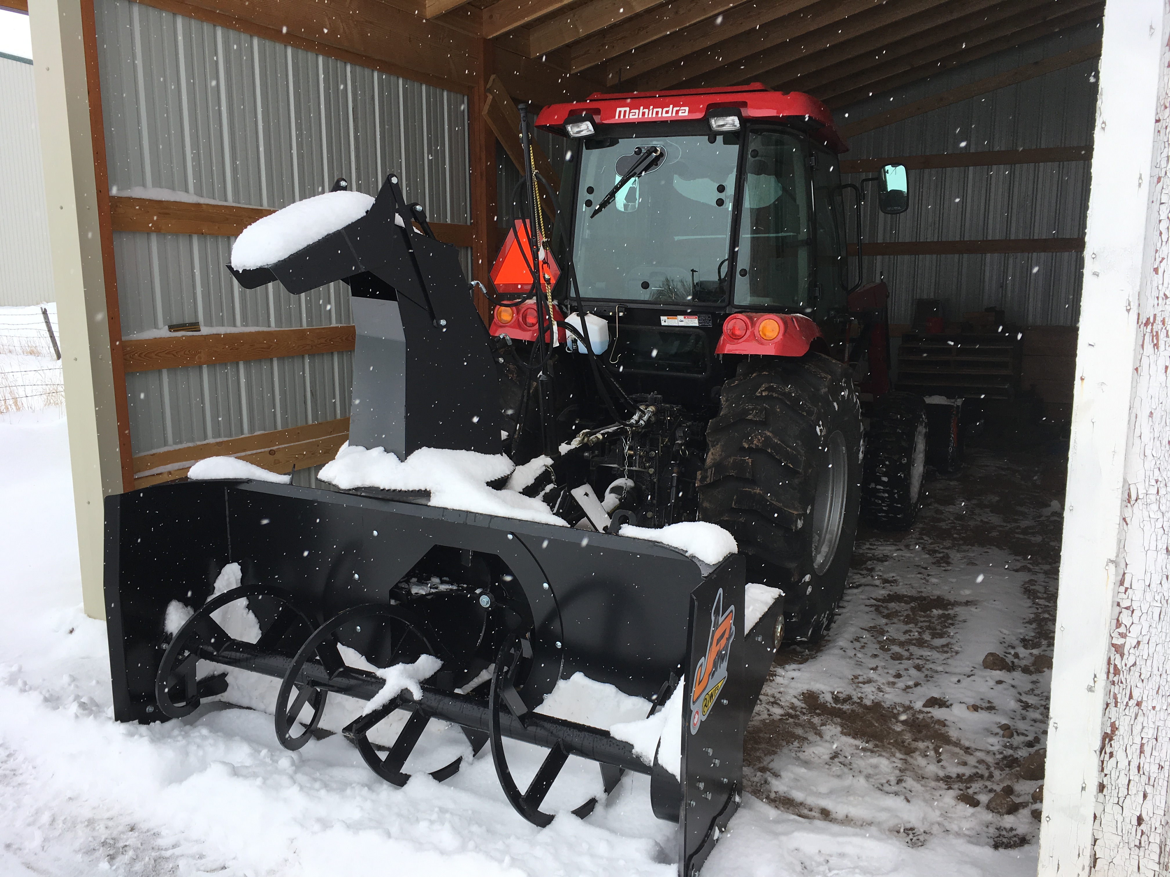

I presently have a straight blade on my side by side and have been plowing with that for several years. Want to upgrade to a v plow because it will cut my plowing time down. We have about 1500 feet of driveway with an incline plus plowing around our barn. I've always struggled a little with traction on the side by side even with chains on the rear tires and weight in the bed and figured the tractor would have less of an issue. I have chains for my tractor too. If I get one for my tractor it would have to be a FEL mount because Mahindra doesn't make a v-plow that attaches to the snowblower mount (which I already have and use once winter gets into full swing).
I have a Mahindra 2538 HST Cab and the side by side has a cab and heat too so that's a wash.

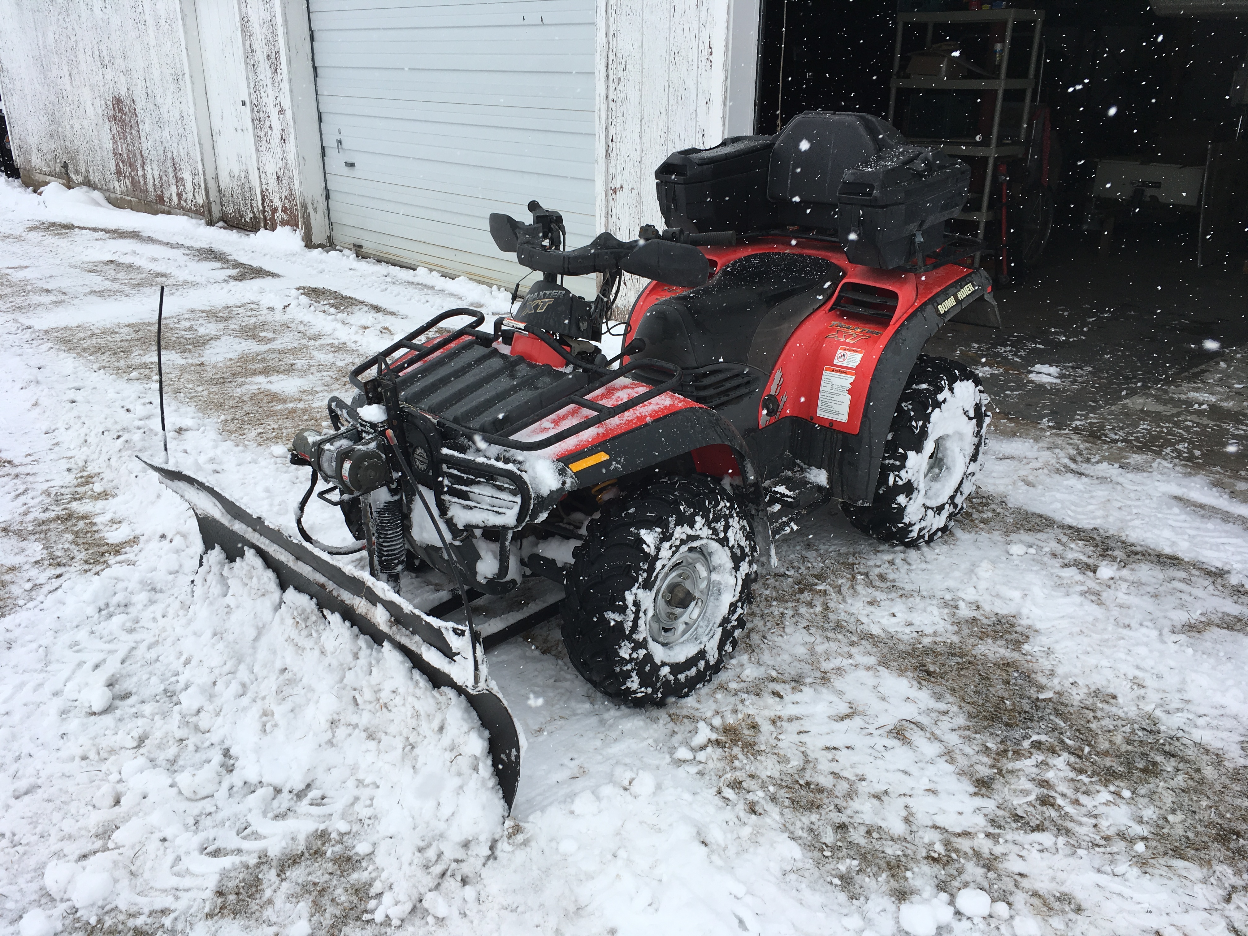

I use an ATV with a 60" straight blade and a tractor with a FEL and snowblower. The ATV is used in the fall until the ground is frozen. After that I use the tractor for all major areas and the ATV for sidewalks and such and for light snow storms.

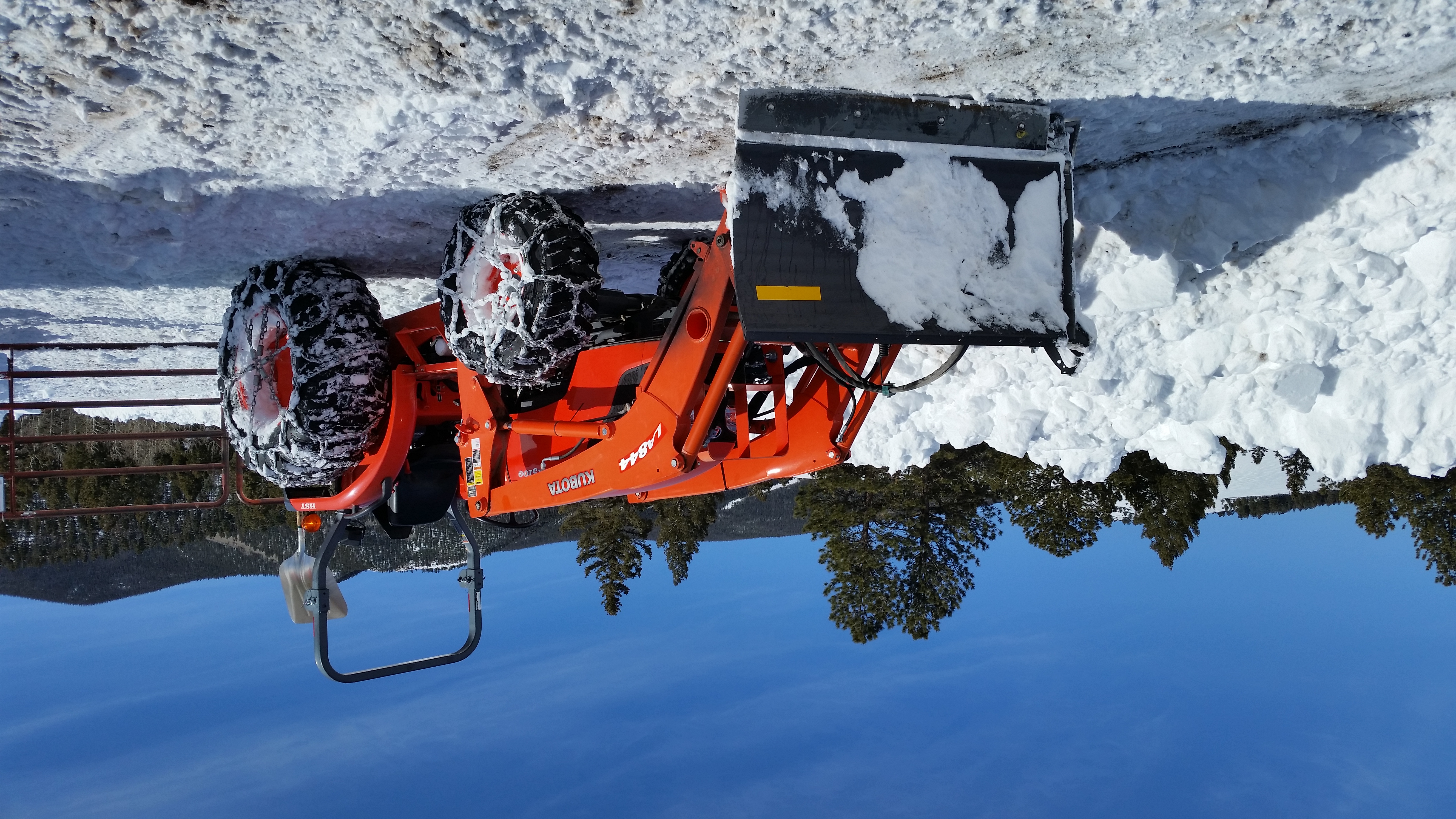

We have a Gator (620i) with a manual angle V-plow, and an 8 ft v-plow for the Kubota. Even with the manual angle, the Gator is fast for plowing light snows, and early in the season it does not tear up driveways when they are still unfrozen. BUT, when the snow gets deep or heavy, it doesn't have near enough weight to handle it even with 500 lbs extra weight in the bed. Also we have a lot of rock, and the light UTV blades get bent and banged up pretty easily. Try buying replacement parts from John Deere to rebuild your blade assembly -- it will bust your budget in a hurry. So we like the Gator, but if we had to give up one tool for snow plowing we'd definitely give up the UTV and stick with the tractor. 20160416_145209.jpg20150305_145317.jpg

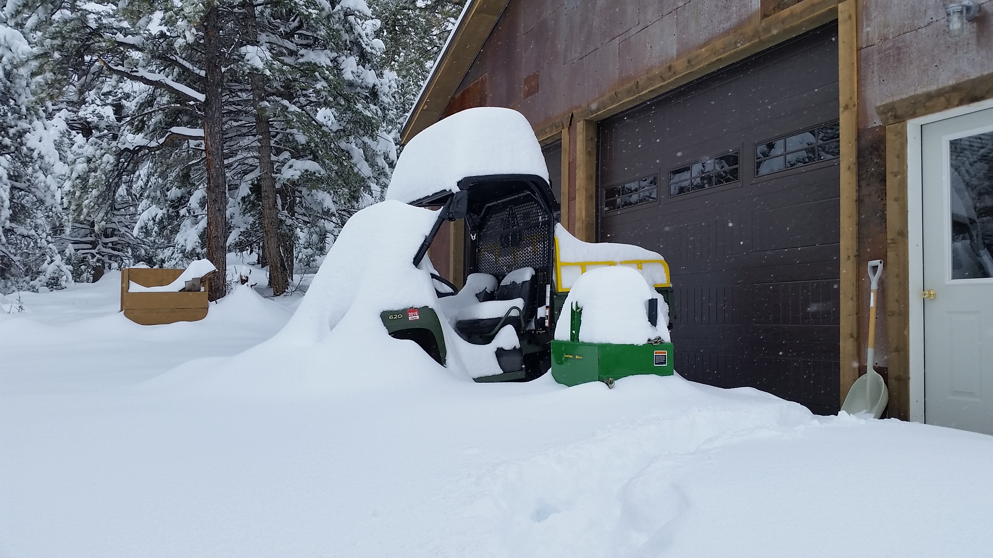

Is that a JD hydraulic power pack I see sticking out of the 2017-18 Colorado snow?

Hi Leon- We're good here now, no smoke and wet enough so that we can have campfires. That JD box is a weight box, but I wish it were a power pack. I bought a wood chipper from a guy and saw that sitting in his shop, unused, nothing in it. He said it was too small for his tractor and he'd sell it to me for $200 so I took it. Filled with concrete is still a bit too light for the L5740 but I can put the backhoe on if I need more ballast. (My rear tires are loaded.)

We have a Gator (620i) with a manual angle V-plow, and an 8 ft v-plow for the Kubota. Even with the manual angle, the Gator is fast for plowing light snows, and early in the season it does not tear up driveways when they are still unfrozen. BUT, when the snow gets deep or heavy, it doesn't have near enough weight to handle it even with 500 lbs extra weight in the bed. Also we have a lot of rock, and the light UTV blades get bent and banged up pretty easily. Try buying replacement parts from John Deere to rebuild your blade assembly -- it will bust your budget in a hurry. So we like the Gator, but if we had to give up one tool for snow plowing we'd definitely give up the UTV and stick with the tractor. View attachment 572155View attachment 572156
Do you feel like the v-plow for the FEL is too much for the tractor? Do you have to run some sort of counter weight?
That V-plow is heavy, close to 1100 lbs. Its ok but close to being too heavy for me. The bigger issue is learning to use an FEL mounted plow on dirt or gravel, it took me half a season to get good with it. I always have something on the back when the plow is on, either a ballast box, backhoe, or 3 pt. snow blower. The ballast box is the same weight of the blower at around 750 lbs, but the blower weight is quite a bit further back and it feels better with the blower back there. The thing about V-plows is that they are so versatile. I use scoop mode way more than I expected to when I purchased the plow.
