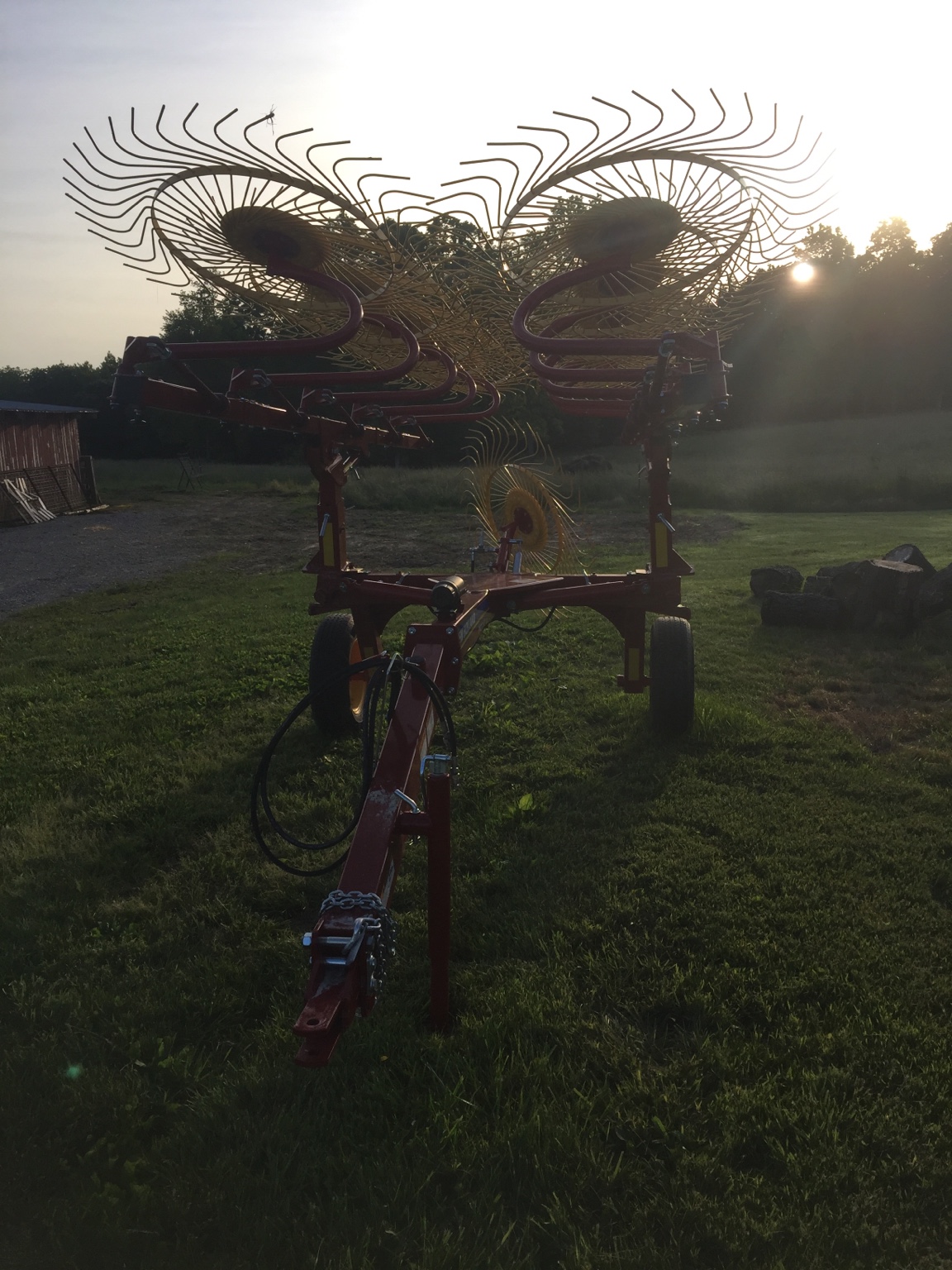

Thought I'd give a quick update. Ended up getting neither of my original choices. Just pulled a New Holland Procart 1022 home today. It's dark and rainy so pictures will have to wait till later.

Finally remembered the pictures. ImageUploadedByTractorByNet1464047764.952251.jpgImageUploadedByTractorByNet1464047785.244469.jpg
   / V-Rakes. Vermeer or Kuhn? #20
Finally remembered the pictures. <img src="http://www.tractorbynet.com/forums/attachment.php?attachmentid=469636"/><img src="http://www.tractorbynet.com/forums/attachment.php?attachmentid=469637"/>
Looks good. Now it's time to make some hay. Enjoy.
