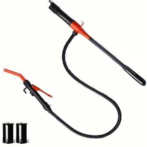

I used a electric boat fuel pump with flex hose and length of copper tubing on both gas and diesel…
Both times it sucked up a lot of crud and I was able to reach the sump and tank corners.

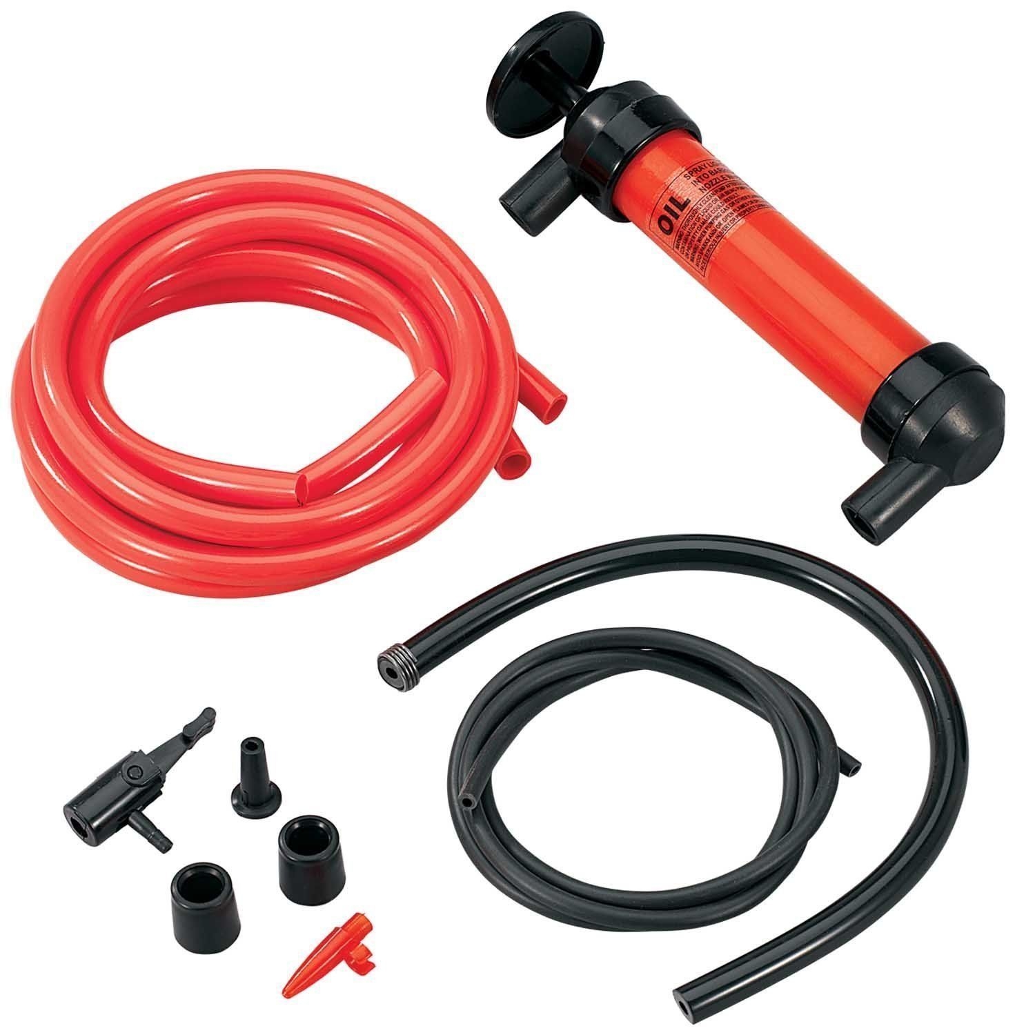

I have a hand pump/siphon that works well for emptying a gas tank. It took me about 15 minutes to empty the 10G gas tank on my old tractor.

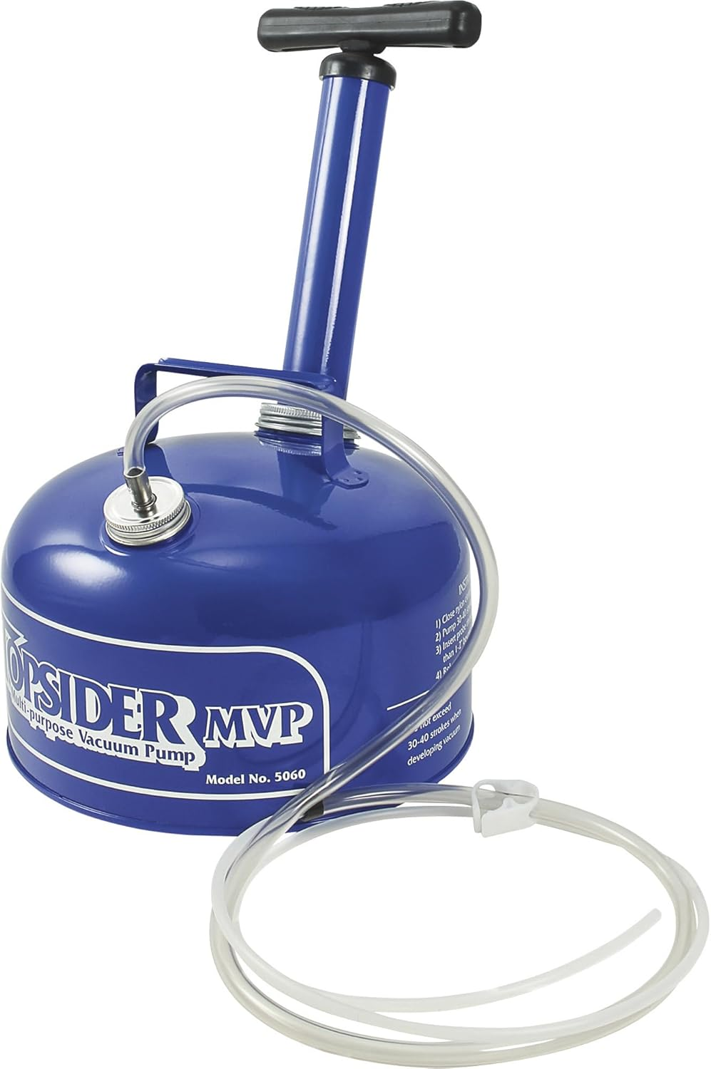

I use this topside oil changer with piece of 3/8" tubing for jobs like this:
https://www.amazon.com/America-5060...mzn1.fos.9fe8cbfa-bf43-43d1-a707-3f4e65a4b666
Easily sucks out the gunk. It's also useful for getting gas out of a vehicle for use in lawn mowers and generators.
There's also a cheaper hand held version:
https://www.amazon.com/Wenzhon-Diff...658&sprefix=top+side+oil,aps,151&sr=8-36&th=1
