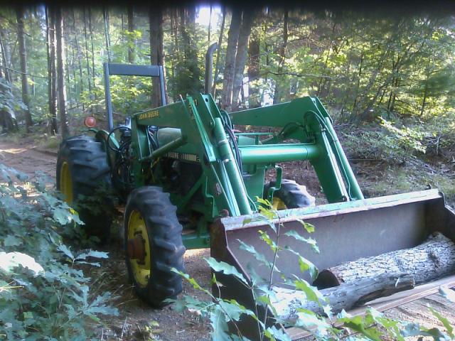

Here's a recent pic:
   / Value and History of Deere 2155 #12
The tractor looks well cared for (from the pictures posted) considering the hours. One good thing about this tractor compared to a new 4000 series and smaller is it is a wet sleeved motor. Meaning you can rebuild the motor like new with replaceable cylinder liners and pistons. That is one thing I don't like about my new 4520 and 110tlb much more likely to have to change out the block if it fails, which is more money. Deere starts the wet sleeved motors today with the 5000 series and up. Worth mentioning to your mechanic friend. I think this tractor is definately worth considering but none of us here can tell y0u much from a distance.

I've been looking for a baler/utility tractor for quite a spell... And, $12.5K for a real straight, well maintained 4x4 2155 with loader is a pretty good deal - IMO.
Hours are gettin' up there but your mechanic buddy should be able to give you a good appraisal of the the compression, blow-by condition of the engine.
I'd pay close attention to the clutch and brakes, too. Find out if they've been replaced. Hydraulic pump wear would be something to have your mechanic look at as well. Pressure check is pretty straightforward.
The previous owner/owner's appear to have used the tractor - but not ABUSED it. For the use that you have in mind; that machine would likely work for many years without a hitch.
