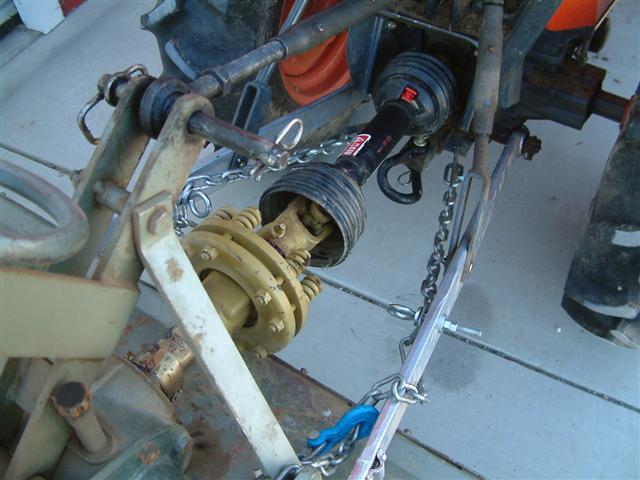

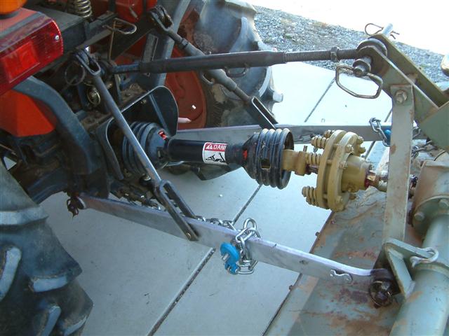

I added a slip clutch to my Yanmar RS1200 rototiller without much problem.
Had to make a few modifications to get it onto my 2005 Kubota B7510HST.
The lower lift arms on the 7510 were too short (25 in long) so I had to use the 35 inch arms from my 1964 MF135 diesel.
I bought the shortest pto shaft I could find at Tractor Supply and had to cut off an additional 2 inches.
I had to use a pto shaft extension on the rototiller to move the slip clutch away from the sheet metal on top of the tiller.
You may be able to do something similar for your flail mower.
