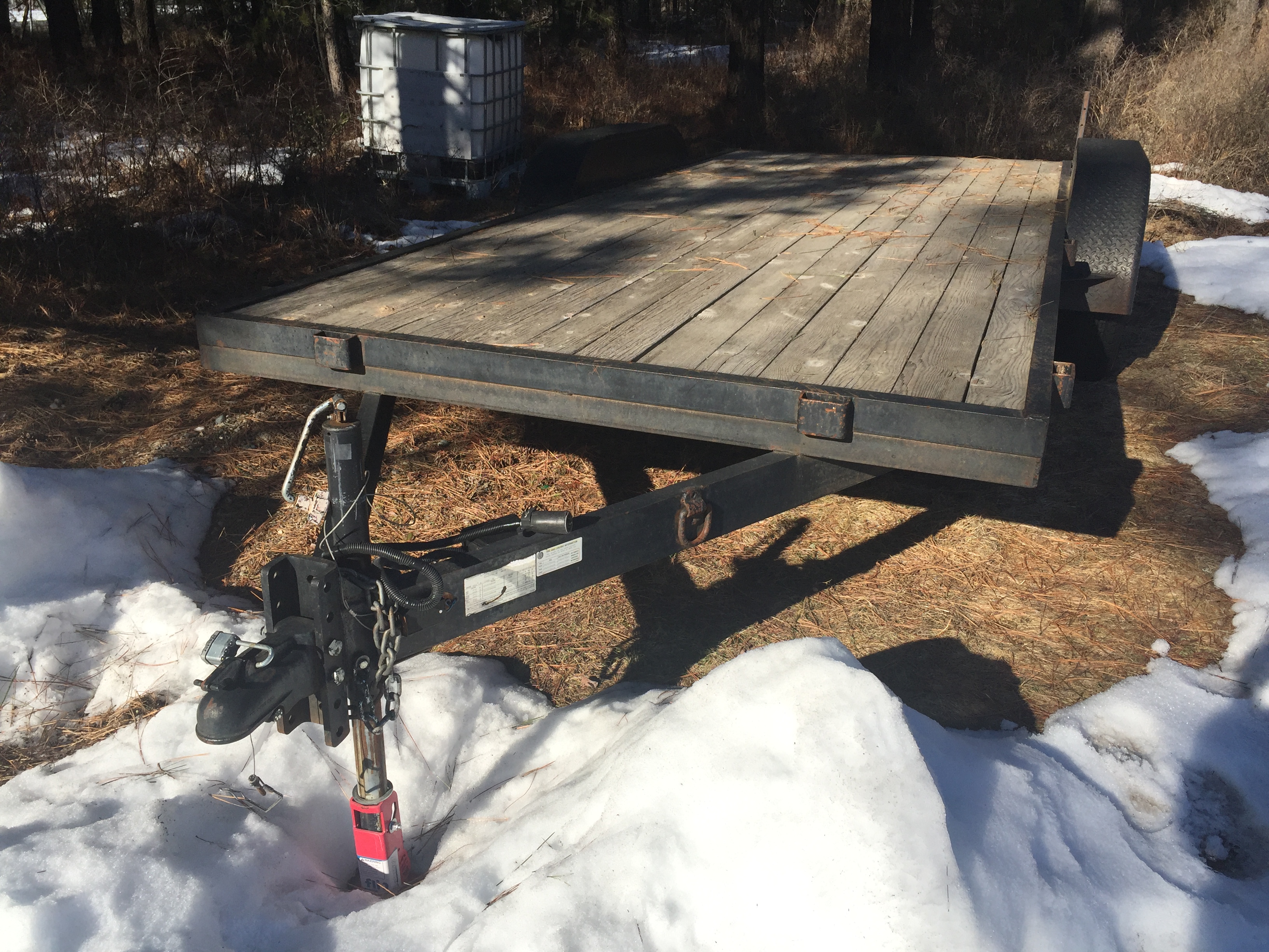

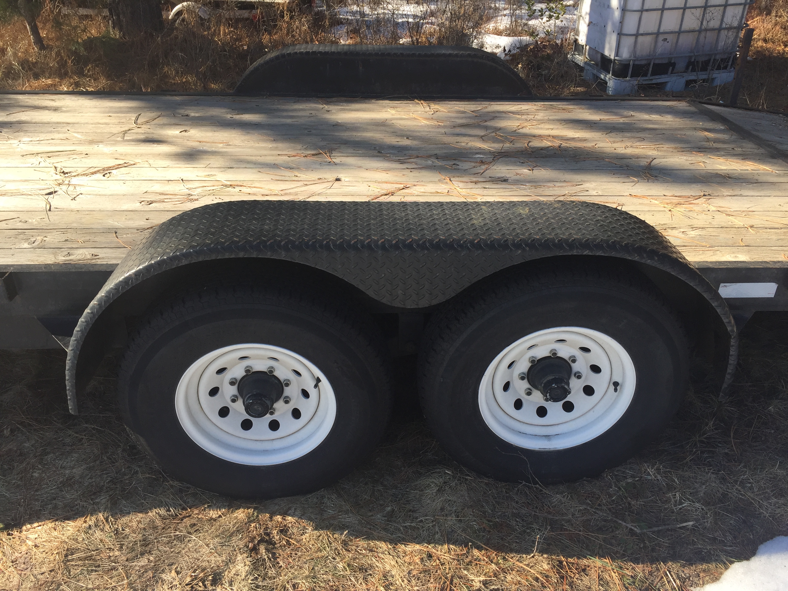

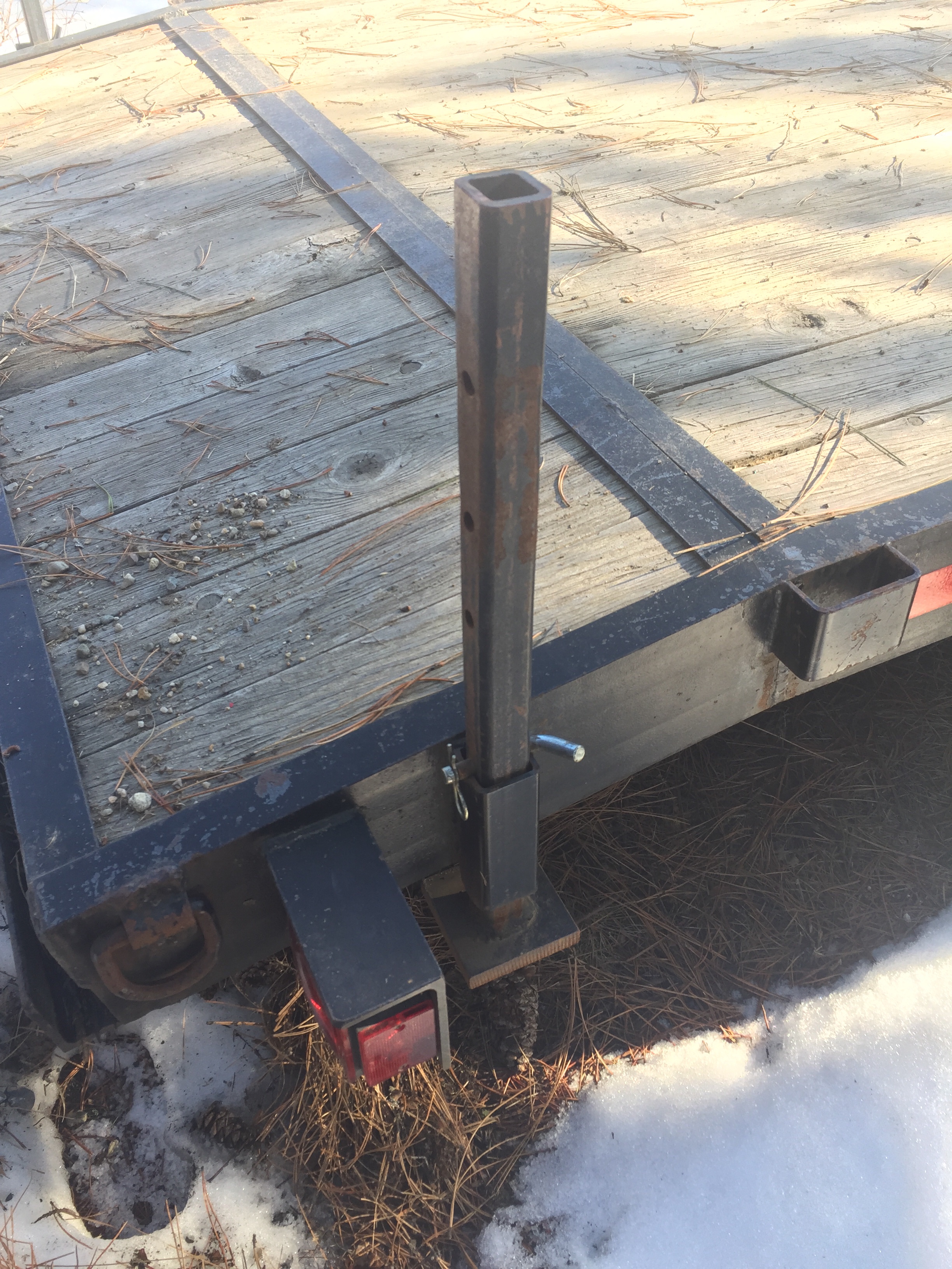

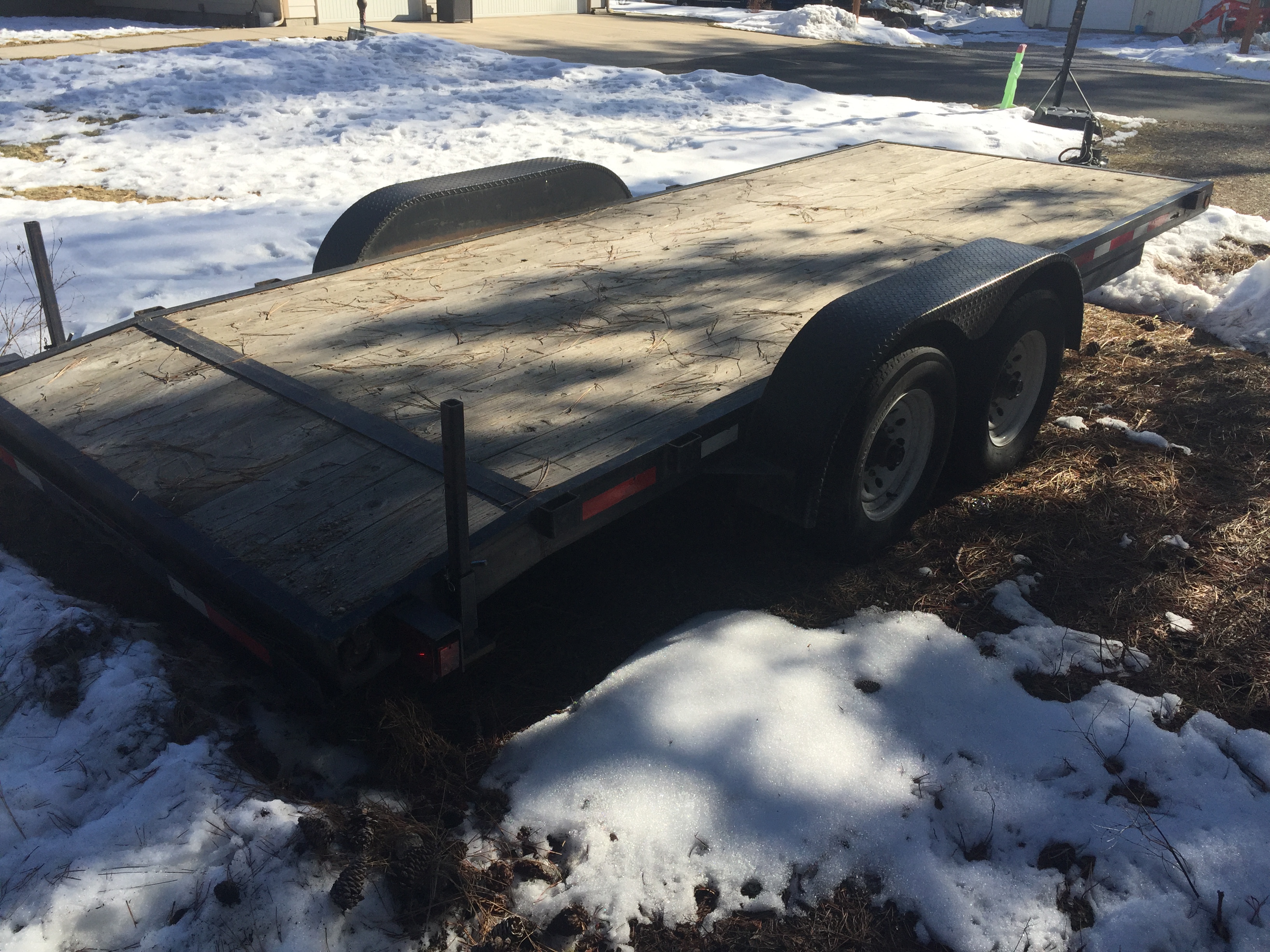

Got the pics. I didn’t make it clear earlier that this is my trailer.
The tires are from 2007 :-( I bought it 4 years ago locally to transport my tractor around and various stuff. I do know that before I bought it, I drove the trailer on one set of blocks to check for wheel play and spin and all 4 were solid & spun very smooth for quite a while. Brakes are on both axles and I can lock them up with the variable controller at full stop. I probably put 400 miles on it since then. It mostly sat on the RV pad that’s shaded with trees in the south so the sun really haven’t shined on the tires.
Lights were upgraded to LED’s. Oh and yes, it’s a 2 5/16” ball hitch. My mistake.
Just considering selling it because it doesn’t get much use.

12k isn稚 really de rated. It痴 a pretty realist load for 14k trailer.
The 12K isn't the load rating, it's the total weight of all cargo AND the trailer itself. Yes, a 14K GVWR trailer might have a payload capacity around 12K (usually a bit less).
In the pics he posted, it isn't de-rated, it's got tandem 6K axles on a 12K GVWR trailer, not the 7K axles he initially posted. Every flatbed equipment trailer you buy, today, will have a GVWR the sum of the axles combined, or more (to allow for some tongue weight), unless it has been de-rated. A 12K GVWR on a trailer with 14K of axles would be de-rated, usually so people can pull them commercially with 14K trucks and stay under 26K, which is where CDL is required. Some people order de-rated trucks, to accomplish the same thing with trailers they already have or want to keep the full rating on.
