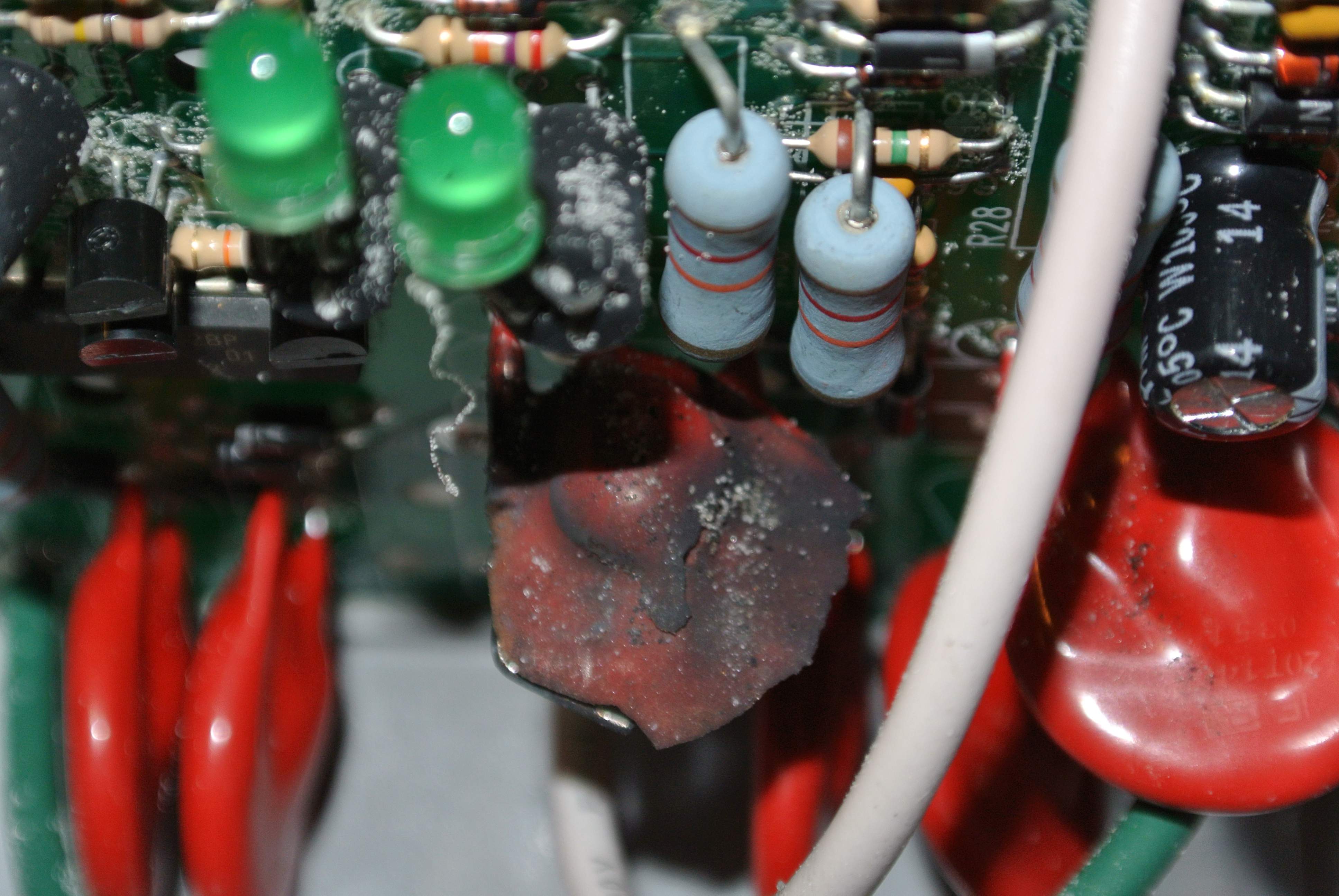

I finally got home from a business trip and first thing on my list was replacing the whole house surge protector. The original model died during the surge but protected the house was Intermatic Panel Guard IGI 240RC.
Intermatic IG1240RC Intermatic, 3W Panel Surge Arrestor - Crescent Electric Supply Company
Thanks
You do know that many of the whole home protectors sacrifice themselves in the event of a surge, and therefore are a one time use only item. Some manufacturers do offer a free replacement unit for one destroyed when protecting the home.
Id consider the Intermatic a "good" unit, it did its job. Is there a particular reason you are looking at the Siemens? From what Ive seen so far it appears to be significantly more expensive than that intermatic.

I bought Siemens because it came as one of the best when searched for replacement. After I removed the damaged surge arrester I took it appart and looked inside. One of the varistors was burned.
