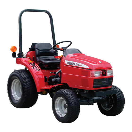

Anyone know the valve adjustment on a 2415 Malinda tractor
   / Valve adjustment: DIY or Dealership? #25
Mahindra sorry for that

Page 21 has those specs for you. Manual is for a 2015. Tractor data says 1815, 2015.& 2415 use a Mitsubishi S3L 1.1L engine.
Interesting that a thread started in 2015 turns up data for a 2015.
   / Valve adjustment: DIY or Dealership? #29
If it has the MHI S3L here’s the procedure. I have MHI operations and services manuals and it calls for checking valve clearance at 500 hrs intervals. Did mine last year and a couple were out of spec. See section 8 of attached service manual
