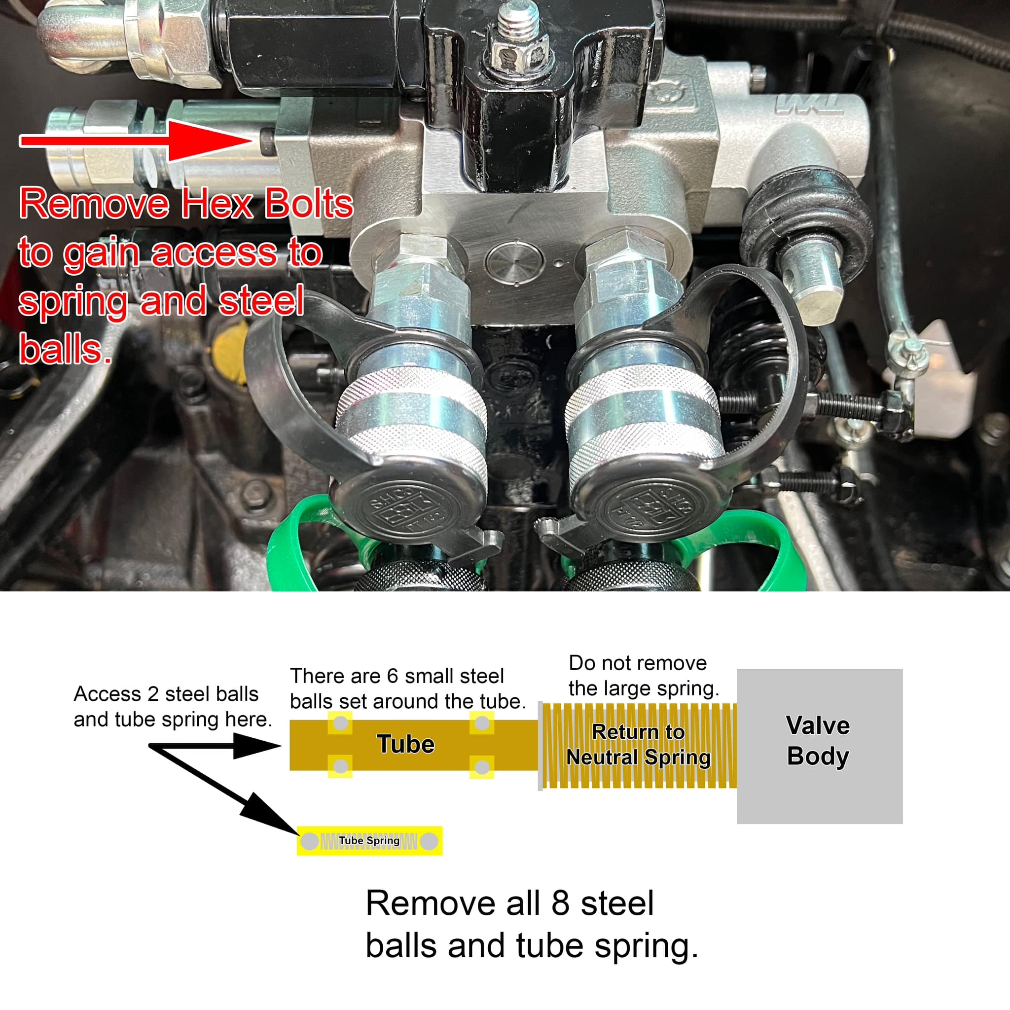

My TYM has three rear remotes. Two of them are detent valves. Is there a way to "un" detent them? I.E., is the detent built into the valve, or the operating lever?
   / Valve detent #2
depending on valve you can pull spool out take of spring assembly and remove balls
What type of valve is it make etc
Does it have a spring action or is it detent both ways some have no springs for center just detent
Others are just detent one way
For a float position
Does it kick out with pressure
Many variables
   / Valve detent #3
Yes, you can remove the detent balls and it will make just spring centered.
Here is a drawing someone made on another forum. Maybe it will help you.
Word of caution, this is all spring loaded, once you pull the spool cover out, just be ready to catch any stuff that may come out flying. It may be better to cover it with a rag while pulling the cover out.
