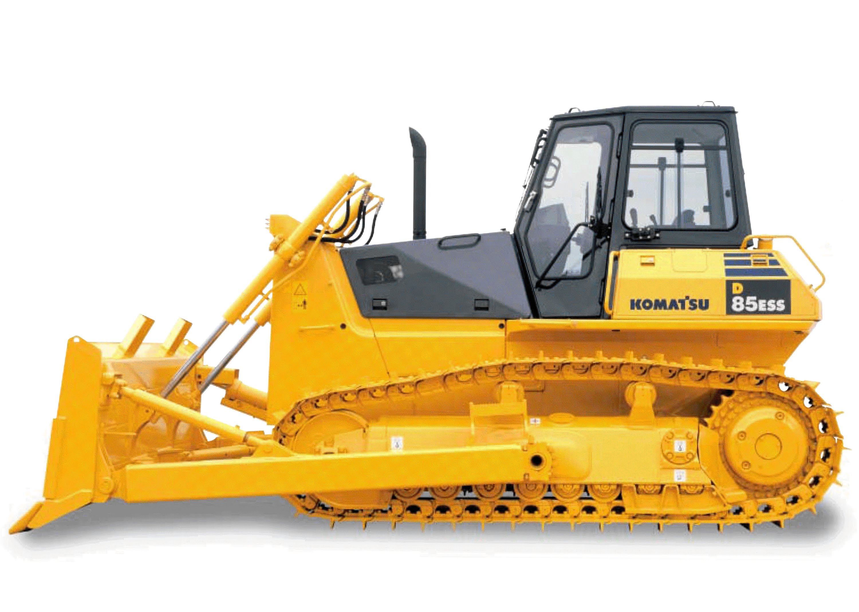

I will admit that a loader lift cyl should be mounted in a push instead of a pull position, but I have seen some old loaders that werent mounted that way. Also there are a lot of other equipment that do mount lift cyl on the retraction side of the cyl instead of the lift. The C frame on a lot of dozers, the boom on a lot of backhoes, some knuckle boom loader, just to name a few. No one is disputing your statements about cyl not retracting unless the oil has someplace to go outside the cyl. You are 100% correct, but I am also 100% correct that a cyl can extend without adding extra oil to take up the space lost as the rod exits the cyl barrel, while oil wont compress, it will expand. Will someone experience it using normal farm equipment with normal loads, with the cyl mounted to push rather than pull, probably not, but lift a backhoe bucket full of dirt with the lift cyl mounted to retract on lift, and let the piston come unscrewed from the rod and see how fast it will fall.
