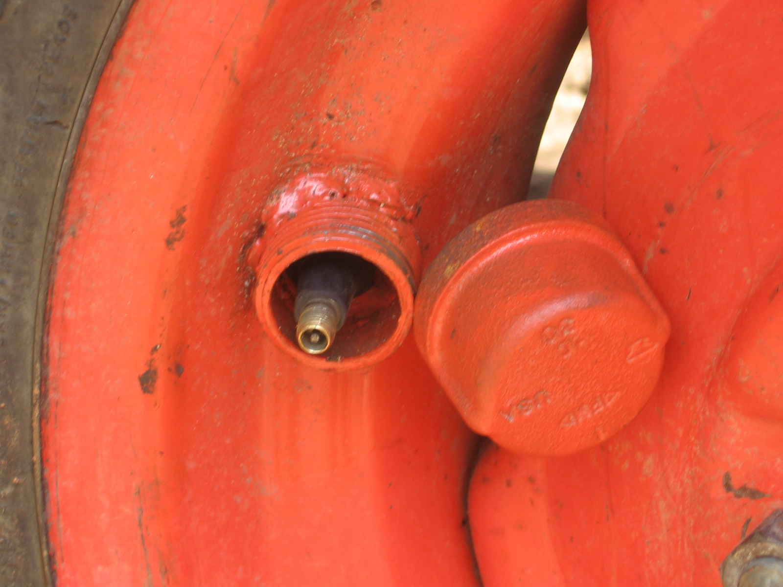

   / Valve Stem Protection Idea and Advice... #27

I have an Kubota MX 5000 and using a back blade to remove snow put my front wheels in the crusty snow bank sometimes. This caused damage to the valve stem and demounted my tire a few times. I also noticed that my summer work with the front end loader in rocky ground had caused damage to the wheel studs. To get around this I looked at doing the welded valve stem protectors, but found it wouldn't offer protection to the wheel studs.
I ended up installing tubes and had two 3/8 by 17" steel plate water cut into disks and used them as hubcaps. The hub caps are held on by 4- 5 1/2" carriage bolts with nylon quick-tite bolts which exactly cover the exposed thread on the carriage bolts. My Kubota rims already have square knockouts so it was easy. It has worked fine ever since.
