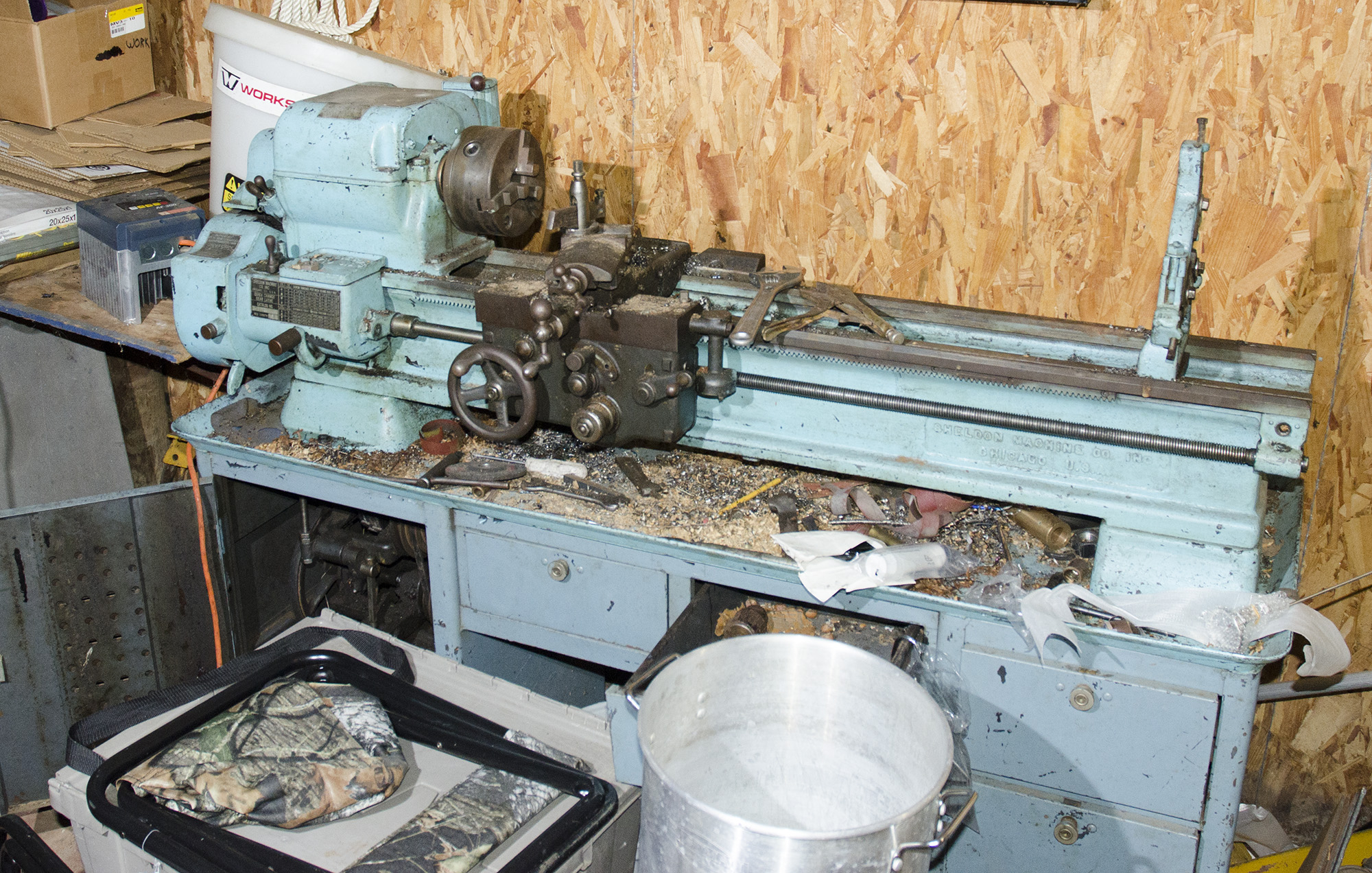

I have two VFD's,, one on a lathe (I got the lathe off the guy I mentioned in a previous post)
The other is on my drill press.
You can see the VFD behind the drill press, on the wall.
Variable speed, motor protection, simple to use,,
adequate torque.
You can see one of them, to the left of the lathe,, small, too.
