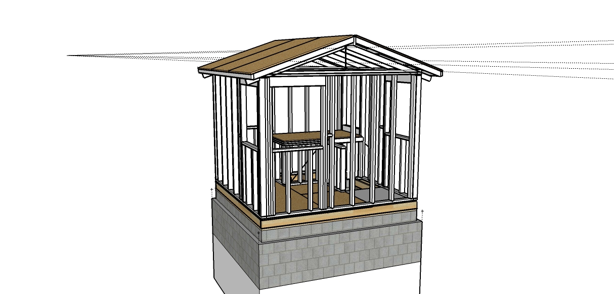

Regarding the design software, I would say persevere with Google Sketchup.
I've been trained and worked with several packages over the years, Autocad, Archicad etc being the main ones, and many other "try and see packages" which have quickly fallen by the wayside.

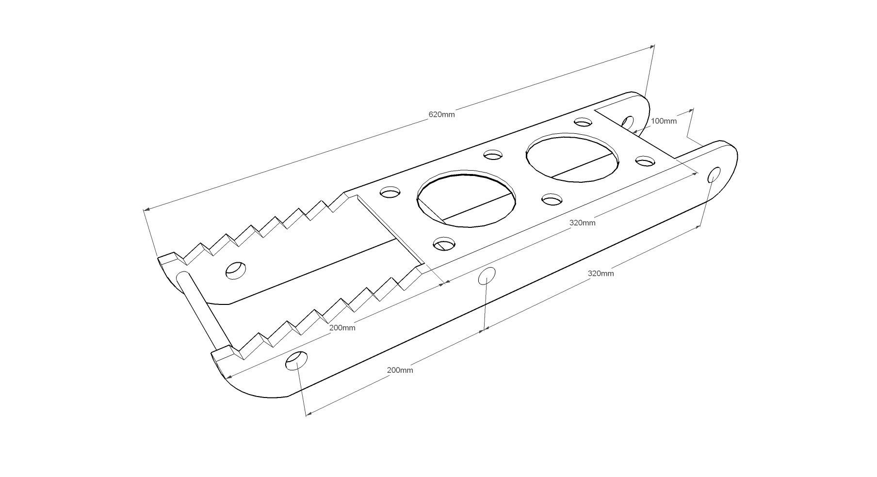

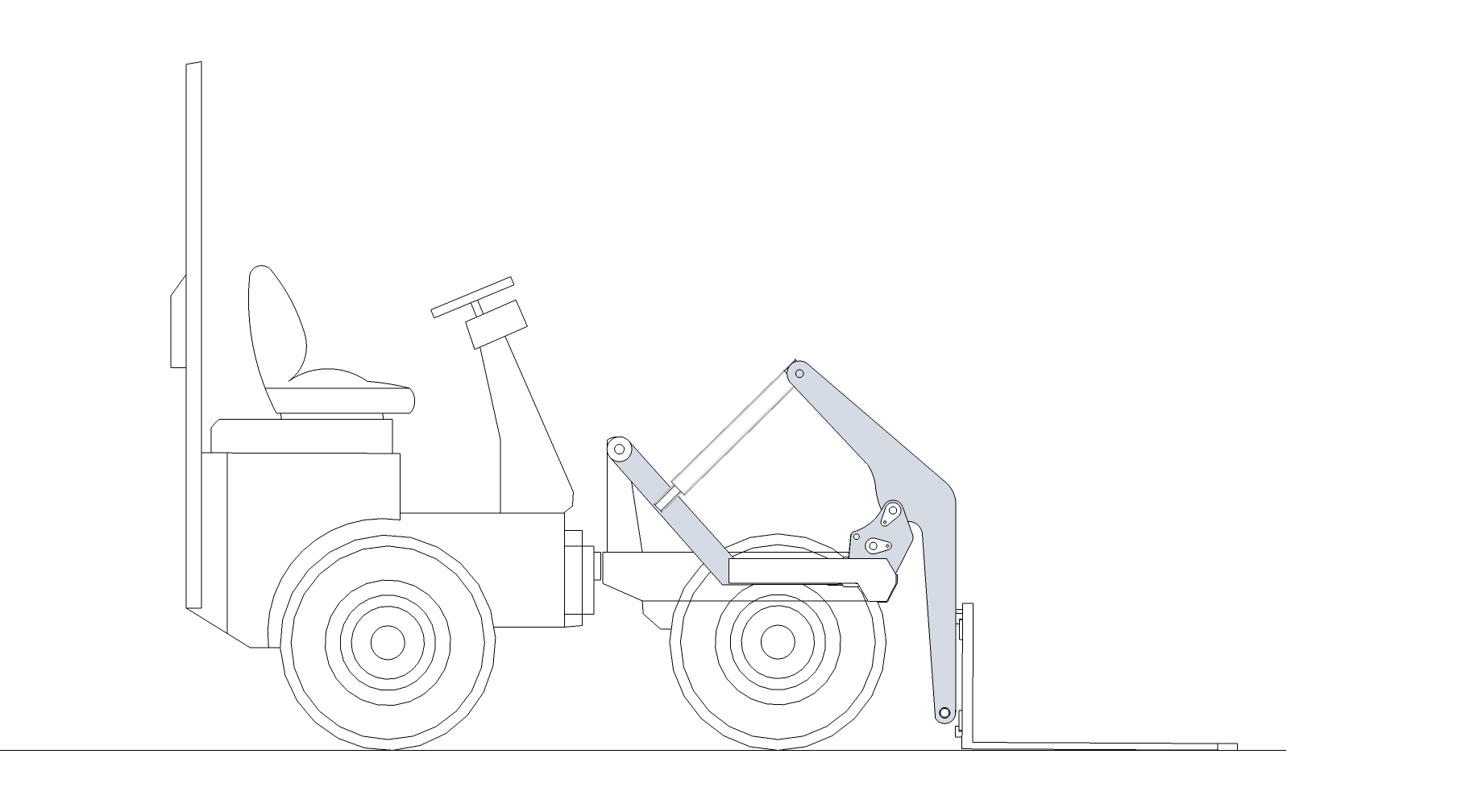

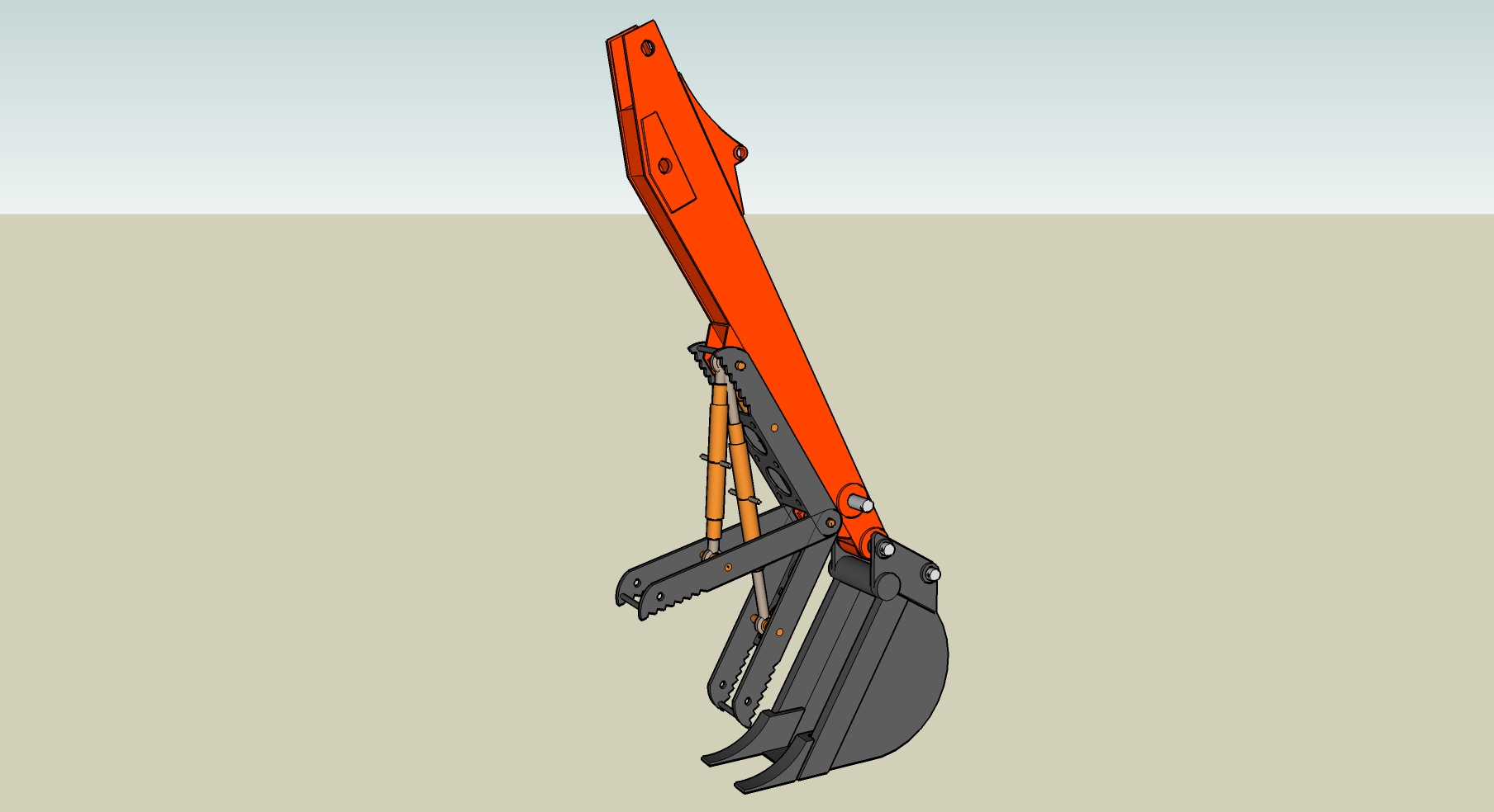

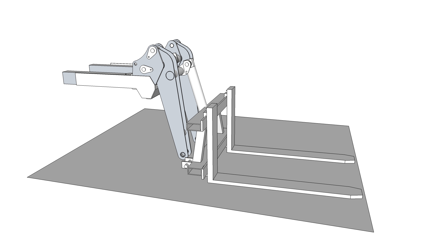

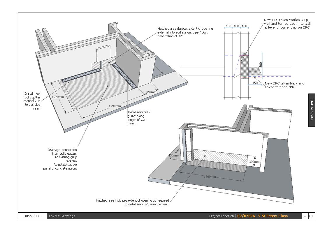

I was an early adopter of Sketchup before it was bought up by Google and have found it the most intuitive natural package yet produced. With the advent of its sister product, "Layout" (I think this is only available to purchased copies), I can now create production drawings and need no other product for my workflow, albeit I don't do as much design work now as I did a few years ago.
I like to toy about with it for some of my hobby engineering projects, see enclosed. Its perfect for testing What if scenarios before breaking out the angle grinder and welder.
Timber projects would be very easy with standard lumber. Try making typical standard size pieces, ie. 6' lengths of 2x4 and then save these as components. Insert, rotate, pin, scale and push pull these to your hearts content to make the items you need.
It works, and works well, but you do have to get into a 3D mindset and away from traditional 2D draughting.
Nigel, did you do those drawings in Sketchup and/or Layout? If so, uh, yeah, I think I will have to give Sketchup another chance and checkout Layout.
