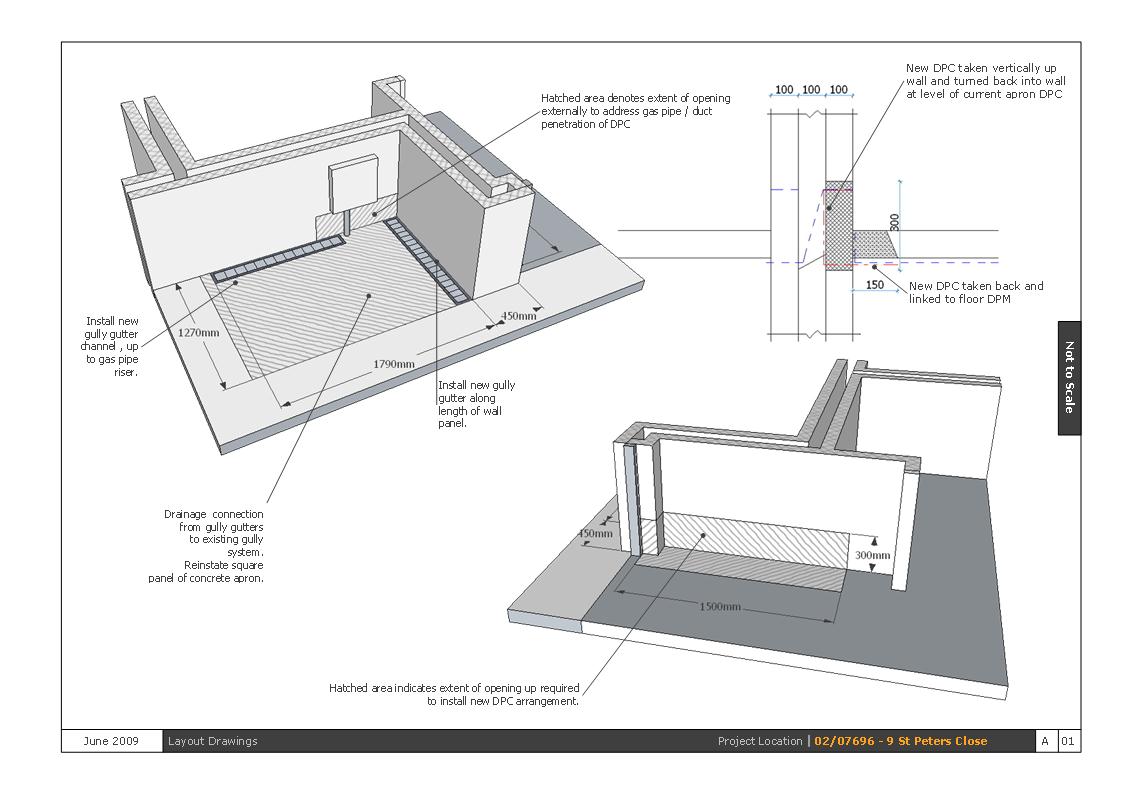

All the drawings shown were directly from Sketchup.
Layout as the name suggests is a formatting package to produce drawing collections.
I've attached one from work to give you an idea of layout arrangement. It's only a single page, but you can produce a booklet of drawings if you so wish. I've some better ones, but privacy concerns would prevent me posting.
The really nice thing about Layout is that you can insert a Sketchup model into the "page" and rotate the live model to the angle you want at any time. It doesn't become a fixed 2D projection. You can also add scaled dimensions to the 3D projection.
Give Sketchup a whirl. The best think about it is that it's free and has 90% of the functionality of the paid version.

This is outstanding. I will now forge ahead through the learning curve of Sketchup. Thank you!

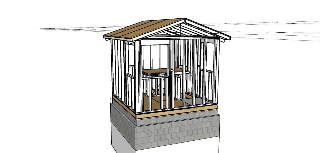

I'd have to second the recommendation to put the time into learning sketchup. I tried a half dozen design programs before I found sketchup. It's intuitive, it's powerful, and it's free. The free part is great because it means many people are going to use it. Then there's a huge population base with some knowledge of how it works. Just here on TBN there have been a handful of threads with advice on how to use sketchup. Do a search and you'll find some very useful hints.
Here are some examples below of drawings I've done for lumber related projects...

This is freaking fantastic.
