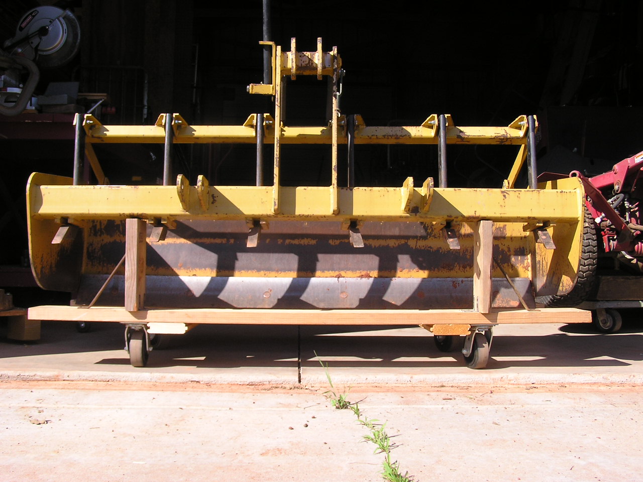

I've got this metal pole barn that up until now I've been using as a shop, as storage for my tractor, but mostly as a place to collect epic quantities of useless junk and provide a free home for snakes and mice. ;) Well, I finally got sick of wading through all the junk, so I went on a relentless cleaning spree, freeing up plenty of space to park my box blade and bush hog. One problem with that, though: it takes time for me to back the tractor up just right and attach / detach the implements, which means that I'm putting a lot of tractor exhaust into the barn. --------------------------

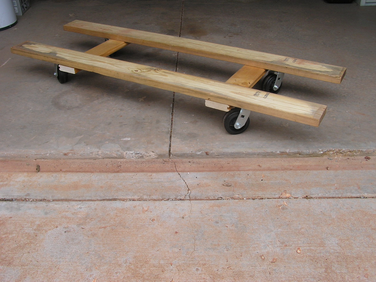

To save hook up time, build a dolly for the implements. You can store them out of the way, then roll it to the door to hook up.
Here is mine for the 6' box blade:
Great idea, think I'll build a couple for my box blade and bush hog. The blade weighs about 400 lb, while the bush hog comes close to 600. Wondering what load rating the casters should be, specifically whether I can assume that the weight distributes over all four wheels. However, it looks like the heavier part of the box blade is sitting over the rear pair of casters in your photo.
Also, are those 2x4s? And what fasteners did you use? I'm thinking of heading over to Harbor Freight...
They are 2x6s. used 5" casters rated at 450 pounds each, ordered from Surplus Center.
Wood screws from the bottom on the cross pieces.
For the casters I used some 1+1/2" long 5/16" hex head screws leftover from when the shop was built.
It doesn't take much to hold the caster in place. Here is a smaller one, put together with some scrap wood and 2x4s:

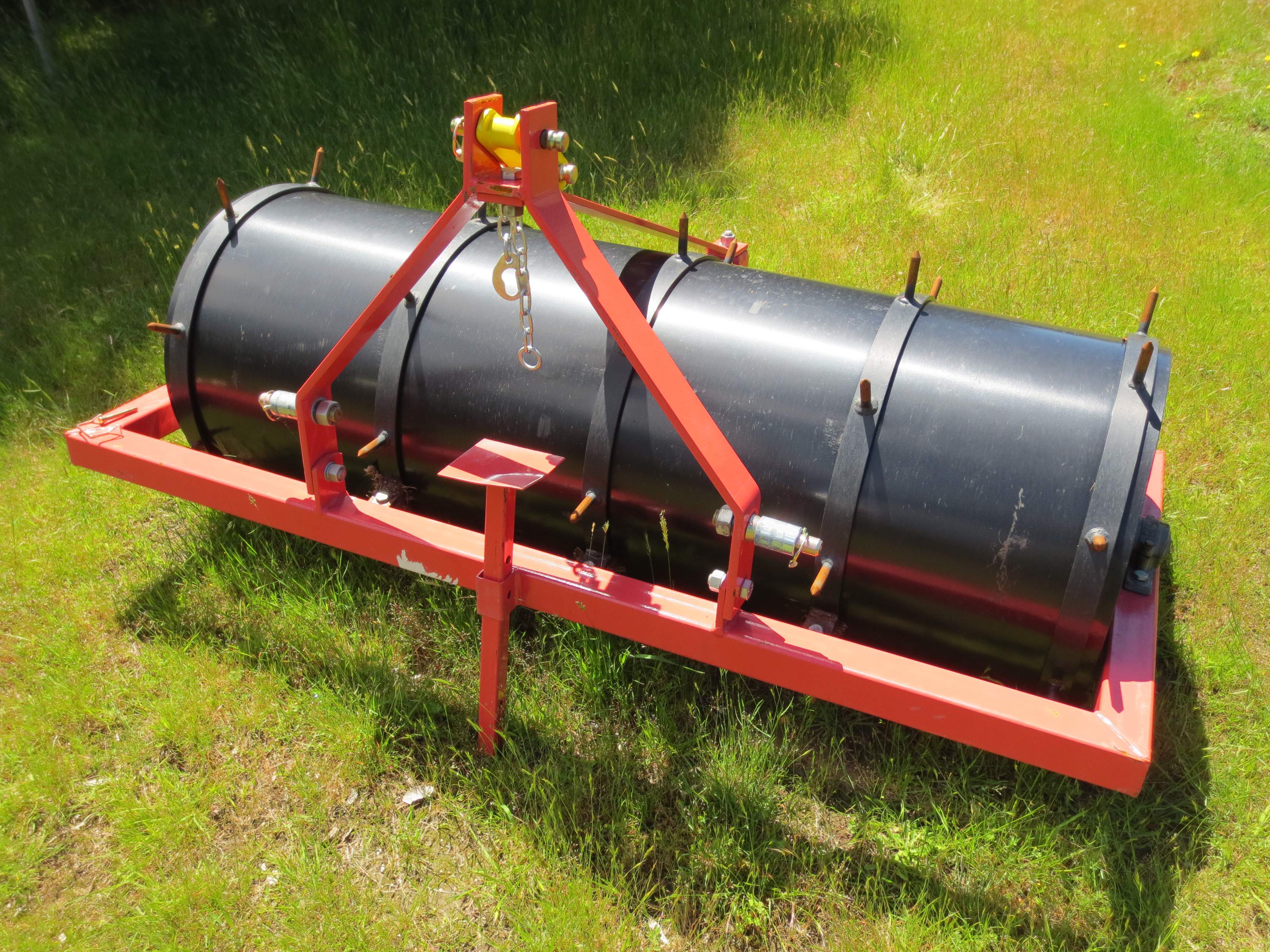

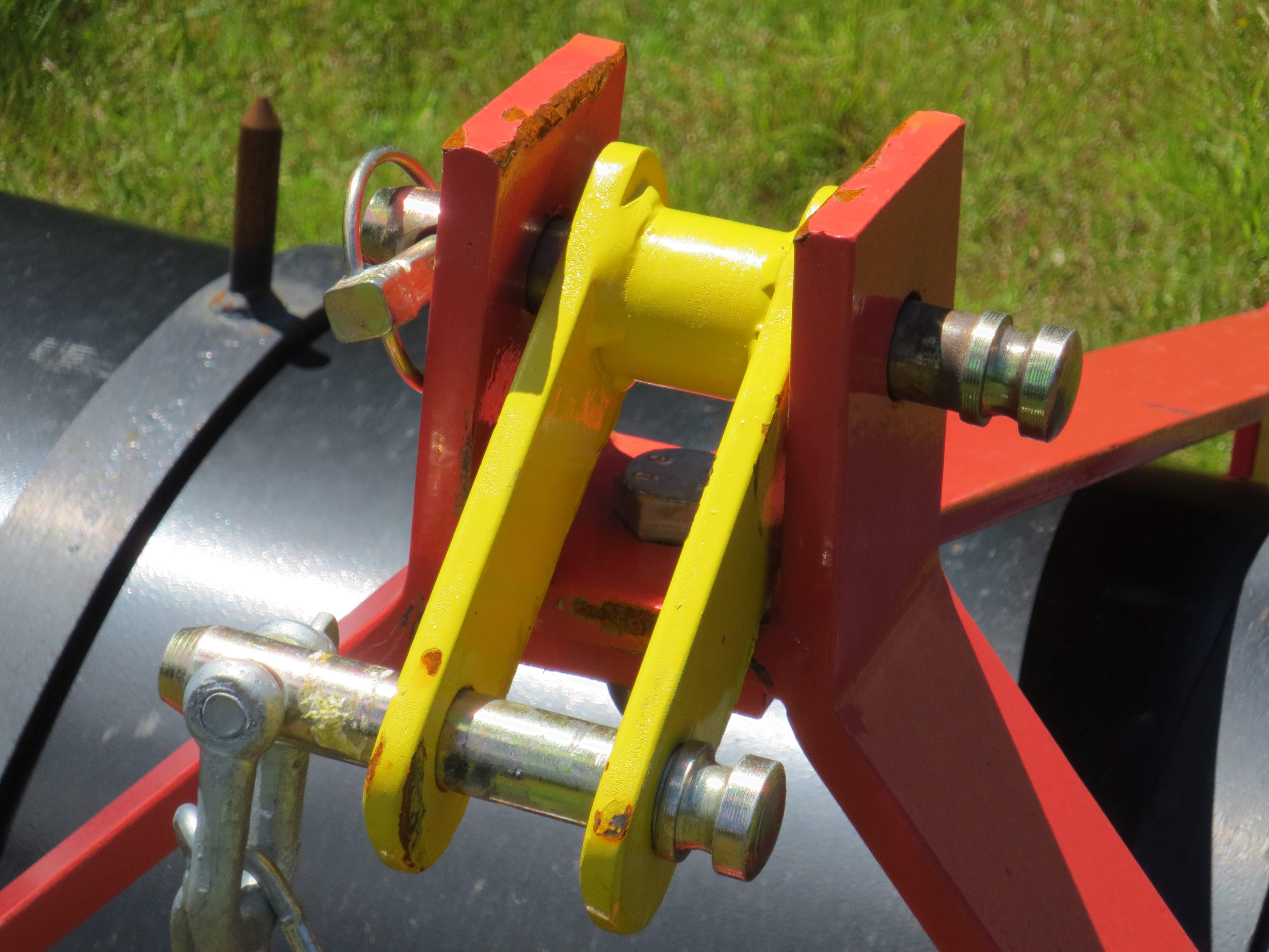

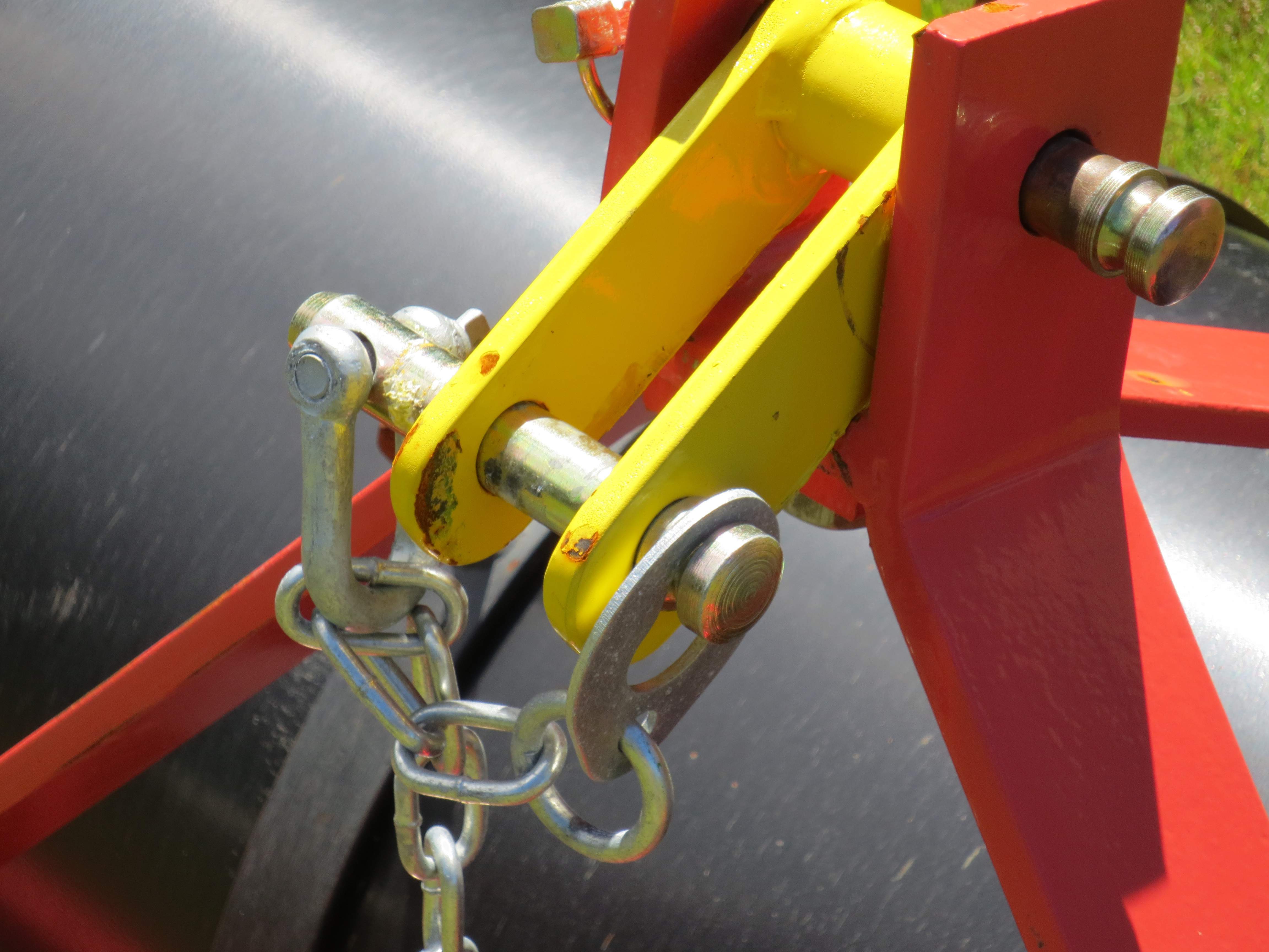

I've only made one 'custom' dolly, and that was for my tiller. Everything else is on wheeled (caster) pallets. I used the small pallet that my ballast box came on, bolted on heavy-duty casters (the 'blue coloured wheel' ones) on and it hasn't failed me yet.
And when it comes to implements fitting a 3pt-QH... you can adapt implements to them using top-link extenders & bushings. I have an iMatch and had to fiddle with "not iMatch compatable" ballast roller to get it to fit. I had a custom-built extender fabricated and it has worked great ever since.
