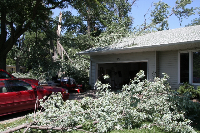

1. There is another consideration on power. The advertised peak tractor power is based on an engine speed of 3600 rpm, but the engine speed at which the generator frequency is correct for household current will be somewhere between 3,000 and 3,200 rpm according to the Operators Manual.
2. I have successfully used a Steiner generator (10 KW peak) on a Ventrac for many years to power my home in emergencies both summer and winter. There is a transfer switch that connects the generator into the main power line to the house ahead of the breaker panel so individual circuits are not selected. We just judiciously limit the use of appliances and lights so that the power demand is not excessive. We do not shut off the air conditioner. No difficulties have arisen in this mode of operation.
The most demanding use occurred in 2008 when a derecho took down a lot of trees that fell across power lines. The main power line to our house was out for over 5 days. The tractor and generator ran for 119 straight hours to provide electical service and was only stopped to refill the fuel tank as needed and change engine oil twice. The most noticeable power demand was turning on the microwave oven--the engine speed droop was easily heard. Otherwise the tractor just hummed along. This was a 31 hp Turbo Diesel.
Thank you for your observations, Jack.
That is a good point about the difference between crankshaft rpm for rated crankshaft hp and crankshaft rpm for a 60-Hz generator output frequency. Do you use a frequency counter to set the output frequency to 60 Hz? Or do you adjust the crankshaft rpm solely to keep the generator's output voltage within spec?
The Derecho of June 29, 2012 caused us (and many others) to lose power. I will have to check my records to make sure, but I think that the utility restored service within three days. Considering how many people lost power, I was surprised that the utility was able to restore power to us so quickly. But other Marylanders were out of power for more than one week. As I recall, some Pennsylvanians were without power for upwards of 10 to 14 days.

I routinely follow the Ventrac recommended oil change intervals. That is why I had to do 2 in the 119 hour event. The first was due soon after the event started and the second 100 hours later. I did not think the work load with the generator to be "heavy," so I did not go to more frequent intervals.
