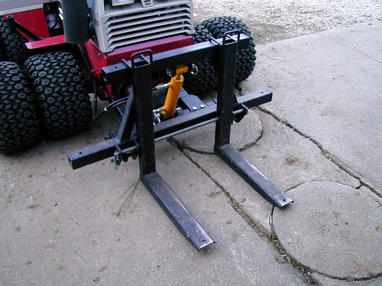

I designed a mounting frame with hydraulic cylinder to attach a set of 3-point hitch adjustable pallet forks I purchased to the front hitch of a Ventrac. The mounting geometry has to be chosen carefully so that when the forks are fully raised and fully tilted back, the back stop doesn't contact the tractor hood.

Hello Jack,
This looks like a real good set up. its exactly what i was looking for, looks like it has plenty of lift. Would you mind giving me the dimensions and sizes of steel used to build this? Also the cylinder specs? I can build this entire thing. I want to incorporate a grapple on top that can be removable. After looking at yours i think i can come up with a mechanical linkage that when you roll the forks back the grapple will close. thanks Dunebuggy55

The original frame and forks for the 3 point hitch were rated at 1700 pounds by the manufacturer which is now out of business, but, of course, the front hitch of the Ventrac will not lift that much. I really don't know how much it will lift. However, it has served me well for transporting limbs, brush, platforms, and utility boxes I have designed.

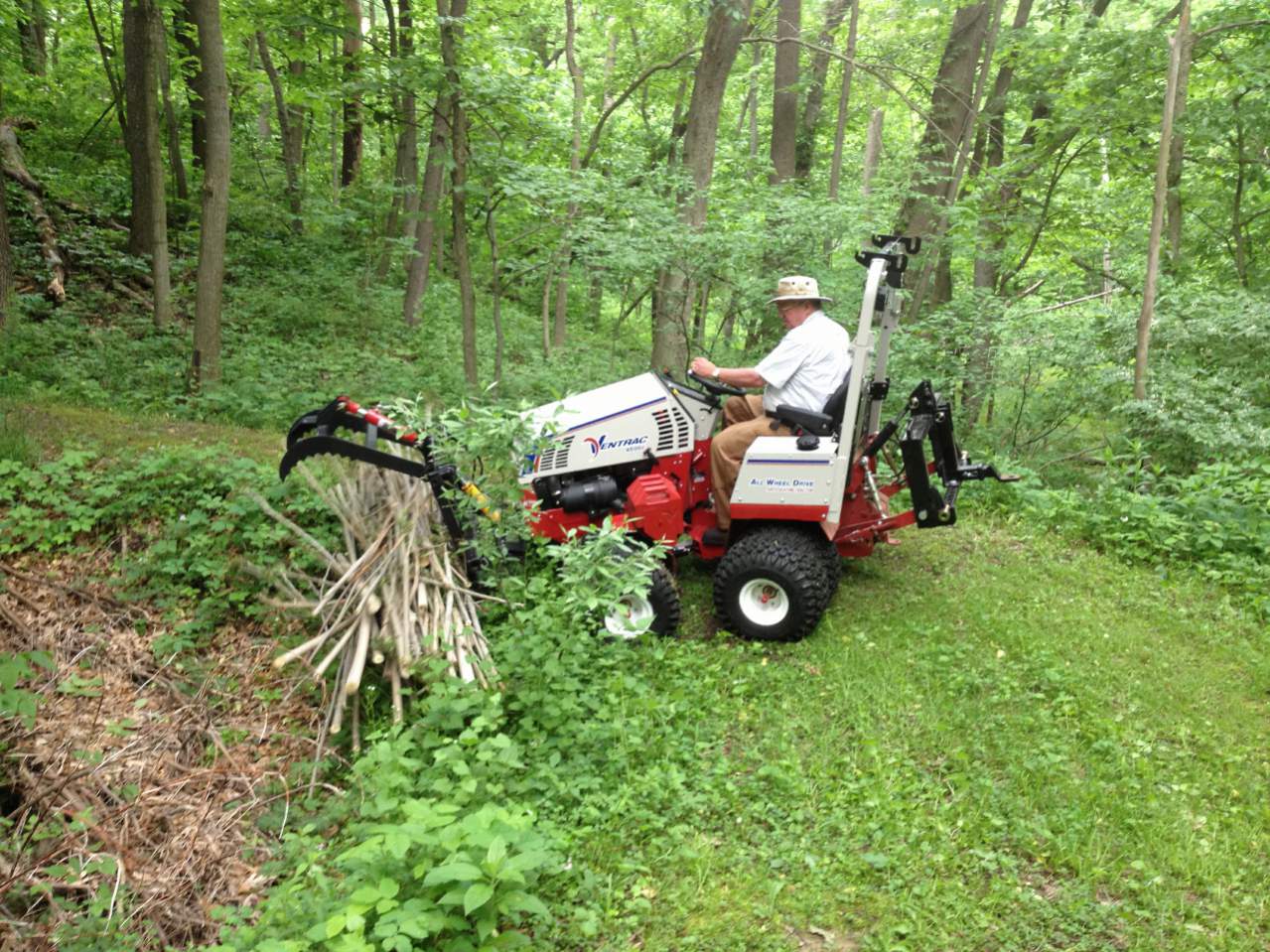

I have recently installed a grapple on my forks. The grapple itself is called "The Thumb" and is available from The Thumb . I designed the mounting bracket--it is not the same as you get when ordering a Thumb.

jack, where do you have the thumb plumbed to? I have remotes on the back because i also have 3pt. are you tied into them?

You can plumb directly into one of the two rear remotes either by using a pair of long hoses or you can Tee directly into the lines under the seat.
