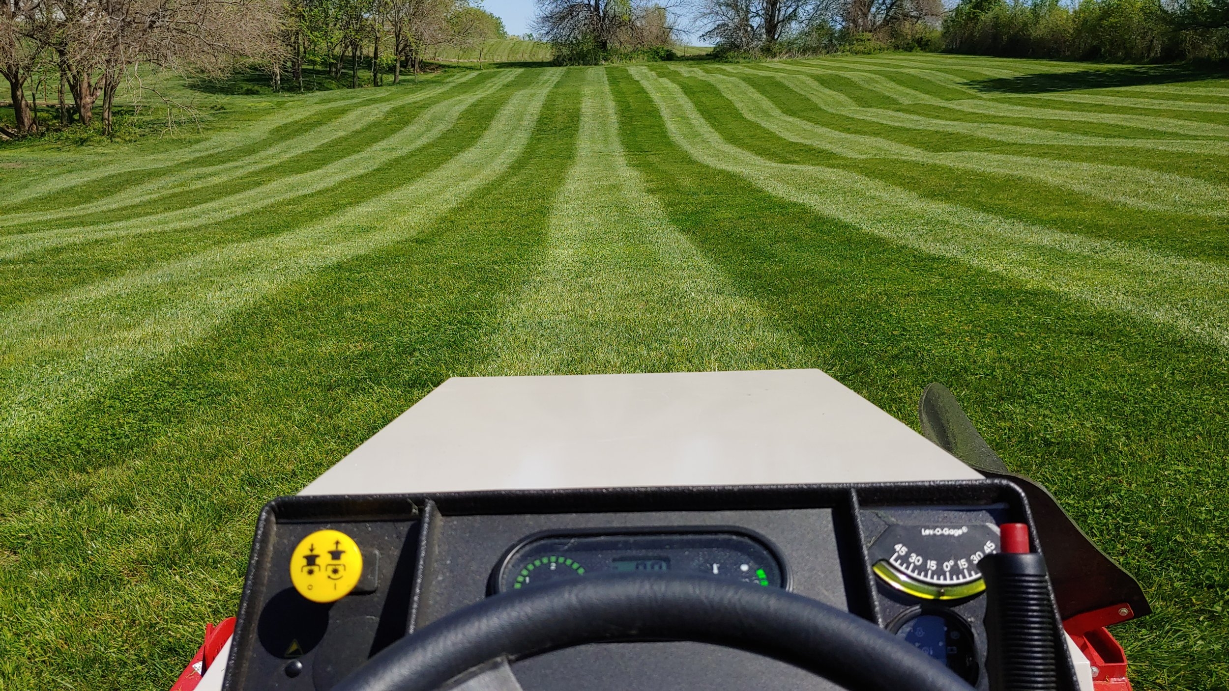

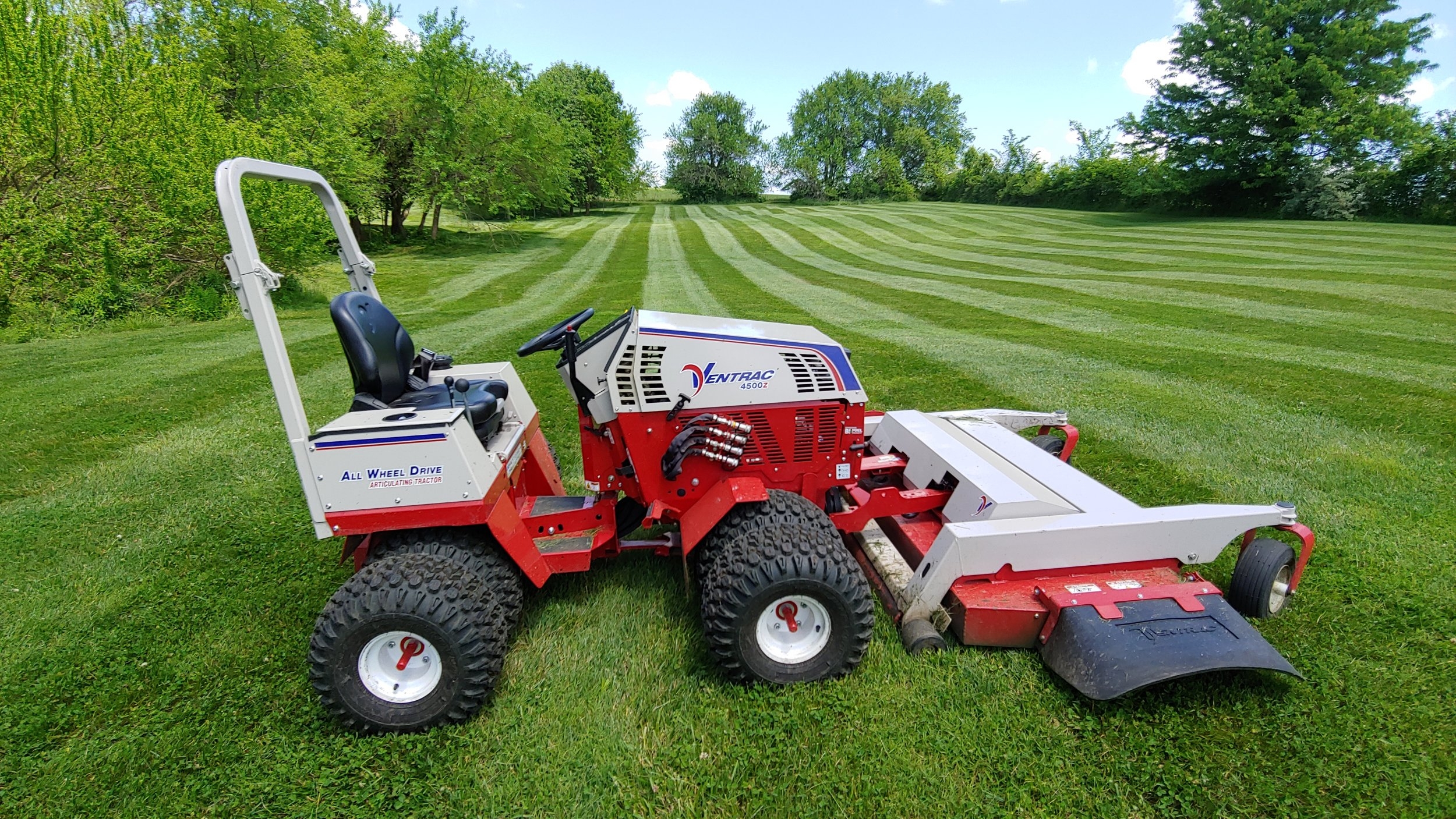

I mow several acres both with the Ventrac (72 inch finish) and a 61 inch Scag zero turn. I have both hilly areas and flat areas.
I mow the larger flat areas with the Ventrac and the 72 inch finish deck in high gear at about 8-9 MPH. Top speed is 10 MPH. In low gear, top speed is 5 MPH.
The zero turn is much better at maneuvering and turning, but the Ventrac is much more enjoyable to mow with. It is more comfortable, much better on steep hills, around ponds, and creeks. Plus you sit up a little higher than a zero turn and don't eat and inhale so much dust and grass.
The Ventrac is indispensable for me. Not only do I mow with it, but I use the power bucket and grapple to move dirt, rocks, and brush. I also aerate and fertilize with it. I have also used it to pull my zero turn out of the mud. :)

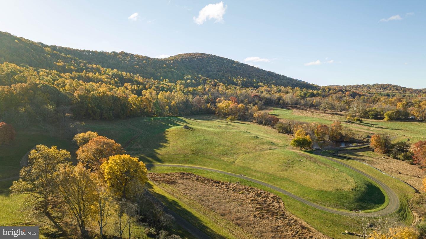

Hi- Appreciate the advice, and you all can probably imagine the choice I am wrestling with.
About 25 acres to mow in Virginia. Below is photo of top 15, bottom 10 similar. Most is at a 5-15 percent grade, but probably 10% is around 30 percent grade. Rocks interspersed and some trees down low, but also lots of open field. The guy who has been doing the mowing has done it with a 60" Scag ZTR, but that is kind of nuts. He occasionally secures a brush hog, but without ready access to one it means staying on top of mowing more frequently. There is about 3-5 acres of woods where I would like to keep some trails open for ATVs.
I absolutely love the Ventrac and did a demo. Setting aside price, I think it is perfect as I could get attachments over time. And I love the safety/stability, though nervous about giving up some mowing speed to a ZTR.
The alternative is a CubCadet slope mower ZTR that would be perfect for the fields, and then a smaller used SCUT or CUT that I could use with a brush hog, loader, scraper, etc. That might actually be cheaper and I would have two tools that are more specialized, but also two tools that require maintenance, etc.
I do value everyone's advice and experience so thank you in advance.
And yes, I feel luckier than a kid at Christmas to have picked up this land. Nothing on it but a trailer for next few years, but hope to build down the road.

OP's property looks great in the photo, but the effective ground speed may be limited by how smooth the ground actually is on the flatter areas.

The OP's predicament is he estimated 10% of his 25 acres to be mowed is 30 degrees. That is 2.5 acres of steep slope mowing to be done. Ventrac is one of the relatively few brands of ride on machines in the USA that advertises the capability of mowing a 30 degree slope, and they have a Youtube video demonstrating mowing a 30 degree slope.
