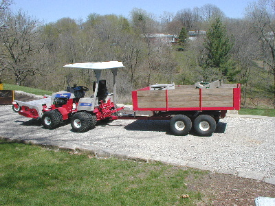

I am interested on a trailer with a dump capacity for my Ventrac. Does anyone have any suggestions

David,
If you are looking for a hydraulic dump trailer this is what I use. The tandem axle allows the trailer to "walk" over bumps and dips. It is rated at 2 tons capacity by the manufacturer, Country Manufacturing www.countrymfg.com. The hydraulic cylinder (24 inch stroke) is not included, but it is a standard agricultural unit available from Northern, Farm and Fleet, etc. The lugs to attach the cylinder are already welded into place on the bed and frame. The jackstand is included.
Price if you order directly from Country Manufacturing is about $1200, but that includes shipping to any freight terminal in the country. It is also available from Northern.
If you order your Ventrac with a 3 point hitch, it also includes a set of rear hydraulic outlets and control valve. If you don't need the 3 point hitch, you can still order a set of rear outlets.

Nice dump trailer, by the way...
