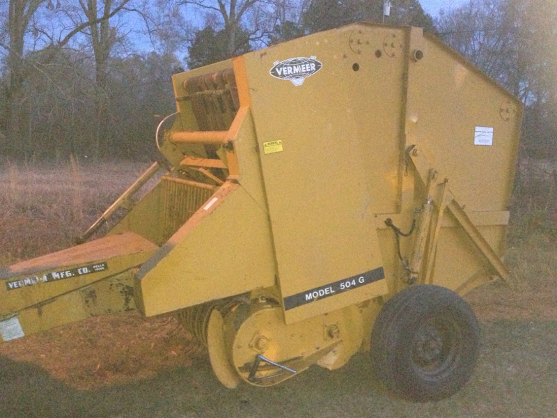

Just got this 504G yesterday, has a few minor problems (hoses,pickup teeth and probley some new belts)

Just checking everything out today, had to replace the hoses for the hydraulic tie. When I run the tie arm to the right side and let off the hydraulics the arm creeps back to the left, is it supposed to do this or do I have a problem? How many wraps per end of bale snd how many in the middle,I guess I forgot to say this is my first round baler and don't know jack s@$t about them.

Just checking everything out today, had to replace the hoses for the hydraulic tie. When I run the tie arm to the right side and let off the hydraulics the arm creeps back to the left, is it supposed to do this or do I have a problem? .
Have you cycled twine arm cyl enough to purge all the air out after R&R hoses? The twine arm should stay where you stop it. Back when I baled with twine I tried to space the twine about 4 inches apart. The more twine you put on a bale the less water will penetrate and the better the bales stay together but then time and $$$ for twine enter into the picture.

Jim, yes I cycled the arm several times after I installed the hoses, but it still drifts
/ Vermeer 504G #20
Sounds as if the piston seal in the cylinder is leaking or the control valve is malfunctioning
