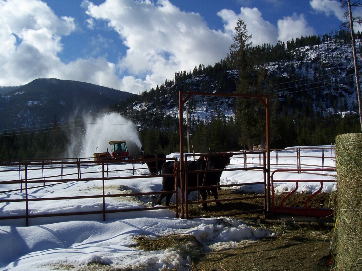

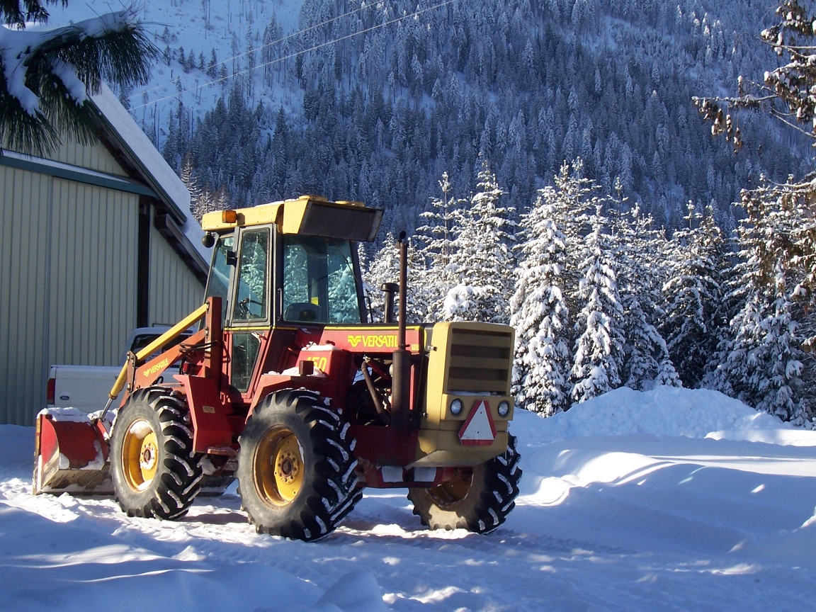

Just found this thread, interesting. I have a 1980 150 series 2 and have put 8000 hours on it to date. The wife and I just love this tractor! The Perkins motor is trouble free and the oil is still honey clear at oil change time. I have had to replace u-joints but that's to be expected. I use it for loader work, haying and snow removal. We run a 8 foot blower on ours, great set up! Just a thought on your problem, have you looked at the hydraulic oil pump? It will cause a load on the engine if it is damaged or under load while cranking. Could be in the hydraulic problem similar to the hydrostat. PK
