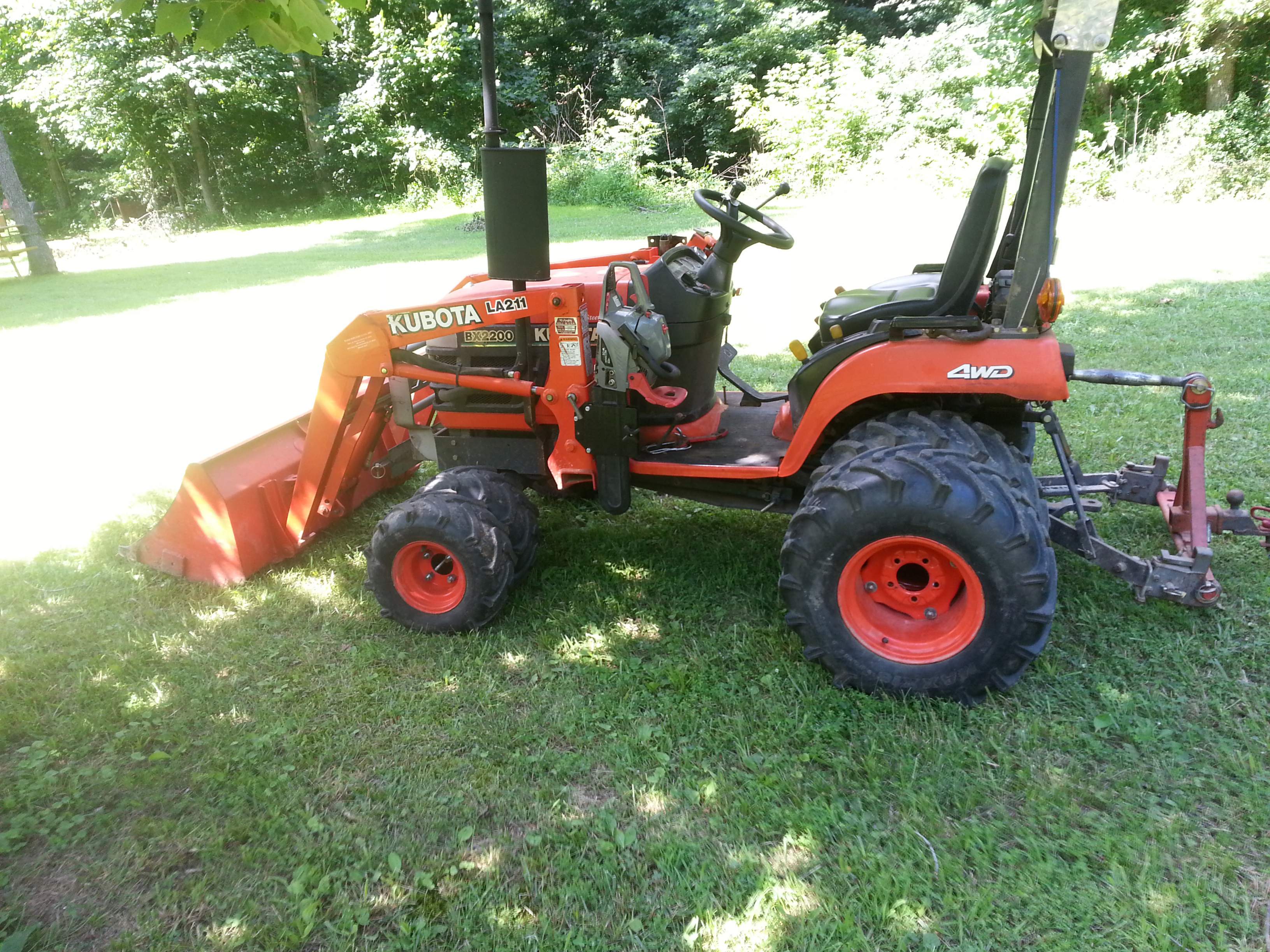

I did this to my BX, I tried two different round mufflers and they were too loud so I found this Honda Civic muffler and it's as quiet as stock.
That looks 'corny'....:eek: So do the dual tires. Let us know when you break an axle. Those small units aren't built for that much tire width. Axle diameter isn't nearly enough to carry duals.... It's yours so you can do what you want to it but be apprised, it's yours forever.
Diesel engines that are naturally aspirated, the exhaust is extremely loud.
