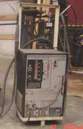

Its a lincoln ac/dc machine. Its junk! It has a 3 position switch. Both dc settings have not worked for years so i consider it ac only. Figured corrosion was the problem so i swithed it back an forth a bunch and it started workin in the dc- position. I know i could revere my cables but they are hooked up inside box and i didnt wanna swap em. Im happy with my results. As far as the 7018-110s are concerned i thought the same thing until i saw the box. Then had to show dad the box to get him to believe me. Ha.

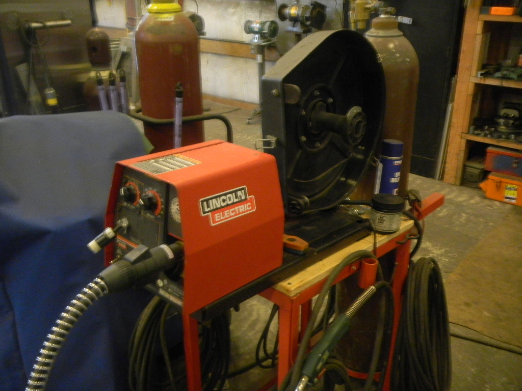

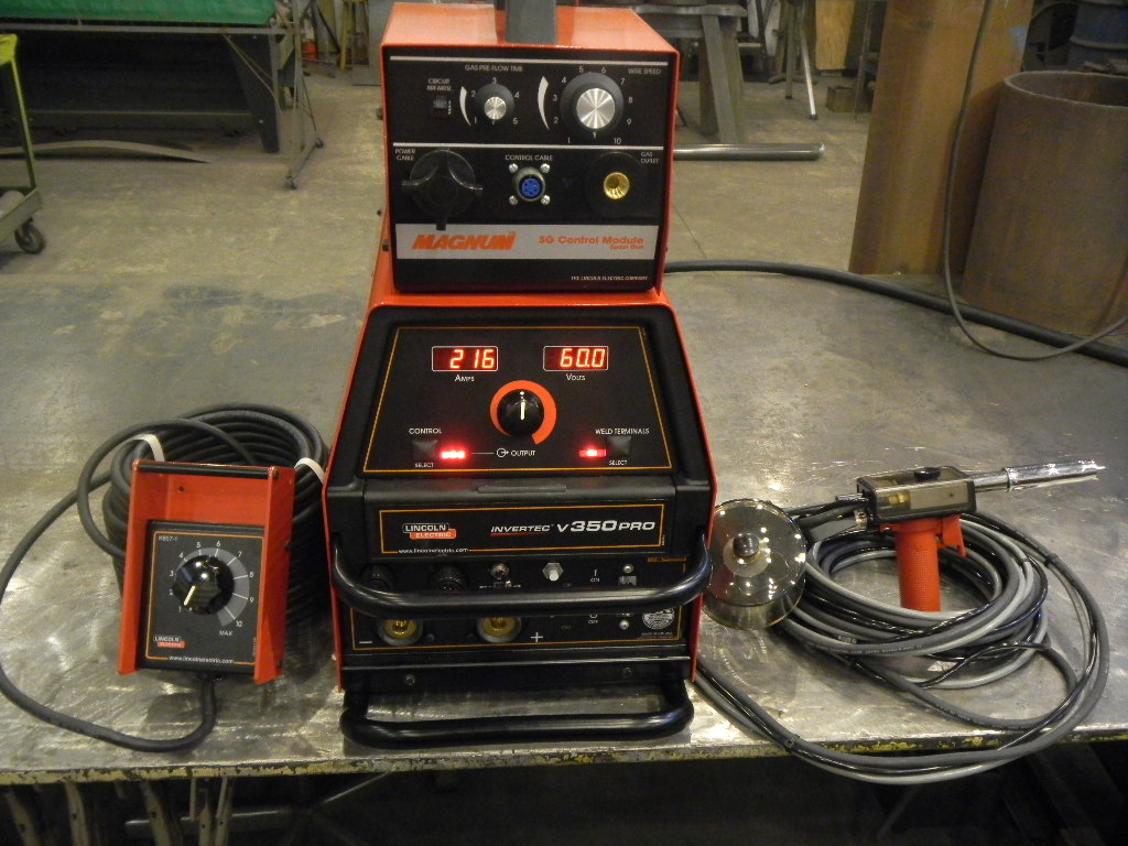

No, no, no get the Miller XMT-350, or the Lincoln V350-Pro like I have. You'd be amazed at what these machines can do! Here is a list of things my 350-Pro can do.
