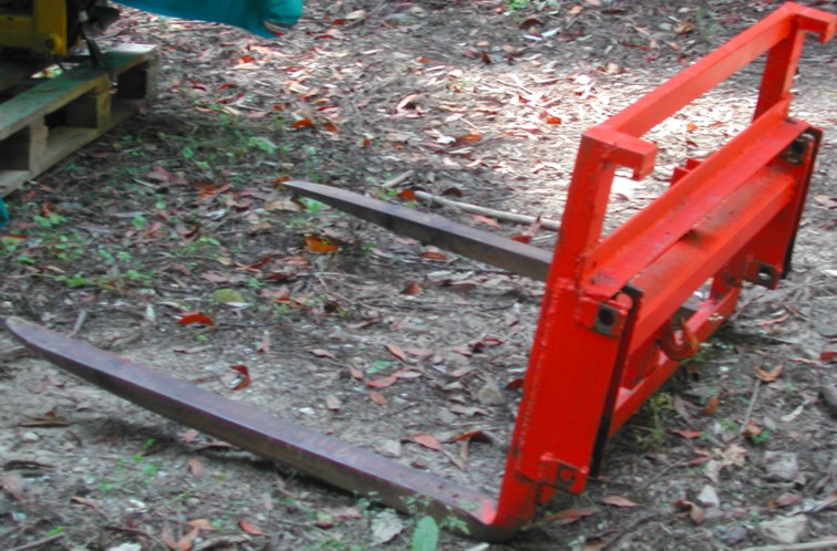

OK, to Ken's point, I am going to change the topic of this thread to
"How do I cut a fork in half lengthwise" with the inferred adder: "Without taking forever or screwing up the heat treating"
As I mentioned, I have forks right now that I could cut in half, but I could not think of a good way to do this.
Torch is sloppy and I would think screw up the heat treating as I sliced up the 1.5 thick (or so) "thick end"
Plasma cutter will only cut to 3/4"
Swing the band saw vertical and muddle my way through?
To end up with a clean solution, I like the band saw idea, but how long would that take?

I used my forks for a saw horse until I sawed about half way through one fork with a skillsaw with a carbide blade in it. Might give that a try.

I made a couple of sets of the forks in the photo. They weigh 180#, and
I sacrificed length and adjustability to get lower weight. I started with fork
tines that were 36" long and 1 3/4" thick. They weighed about 100# ea. I
first welded hooks on the top to hang them from the bkt of my L2550,
after welding a chunk of 1x1 steel to the top of the bkt. I improved on
that by making the frame in the photo. I paid a steel distributor to cut
the tines length-wise using their industrial plasma table, but they could not
cut the elbow part. A friend finished off the elbow cut with his 14" gas-
powered abrasive saw. There was no problem with the heat. This steel
is a very tough alloy that does not even rust.
Now, if I did another set, I would prob try one of those low-speed steel
circular saws (Evolution) with carbide-tipped blades.

I have one of those 'slow' speed milwaukee 8" metal cutting hand held circular saws. The blades run about $45, the saw with a blade is $300ish. One blade cuts a very long time until you pinch the cut or hit a piece of rock, like the floor of the garage. With a straight edge to guide the saw, cutting through 1/4 steel is very fast, like cutting 3/4 plywood. Cutting through 3/4 mild steel is fairly fast, like few sec per inch. Overheating the tool is a problem for long cuts on heavy material (over 3/8 inch) so plan on a cooling off time. The point of this is that if the tines are not too hard, ie, wreck the carbide right away, I would clamp the tine to a sheet of plywood, clamp on a wood straight edge to guide the saw then expect a great looking straight cut down the middle of the tine in a few mins with no heating of the blade. If the tine is too hard, the blade will overheat fast then turn to a shower of sparks. I have cut up to 2" thick steel with this saw. I have also cut down snow plow wear edges that appeared to have some hardness to them without any issues. Overall, if you don't have access to a saw or heavy duty plasma cutter the idea of using a gas powered abrasive saw sounds like the cheapest option. If you keep flooding the tine with water during the cut, the heat affected zone of the cut should stay close to the cut, ie, not weaken the tine much. Personally, I am no good at cutting straight with gas cut off machines.

bx24 said:
What did they get you for the "plasma cut" at the local shop?
I paid a very expensive structural steel seller (PDM) $100 to cut all
but the right angle on one tine. That was nearly 10 y ago. You might
do better to shop around local steel fab shops, but I needed to cut
thru 1.75" of steel. My plasma cutter is only 40A, and good for 3/4" max.
You can get the Evolution saw with blade for $100 from HF Tools.
