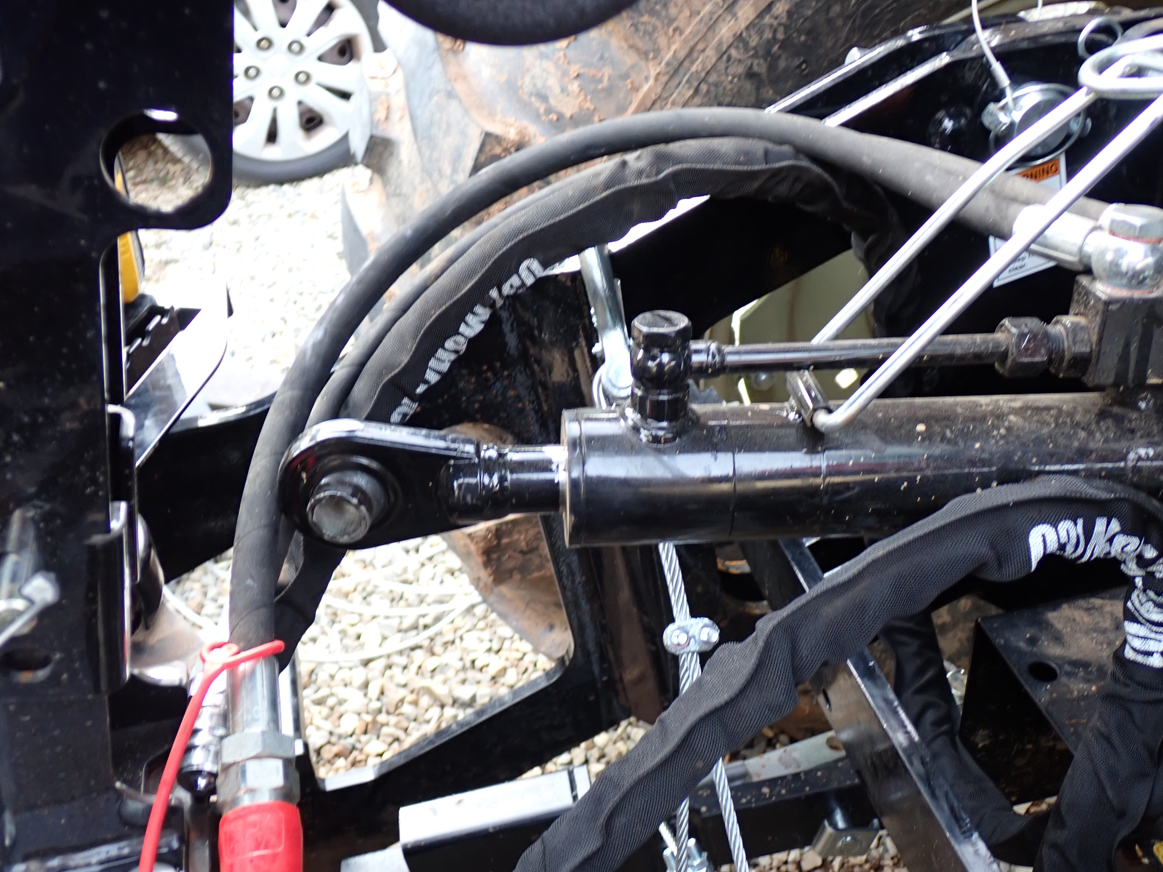

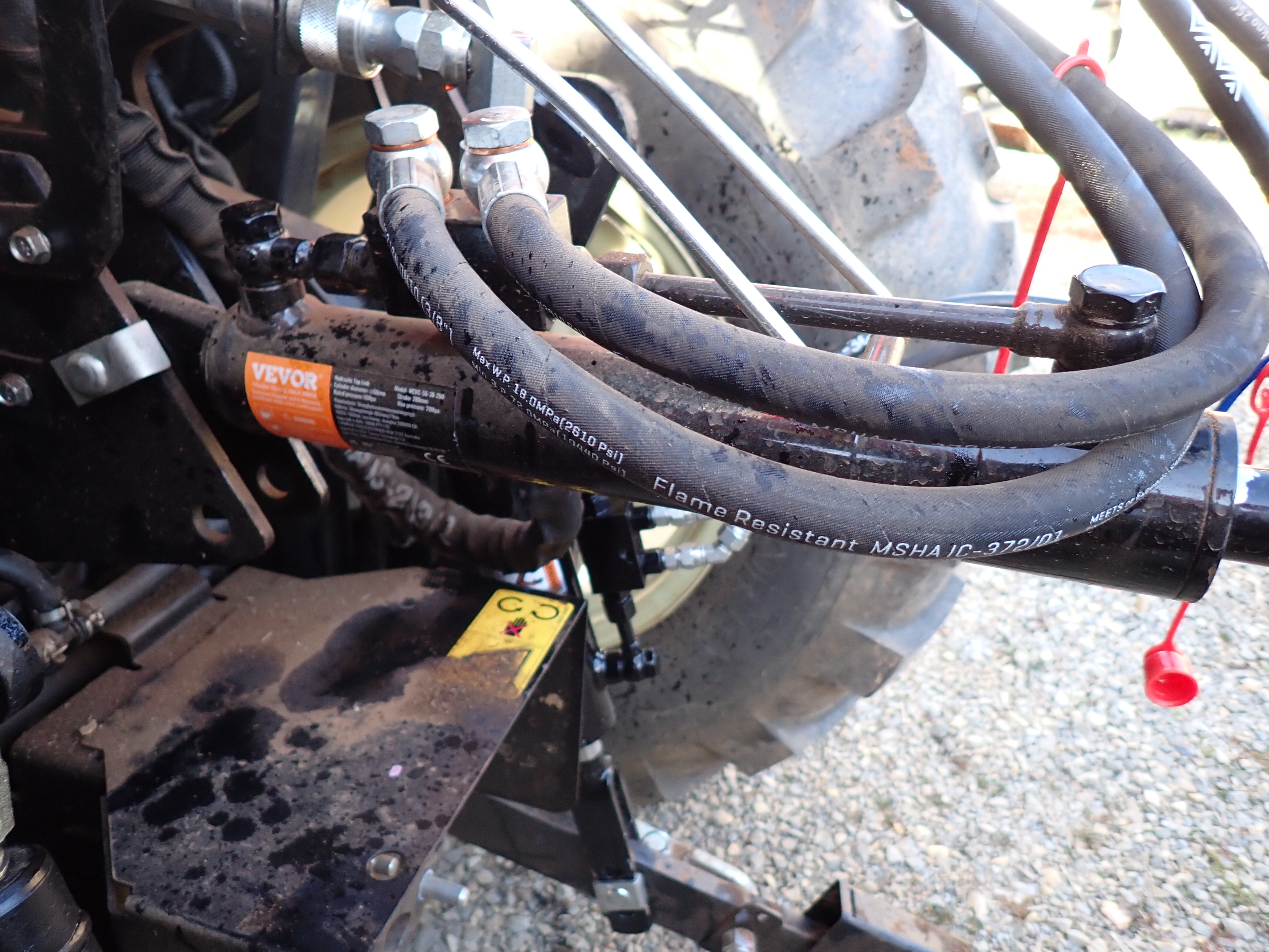

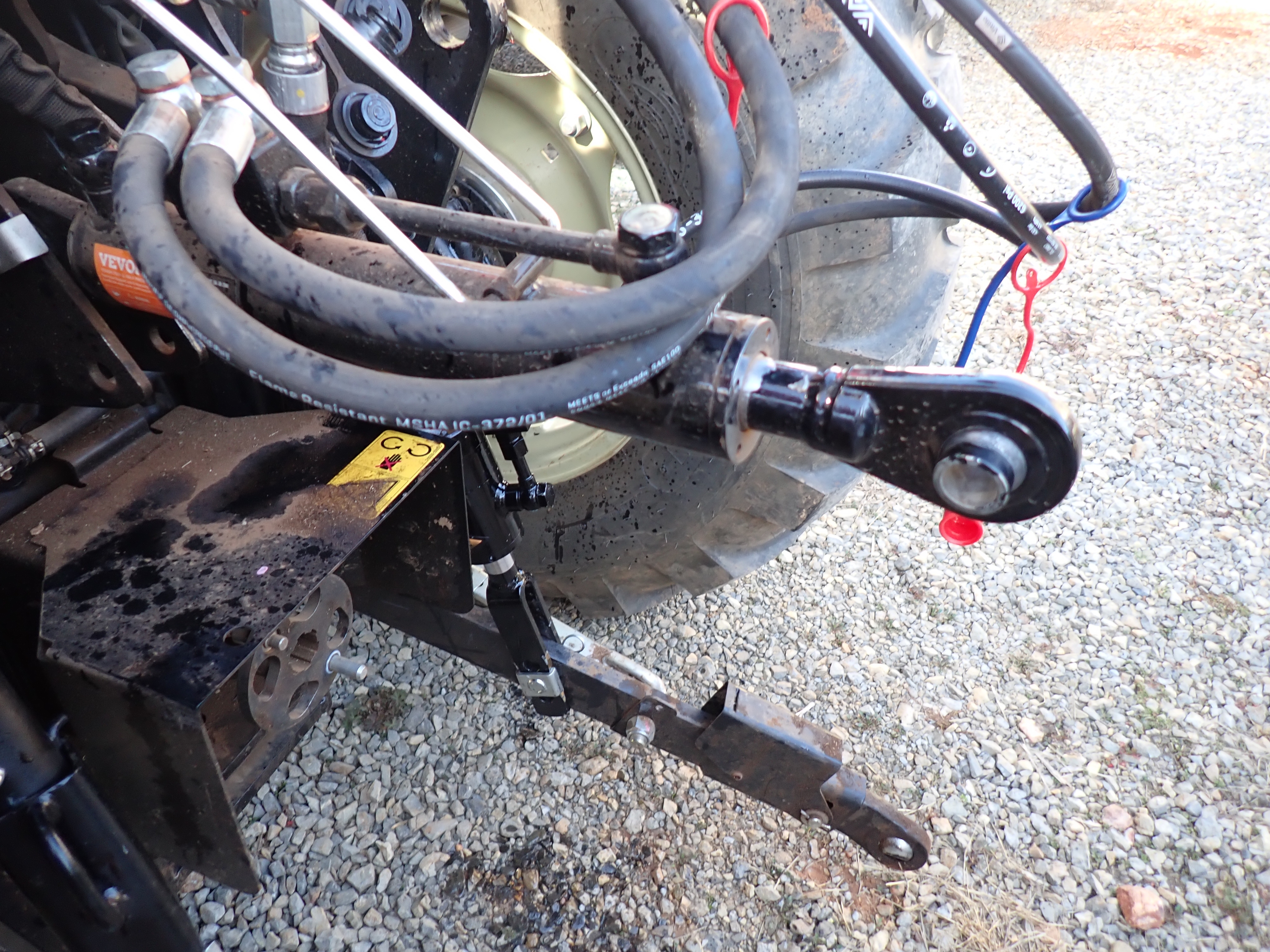

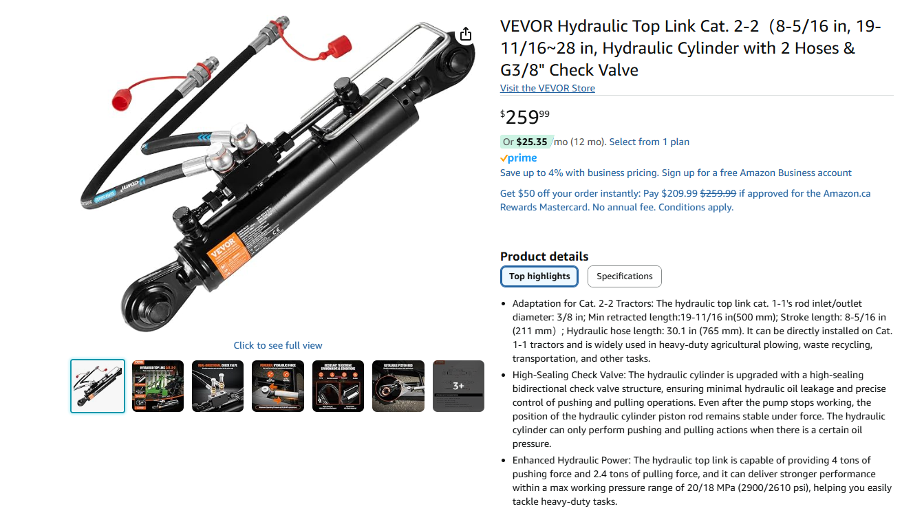

Anyone have one? I was going to assemble one from parts and saw them on Amazon (CDN money)
   / Vevor Hydraulic Top Link #2
I can take a few pictures, no problems so far and does not sag down.

Princess Auto has them on sale (minus the hoses) By the time I buy all the fittings and assemble it myself it's more money than the completed Vevor one and wouldn't have the leak down valve.
I'll have to check where the PA cylinder is made, might be better for longevity.

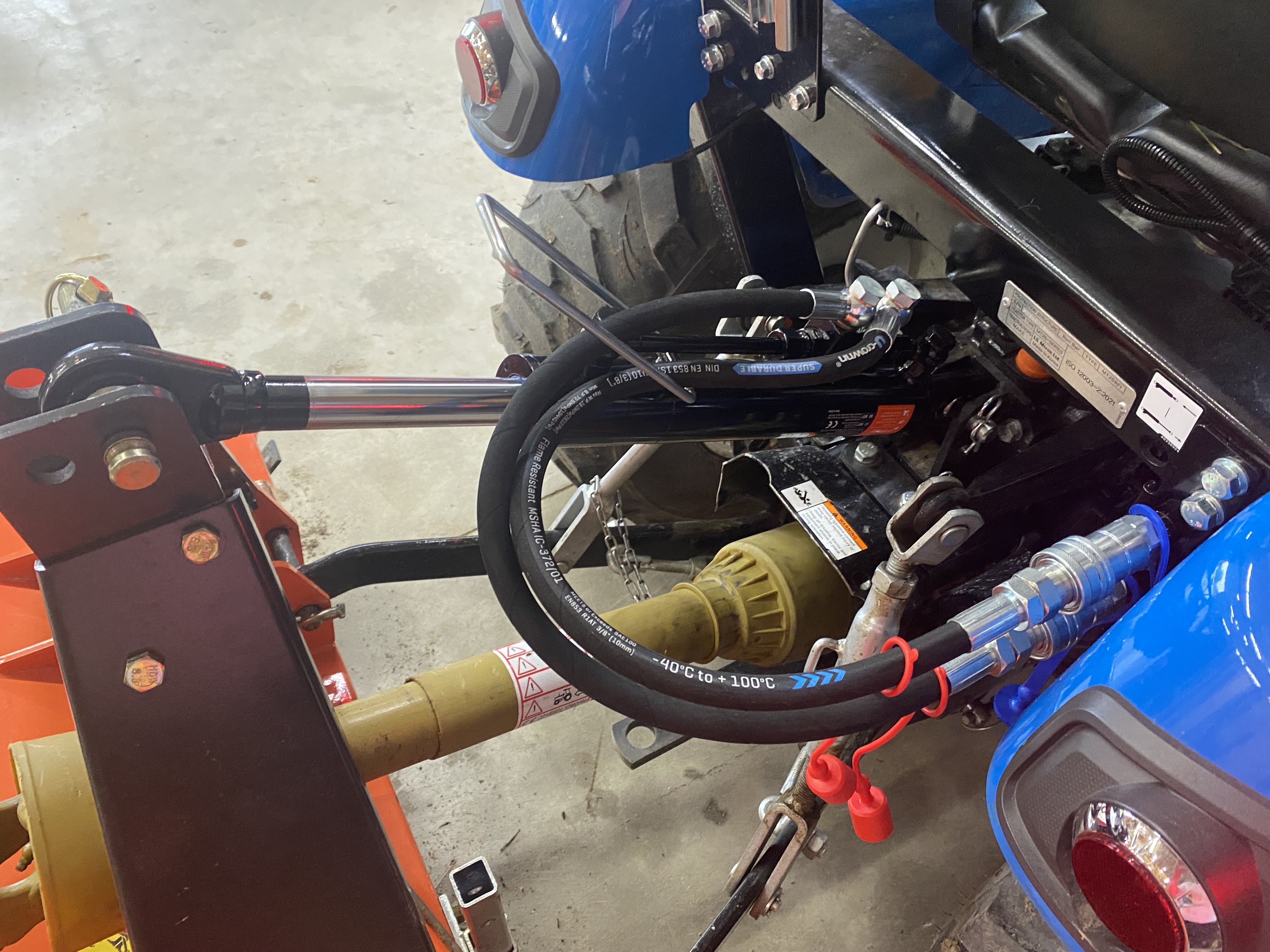

   / Vevor Hydraulic Top Link #9
Mine hasn't been worked hard yet.
Just installed it.
Haven't used it enough to know if it needs restrictors for the flow yet.
It's hooked into one of the rear remotes.
   / Vevor Hydraulic Top Link #10
No issues so far.
