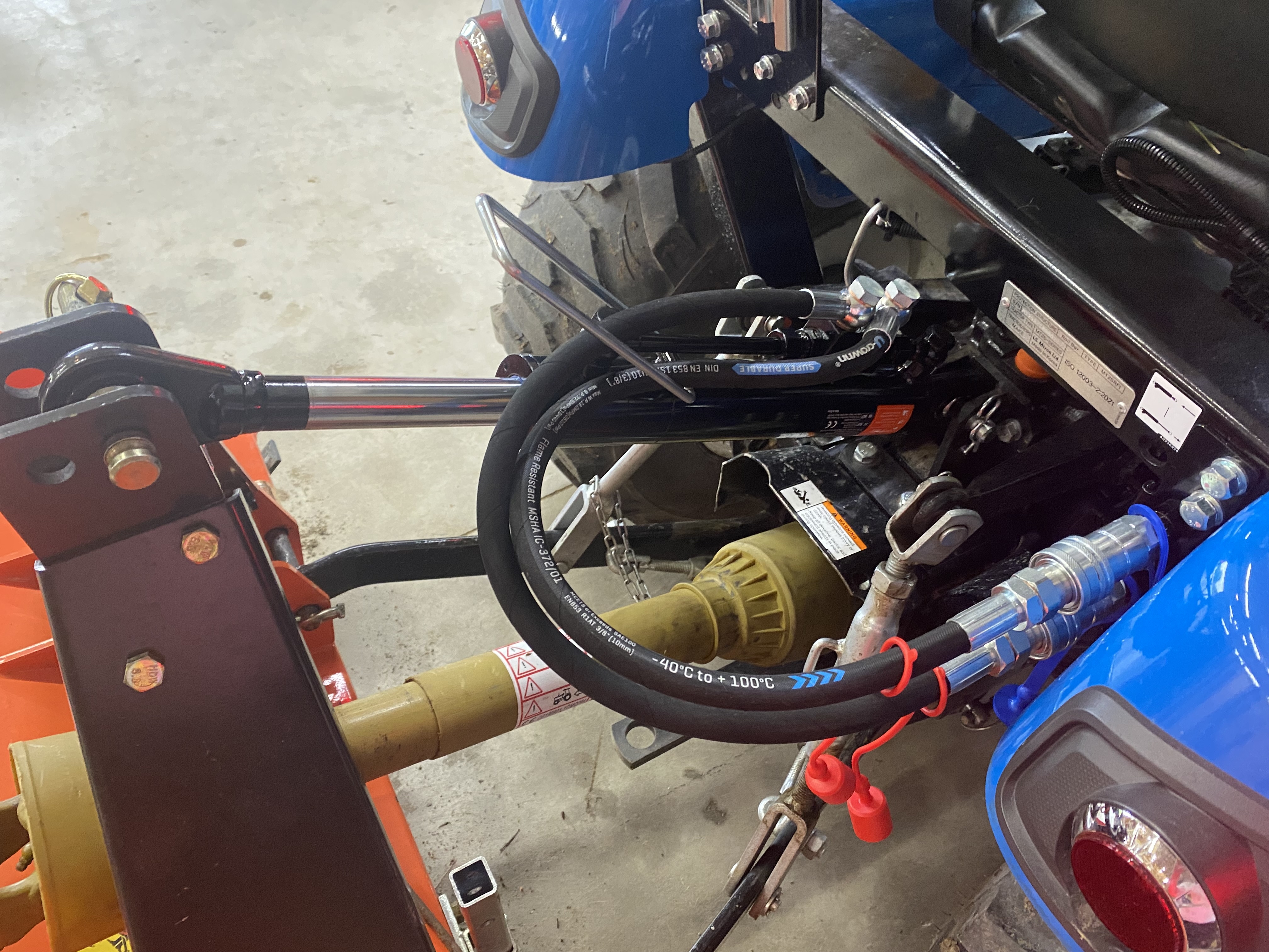

I added the VEVOR Cat 1 top link to my tractor. Works great so far.
Looks good ! I added one for my box blade .. made all the difference in the world.. highly recommend for any applications! I run it off closed center remote . Other wise pilot operated check valve is needed to hold the load ..
