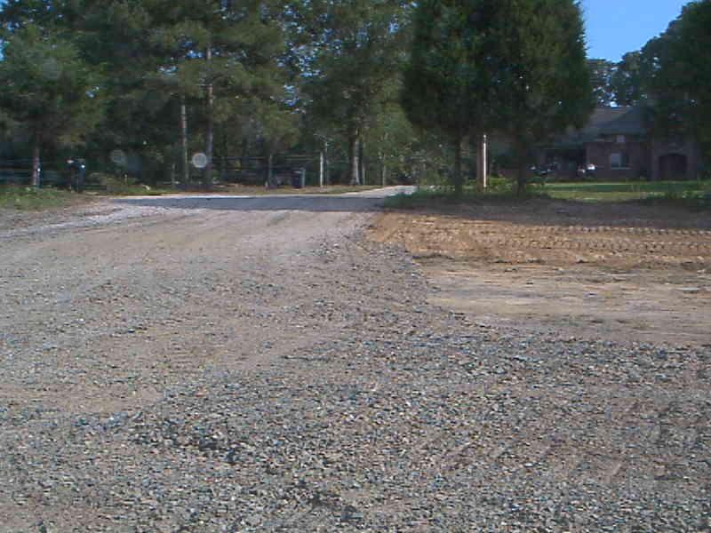

To each their own, but I wouldnt want a driveway that steep or angled so that I couldnt bring a trailer into the property. I would have to make a much wider driveway from the road. Steep without ice I guess would be ok as long as you could pull in at trailer without dragging the rear end off it. Hopefully the OP can fix those situation later. I had just a small steep section on my drive and I had it filled in with crushed stone and graded out so I wouldnt spin the wheels when going up even if stopped and restarting and it wasnt anything like the description on this thead.
This is what I consider too steep. The drive was originally same slope as the dirt but I hauled in some fill and decreased the slope as shown in the gravelled drive. It is a bit steeper than the photo appears, That is about a 5-6 foot drop in elevation over 40 feet now whereas it was about 6' drop in 20 feet distance. I wouldnt want to be going in and out of anything any steeper than that pulling a long trailer. A 12 footer would drag on mine previously to my remodeling it.
