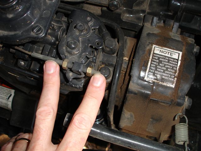

It happened! My tractor shakes so much (3 cyl Turbo) that two nuts almost fell off! I noticed my RPM at full throttle had dropped. One day, 2500 RPM with ease, next day, 2200 RPM? Was my fuel filter clogged? Thing ran fine. Smooth, no smoke, nothing wrong except RPMS were reduced with full throttle.
I started looking around and low and behold, 2 of the nuts came loose on the throttle cable! Here is a picture.
Just tightened my nuts and all are well.
Bob
   / Vibration shakes my 2 nuts loose #2
You may want to add a second nut to each nut to lock them it place. Or use some blue loctite. Or maybe some nylocs. Keep 'em from coming loose.
   / Vibration shakes my 2 nuts loose #3
I agree, looks like you already lost one.
   / Vibration shakes my 2 nuts loose #4
A little silicone on the threads will keep the nuts where they belong and is also easy to take back off.
