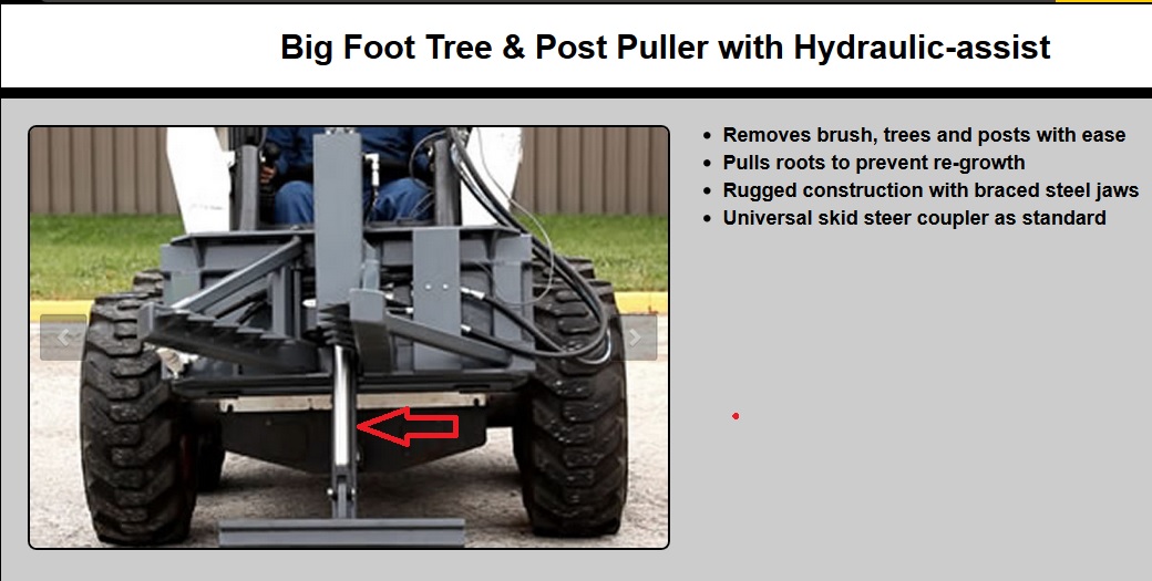

I'm covered up in bush honeysuckle, especially along the creeks, roads, and edges of fields. It dominates the understory and doesn't let new trees grow through it. I've sprayed, cut, pulled by hand, even bought a Fransgard V5000 logging winch to pull them out. But everything is a lot of work. Some of them are big enough it is a hard pull with the logging winch or they just break off. Some clumps of 5 or 6 2" stems from a common root wad that are 20' high. Plus there's all that walking back and forth and crawling under in the briars to hook chokers.
So I've been daydreaming at work about some kind of hydraulic grabber, like a tree puller, to mount on the loader. Since most are along roads and fields, I'm hoping I could just reach in, grab it and lift/curl it out. I could rock and and forth but would likely get a facefull of tops. I know all of the bigger ones won't come out with the loader lift alone. So I considered a diverter on the 3rd function to put a cylinder on it to push against the ground for 15 or 20 tons of lift (similiar to a log splitter), one function of the 3rd function to clamp, one to push up.
Today I started wondering if instead of augmenting my miniscule lift, maybe 1500# at waist high after the weight of the device, it would be easier if I put a vibrator, like a truck bed or bin vibrator or better like a vibratory post driver/puller vibrator. If I could get a vibrator to vibrate the tree I'm guessing it'd be a huge help. If...
So a couple of questions, I have mid- and rear PTOs so I could rig a generator or additional pump to run a vibrator but I don't know what kind, air, electric, or hydraulic. Are there vibrators that just vibrate up and down instead of around a plane like the truck bed type? I'm guessing that a vibrator vibrating a honeysuckle parallel to the ground would be of little help, I think I need it vibrating up and down the trunk to do much good. Also, best way to mount it so it doesn't unduly vibrate the device/loader but instead puts much of its energy into the honeysuckle. And finally, do I vibrate where I grip it, and hopefully grip it low, or do I vibrate against the stump or root wad regardless of where I grip it?

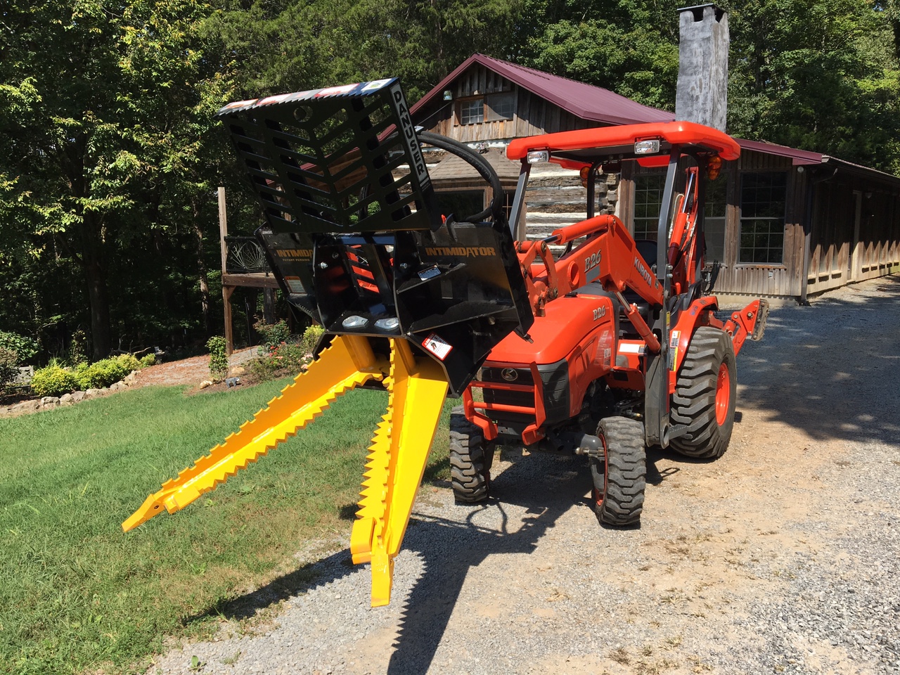

What I have is Russian olive. The Danuser Intimdator grapple works great. I can pull roots without breaking off the tops. Works great for multiflora rose and hedge privet too. Uses not just the loader lifting power but the tractor force driving forward or back. Excavator teeth up front for bigger stuff. Handy for a small Kubota b26 but can handle big trees with the m59. Use other root grapples, piranha bar, and bush hog too and have their advantages. The Intimdator can work close to buildings, fences, under fences, over fences, road banks, next to trees with minimal soil disturbance. Sure has helped cleanup and maintained our property. Work force multiplier for an older farmer.

Thanks guys, building another storage barn now so will have to wait for spring but I like the looks of that Intimidator. I have a lot of honeysuckle growing in with trees I don't want to damage, it looks like it might get in and pick off ones and twos without touching other trees.
