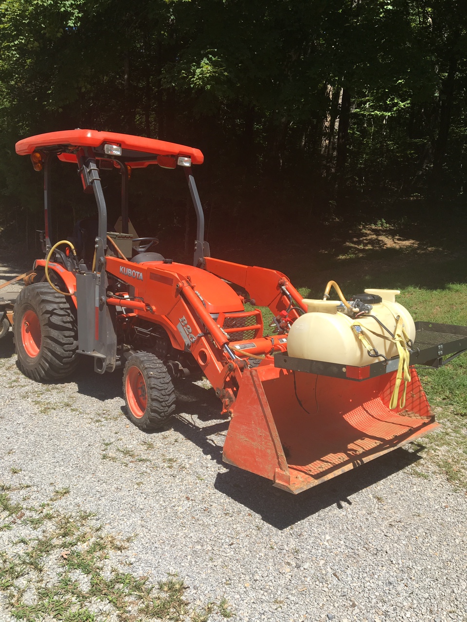

The piranha bar sure is a cost effective way to clear brush. Faster than a grapple. Right weather pulls out all the roots with minimum ground disturbance. Not as good at carrying debris. Then spray. 2-4-D is good as it kills broadleaf but not grass.
Receiver hitch carrier secures the tank. Tried using bucket with blocks or tire but could never really secure the tank enough with straps. Two wire QD for 12V power. Hose and wand to seat. Now feel safer spraying road side ditch/fence line than using 4-wheeler in traffic.
