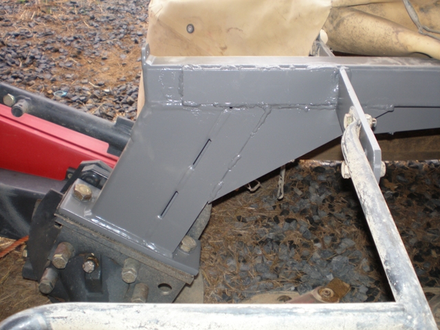

I went yesterday to pick up the replacement part. It is made just like the old part! :confused: I looked at the new Vicon mowers that they had on the lot and they have added more bracing. I assume the new Vicon mower's parts are not backward compatible or they have plenty of old parts that they need to get rid of.:) On the way home, I dropped off the replacement part at the welding shop to get some additional bracing added.

Here is the new and improved part. Not the best looking modification but hopefully it will do the job!:)

The vicon DMP series is alot more HD. The break looks like it is at a point where people pick the mower up and causes alot of stress there. As far as picking the mower up when i cut I usely just leave it down till im done mowing.:thumbsup:

Dad Gum It ... see if you can break that one!!!
