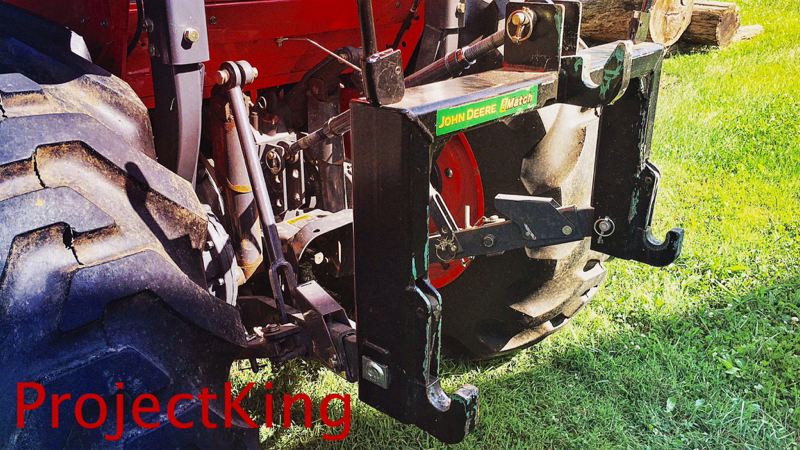

Hello, Just uploaded a new video about quick hitches. I give basic info about my I-Match hitch connected to a Kubota L3830.
Let me know if you have any questions.

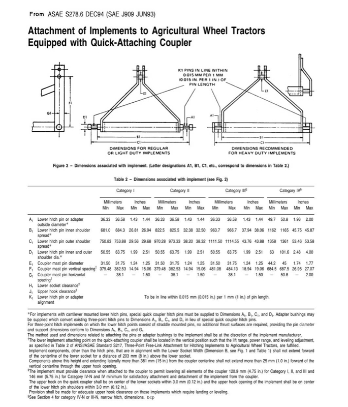

I liked your video. Just got a 5' KKII tiller and haven't even used it yet. I was wondering if it would fit my I-Match, which is the old fixed top link model like yours.
   / Video about 3 Point Quick Hitch
Thank you for the kind words! Here's the quick hitch standards.
You can use the below measurements to check your equipment. They should be correct.
If your tiller is new it should work. Mine is also a King Kutter Tiller 6' and it fits perfect with no mods needed.
