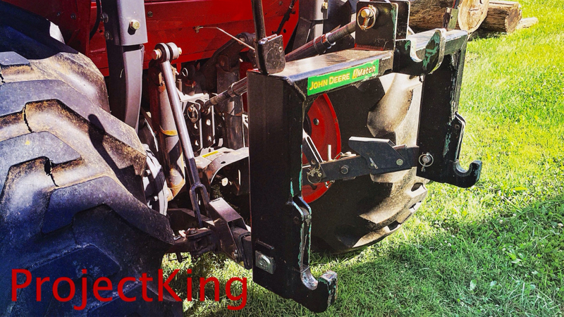

Great video! I have a quick hitch from Tractor Supply since 2004. Tried the Pat's quick change things for about a year, switched back.
It was better to modify the attachments- just did the York Rake last week. It was the "reason" for the year of change, LOL.
I've found that by extending the top link to "grab" the top pin, I can draw some attachments into place, lining up the lower pins.
Many times I can reach over the back from the seat and flick the top latching handles closed. If the implement doesn't have a drive shaft, I don't have to get off the tractor
My handles are a bit longer than the ones in your video.
Your tractor looks just like my Mahindra 3510, except you must keep it indoors
