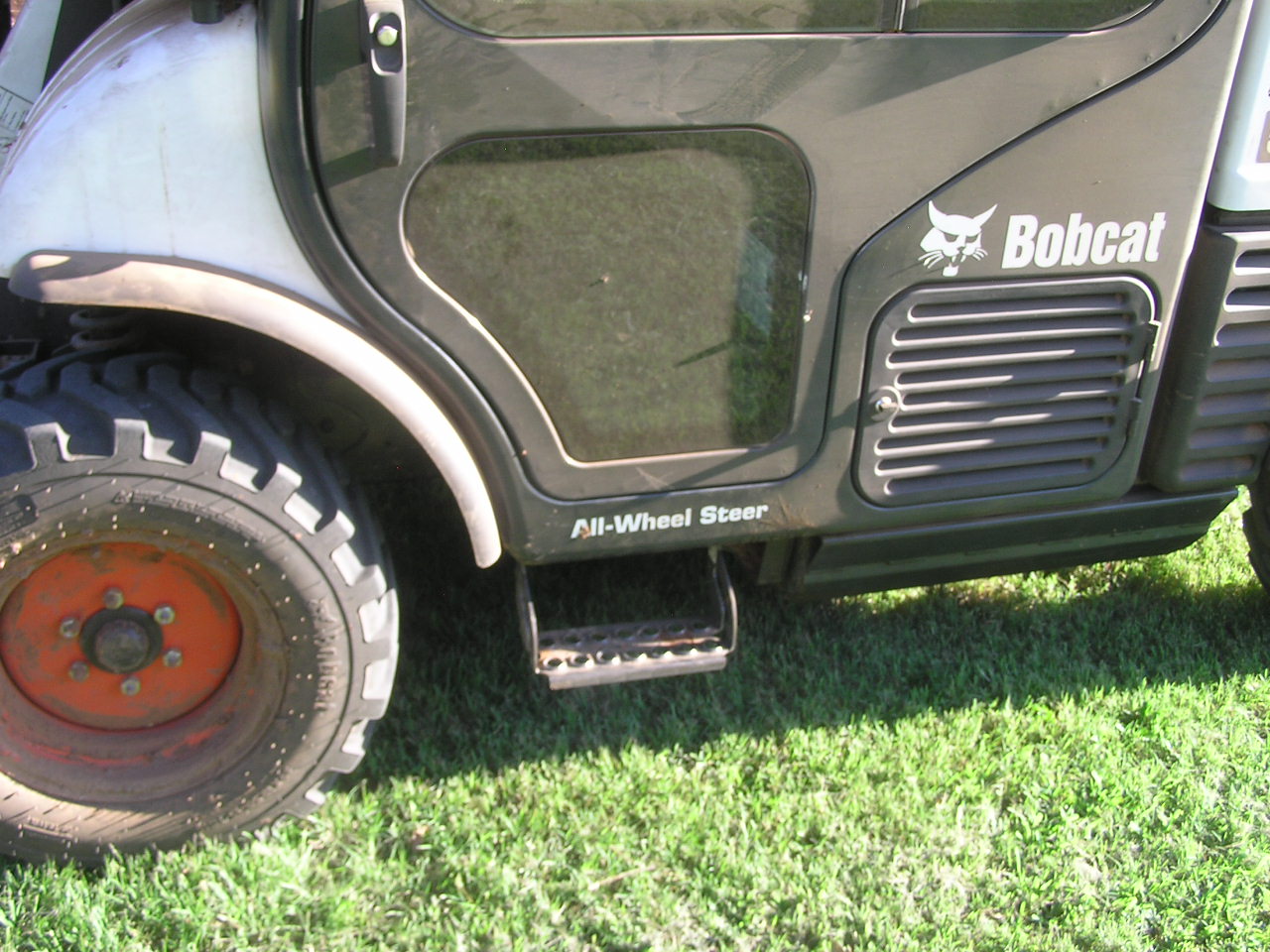

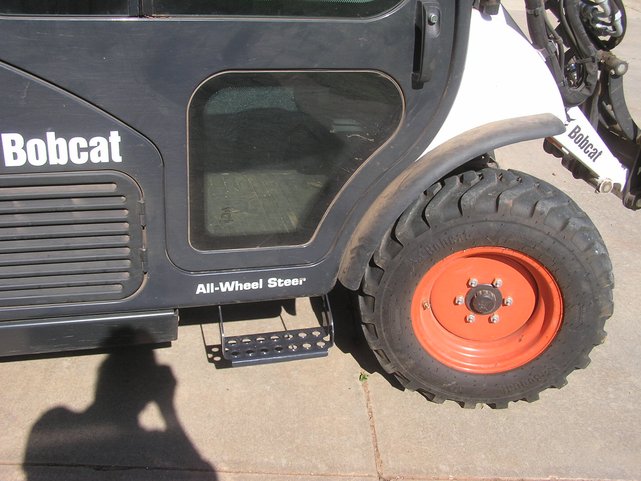

Yep easily step in/out, especially with the added step kit blue TU.gif: https://www.tractorbynet.com/forums/toolcat/133531-trivial-question-about-step-kit.html

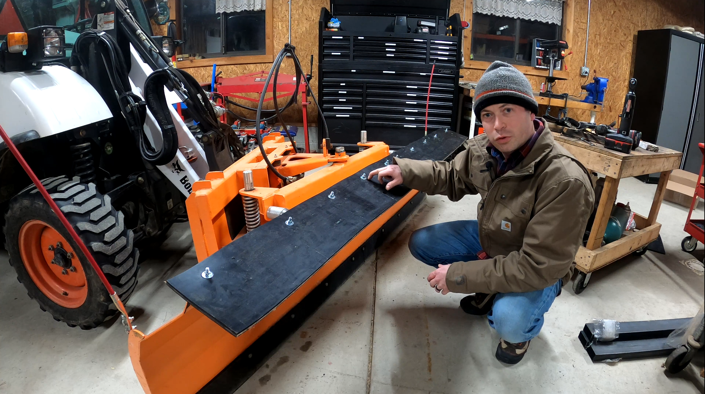

Ok Hay Dude, you pushed me over the top (pun) to put a snow foil/deflector on the plow. Took about 30 mins and $85 for rubber and hardware.
Its one of those must haves for me. Keeps my hands on the wheel and off the wiper switch. More importantly, it keeps that little bit of snow from dribbling over the edge and having to make another pass to clean it up. Also can serve as an early warning device when you get up close to back grab a garage door.
I dont plow without them on both my plows.
If I could make 3 very minor suggestions to an otherwise EXCELLENT video:
1. After drilling holes in the rolled top edge of the plow, I would hit them with some matching spray paint.
2. I would buy stainless bolts, or paint the bolts with matching spray paint and let them dry overnight.
3. I would face the bolts in the other direction with threads facing down for more protection and less chance of snagging pants or shirts, branches, etc. on the upward protruding bolts.
All in all an excellent video, but you forgot to give me credit for the idea :laughing:
Great job Nate :thumbsup:

The top of the plow was already drilled and painted. I did just get regular zinc bolts but my attachments stay out of the weather (and I don't salt) so rust isn't a big concern, although I nearly paid SS prices for buying the hardware individually at ACE...lol. Bolts were probably 5mm too long (want room to put a top sandwich plate if needed in the future) and that made them hit the plow blade if I pointed them down so up they are!
