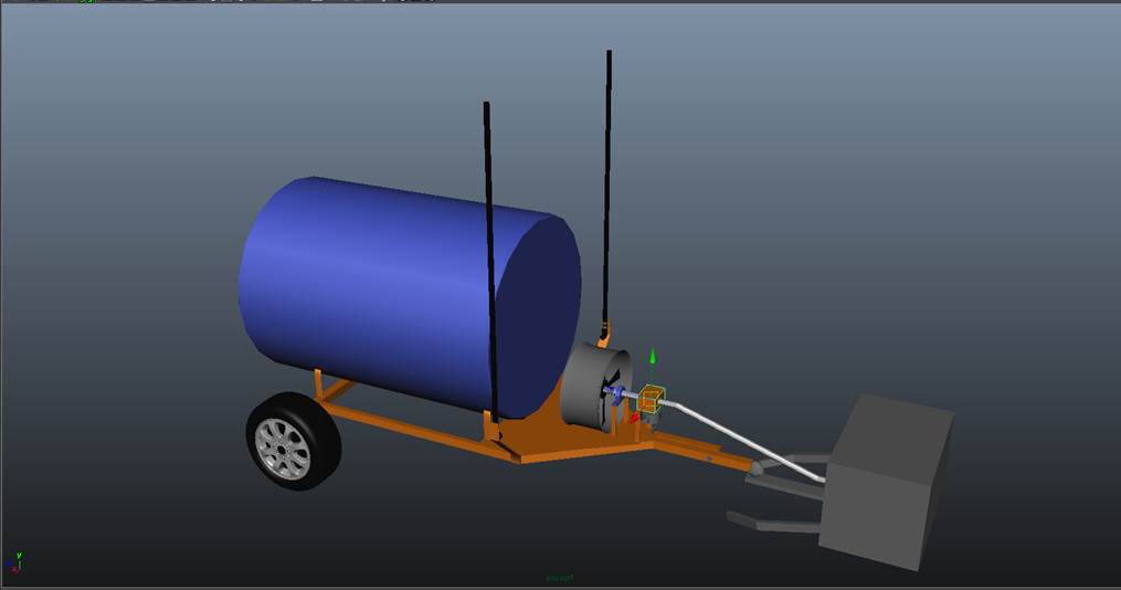

So i'm taking some time this summer to build myself a foliar sprayer for my 4 acre vineyard. I have a couple of ideas and wanted to get your guys take on it. The sprayer builds I have seen on here are not really what I'm looking for but have provided some good inspiration. My basic concept is to make it a tow behind using a 50 Gal plastic drum, and separately have an assembly connected to the three point that is essentially a tower with the nozzles on it. My thought to do it this way is so that I can have a good capacity without worrying about tractor stability. I have a kubota b3220 so it's a med size tractor and I have some areas that are steep vertically and have a bit of a side slope, nothing to worry about normally but i want to keep it safe. I was also planning on using a roller pto pump to keep the design simple and economical. 20 gal per min - 100 psi should be enough capacity, probably 8-10 spray nozzles. Any thoughts you guys might have would be great. I will be uploading some basic design images to better show what I'm thinking.
Cheers everyone.
I'd just buy an $850 60-gal 3-point hitch Fimco sprayer from Tractor Supply and modify the spray bar to position the nozzles appropriately for your vineyard trellis layout. No reason to reinvent the wheel. I just sold my 6-year old unit for $500 (sold the farm and moving to the city).

Don't go with Fimco. They are a bad design. If you look at the bottom of the tanks you'll see that they have molded pockets and such that make them really, really hard to clean because the pesticides get trapped in those pockets. Some of the Fimco models have no drain...you have to remove the return line to drain the tank. Most also don't have agitation.
I'd highly recommend looking for a sprayer with a round or flat bottom with no pockets other than a single sump area where the liquid is picked up.

Alright I did up a quick sketch for where I'm headed. No plumbing included. Basically it's a trailer styler, with the PTO driving a three way gear to power the fan and the roller pump. The fan would be shaft driven with a pillow block offset from the gearbox for wobble support. I did not include the air venting in there yet. Was thinking 50 gal plastic drum for the container. Pics attached.
This would be all build no buy basically besides the pump and the gearbox.
