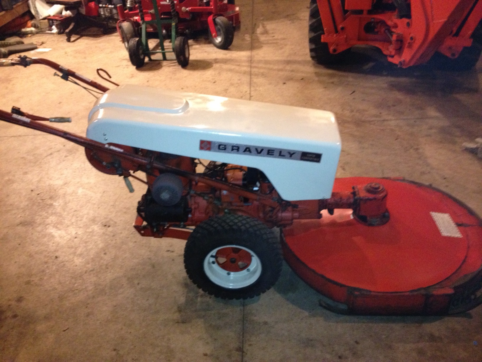

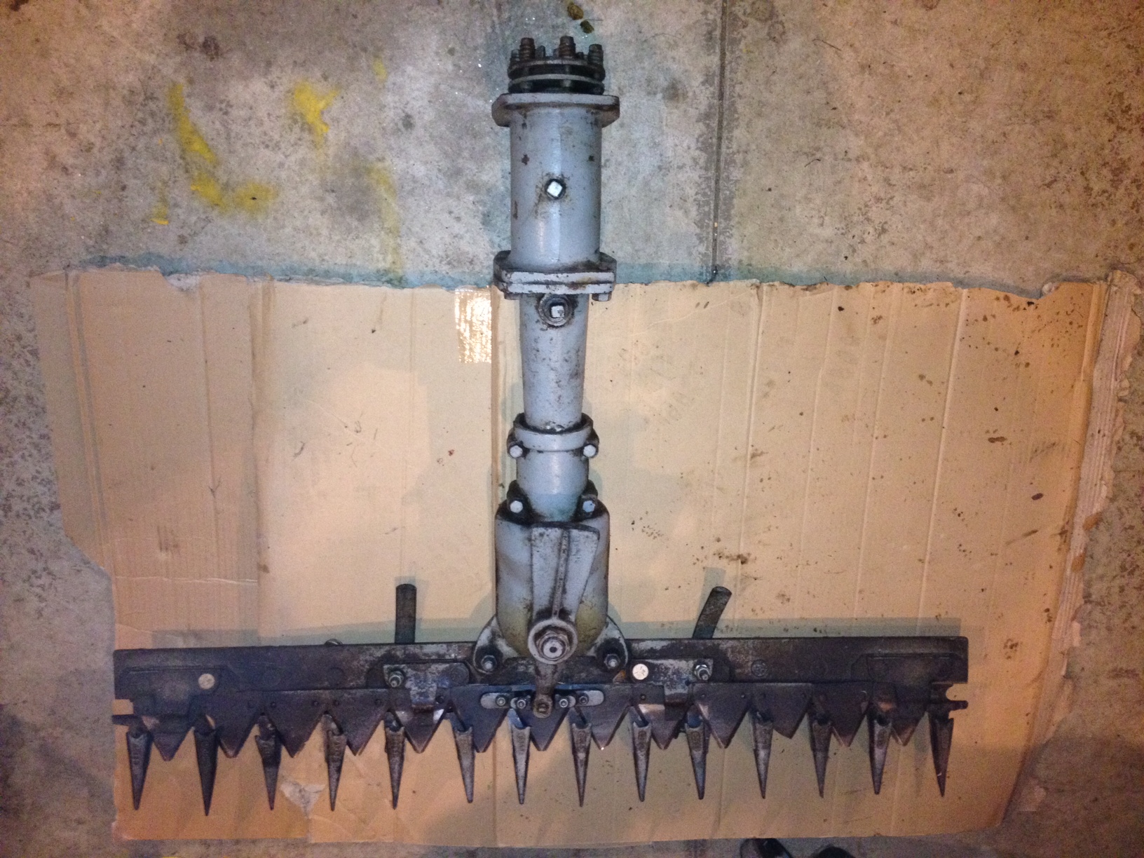

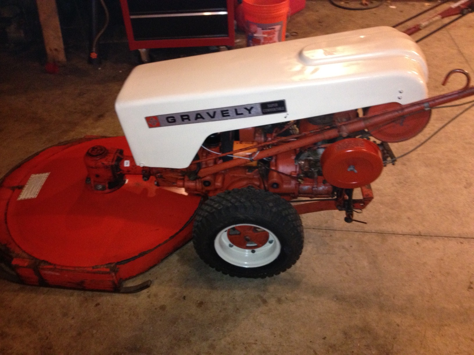

Hi Richard.
I aquired a L8 Super a week ago from a friend - had it since 1979 - took good care of it and I got a box of parts coils, points, plugs seals too. It runs fine - except stumbles a bit when cold - needs to have the choke out for a bit until it warms up.
The engine rings and valves were done in 2002 and very few hrs on it since then. The questions I have are around the timing and misaligned flywheels / stop switch. How does one go about diagnosing this condition as mine has the PB stop and it works.
Any other tips/tricks etc on this unit? Here are some pics of mine, and I did touch up the hood, added a support cable to hold the hood. Got the wheel extenders too.
Thanks in advance for your replies.
