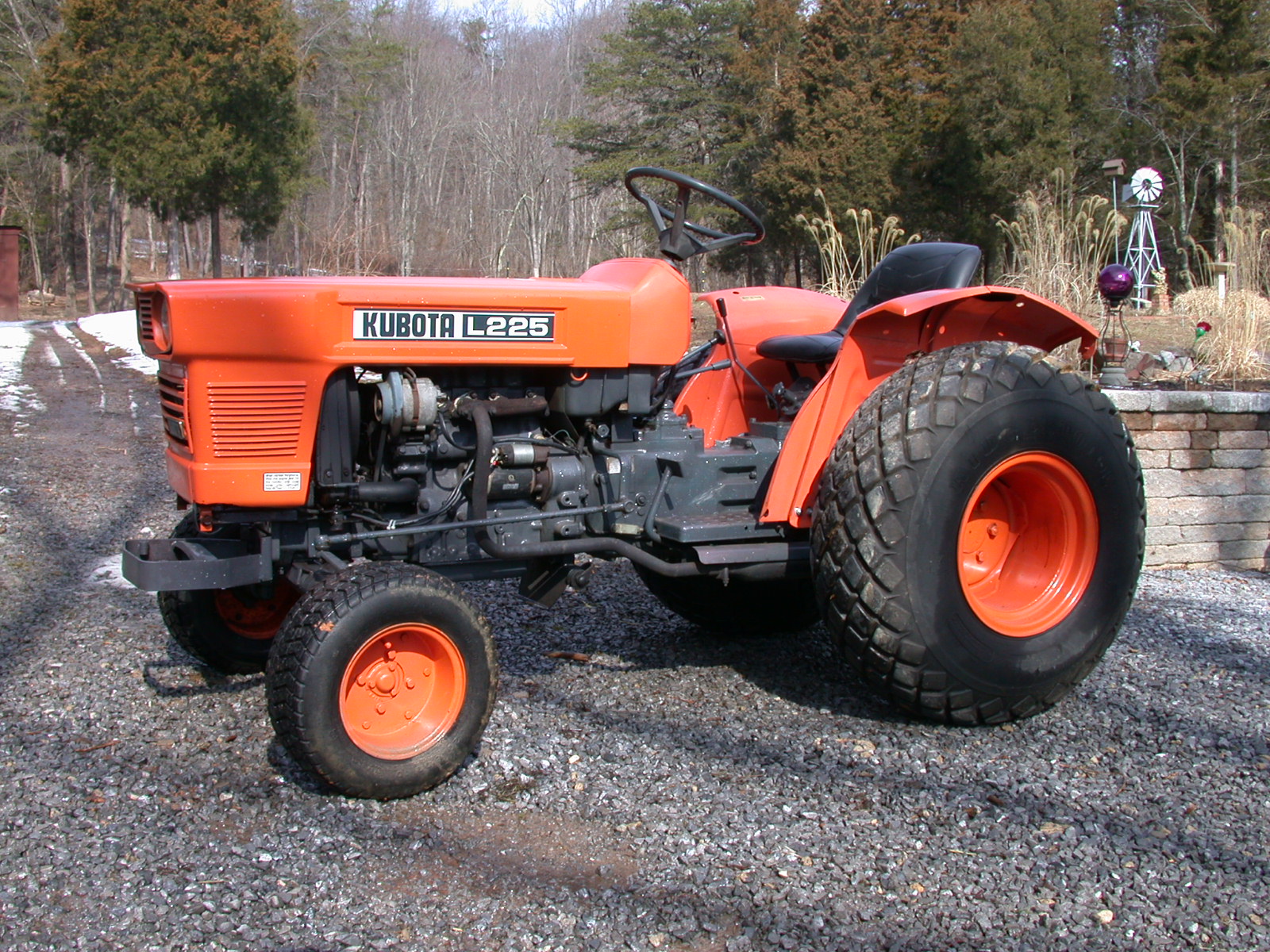

I scored a L225 in excellent condition three years ago with 198 hours showing on the hourmeter. Guessing from the condition of the tractor the hours could be original and was imported around 1975. It had been repainted and the turf tires filled with some gook that was like syrup. Three years later it is still doing duty pulling a 5' finish mower very well. Almost like it better than my L3130...

That is one sweet looking tractor, Dangier. Bet that is a lot of fun to operate. They don't need bells and whistles to be useful, just mechanical integrity....and Kubotas come with plenty of that.
Bob
