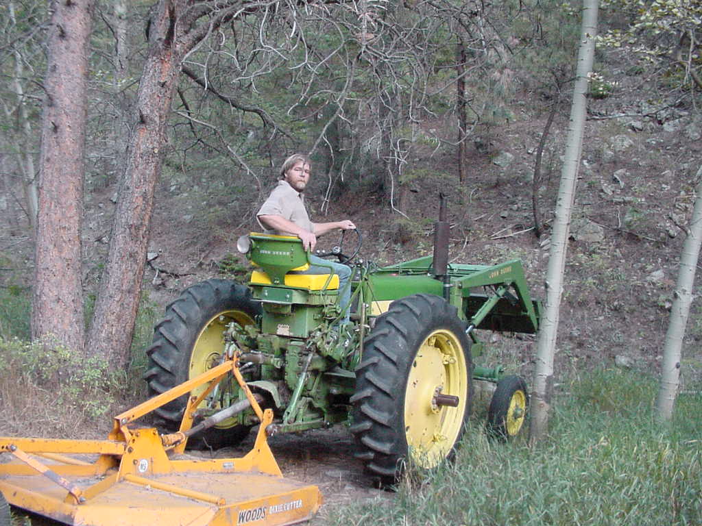

I did what I am advising. We had a small budget so I bought an older JD530 ag tractor (30hp). It had a cat II 3pt, power steering, and aux hydraulics. Price was $2000. The farmer that had it was using it as a stationary engine with the PTO driving a water pump to irrigate corn... It had a zillion hours on it, but parts for older JDs are very reasonable and available. We added a wide front from a tractor junkyard ($1000) which bolted right up in a single afternoon. Then the next year found an old loader for that very tractor. Cost was about $2500 for that.
We've used it for just about everything for 20 years. It never broke down. Still have it. It runs & works fine.
