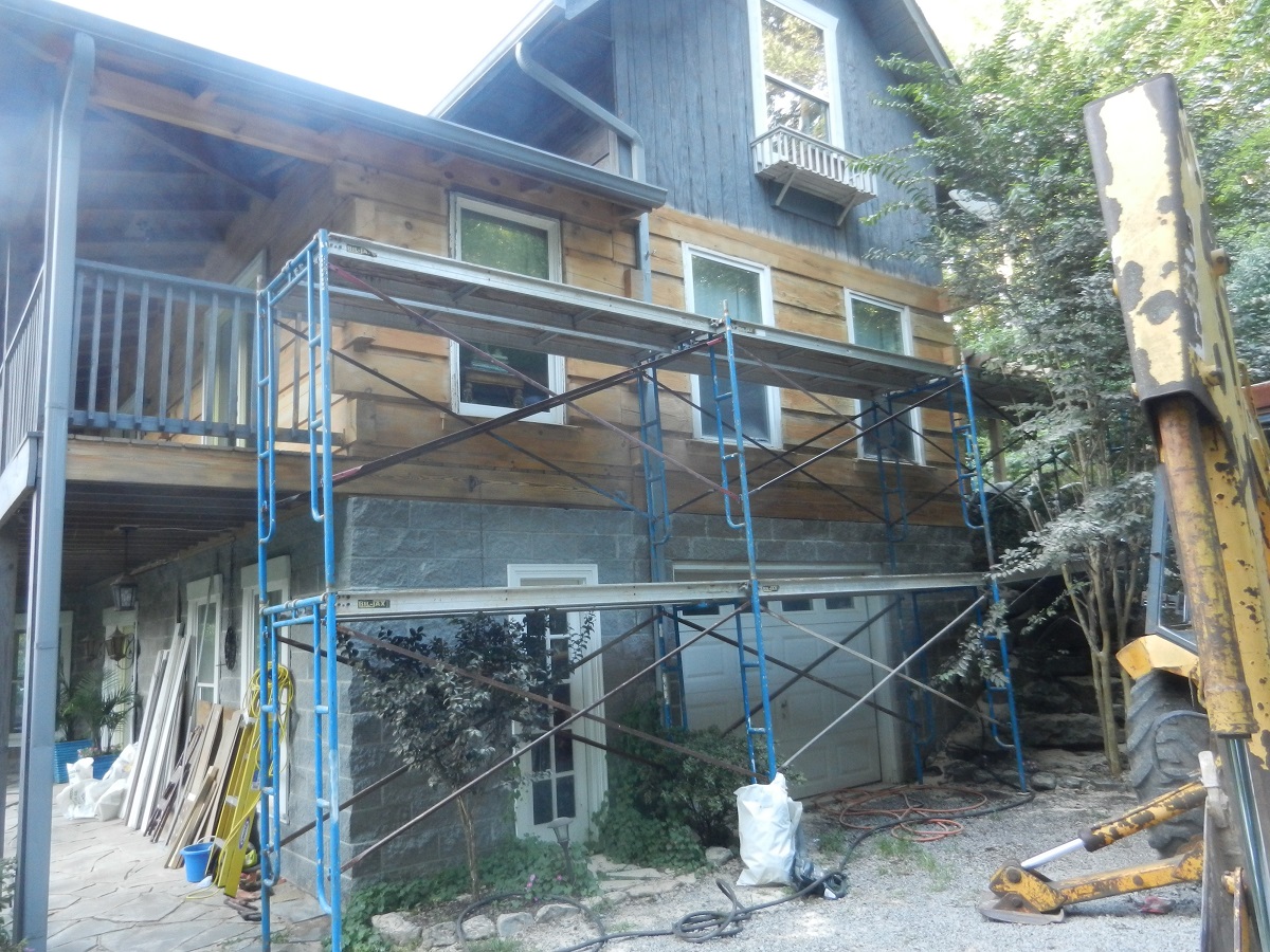

In this pic you can see the 3 different vinyls we used. Is still like the look of natural shakes and clapboard but as I get older I am trying to make the days of 20 gallons of Sikkens a thing of the past.

Just got off the bucket lift doing some preliminary measurements. Looks like we're going to need six 4x8 sheets. We'll have loss for the window (46x72 external dimensions) and then of course, as the gable end narrows to the roof, we'll lose that material.
Wife is asking about yanking off a 1x6 we have on both vertical sides and replacing it with a 2x board thinking that the taller board will be usable as an end cap and give me/us (me! HA) something to use as a starter edge.
Right now, the T1-11 butts up pretty evenly with the 1x6 so a 2x6 might give a better edge and keep it all wood.
This picture is about 12 years old (camera battery dead) The planter under window is now gone, removed other day. The downspout is re-routed a bit so today, virtually nothing is on the end of the house.
Notice I pulled in a cameo shot of my backhoe to try to keep this forum related.
Any thoughts on the edging with 2x6? (on the vertical sides)
