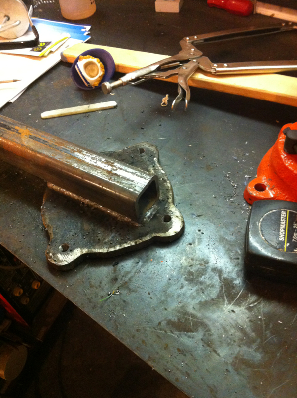

Finally got working on the receiver base for the vise; a few pictures...

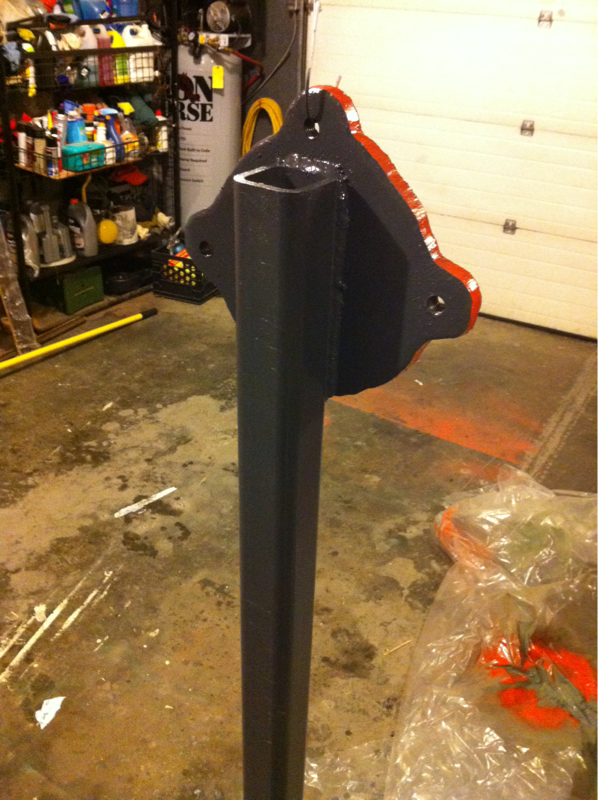

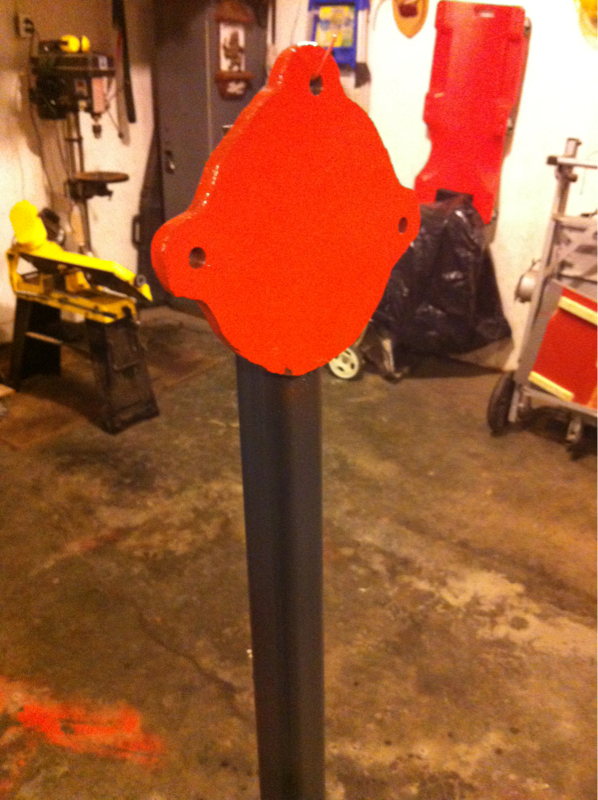

Paint
Kubota orange and grey

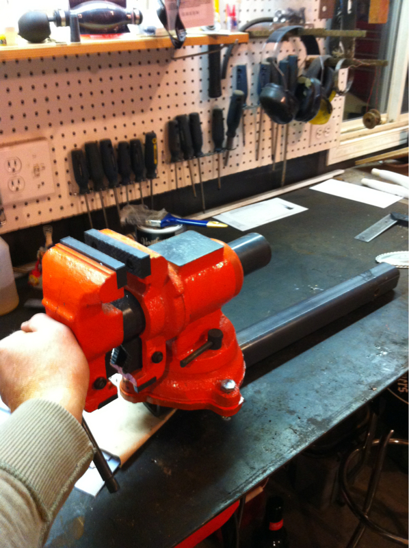

Finally attached the vise to the receiver tube base.
Blue locktite on the bolt threads screwed into the threaded 1/2" plate and nylon lock nuts on the back side.
Should hold!

"Should hold" is right. That's not going anywhere.
Great project.
