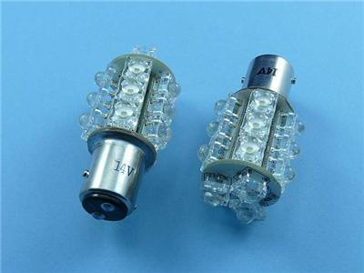

One thing that you might consider if you need to use the headlights and maybe other work lights a lot is changing to a lower wattage bulb. With the new LED lights you can get the equivalent of a 60 watt bulb that will draw 1.5 watts of power. I did this with my YM 1510D and others have too. Search on "LED" in the "Customization" forum. Another plus is that the LED bulbs have a life of 20,000 hours--even if you cut that in half for vibration and such that still is a LOT of tractor time. :D The LED's now come in many different bases and styles.

Checked out your lights on the 1510D. It looks like an easy fix for lower wattage of lights. Where did you find the LED's at?
Justin
   / Voltage Problems..... #20

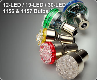

I just got them from a "Home Depot" type store. They are a 12v LED for a spot light. MR 16 and MR 11 were the numbers, but there are other designs that would work as well or even better. Here are a coupld of sites that carry them in the States. I just "Googled" "12 volt LED lights." Super Bright LED and Low voltage LED lights.
I used the MR 11's but if I were going to do it again I would use the 1157 replacement bulbs and a stop light socket--then you would have high and low beams (Well bright and very bright). Super bright has many different styles of bulbs that fit the 1157 socket. Their spider style is most interesting--but their are many that would work well.
The problem of LED's is their general narrow beam of light--straight ahead. Therefore, choose a bulb that has a wide light beam--They mention this in degrees 18 degree, 90 degree, 120 degrees, and 130 degrees.
Mike
